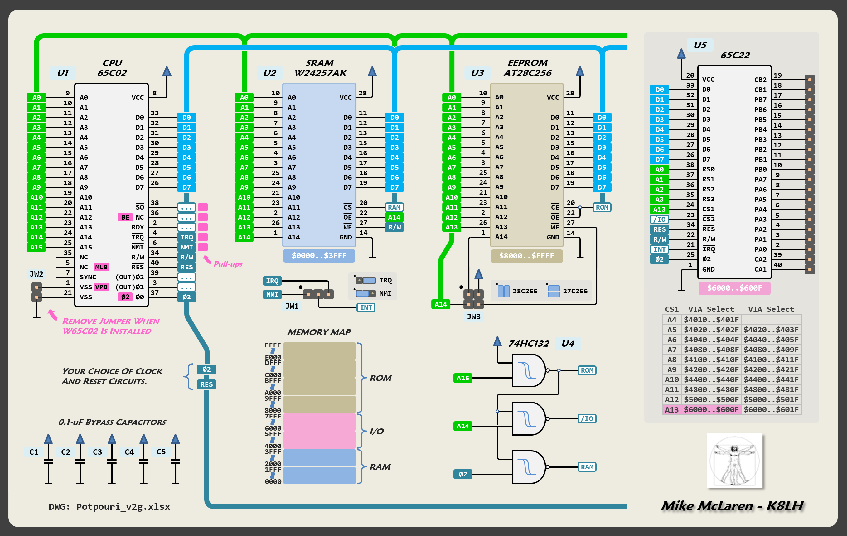

Would there be any advantage driving the VIA active-high chip select inputs directly with the A12 and A13 lines, besides eliminating some gates and propagation delay in the decoding circuitry? VIA-1 would be addressed at $5000..$500F while VIA-2 would be addressed at $6000..$600F.

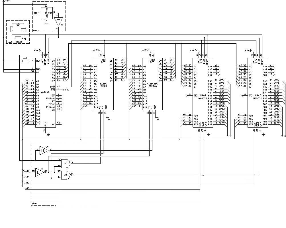

The current glue I use consumes these addresses:
0000-3FFF : SRAM
6000-6FFF : VIA-1
7000-7FFF : VIA-2
8000-FFFF : EEPROM
It leaves a contiguous 4000-5FFF available for me for something else (not sure what yet). At some point I plan to replace the current glue with something "tighter", probably when I want to maximize RAM (like decrease ROM that then only loads programs from storage into RAM).
Hope that makes sense.
-Niek.
Michael
Posts: 633
Joined: 13 Feb 2013
Re: Issues with 6502?
Post by Michael »
Makes perfect sense.

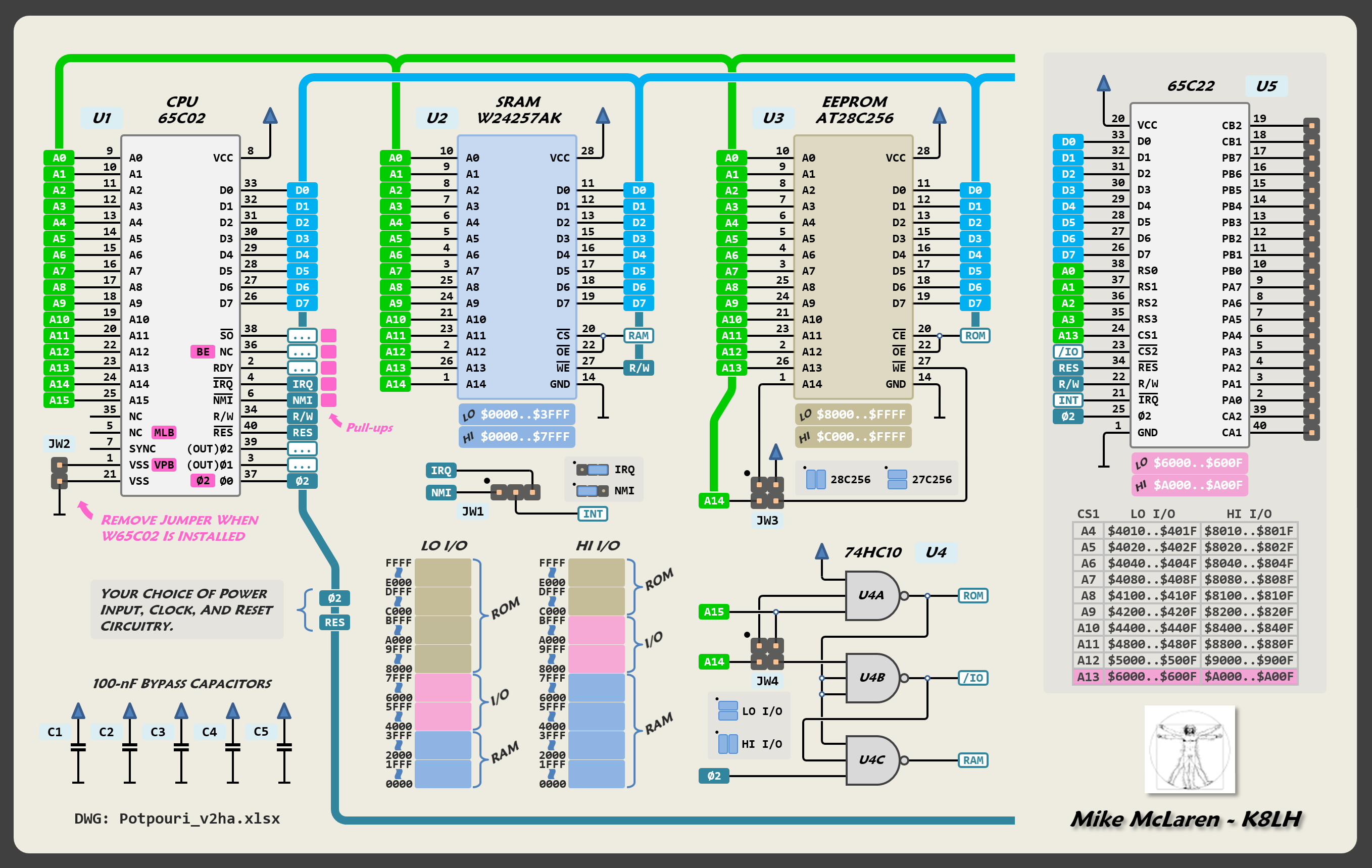

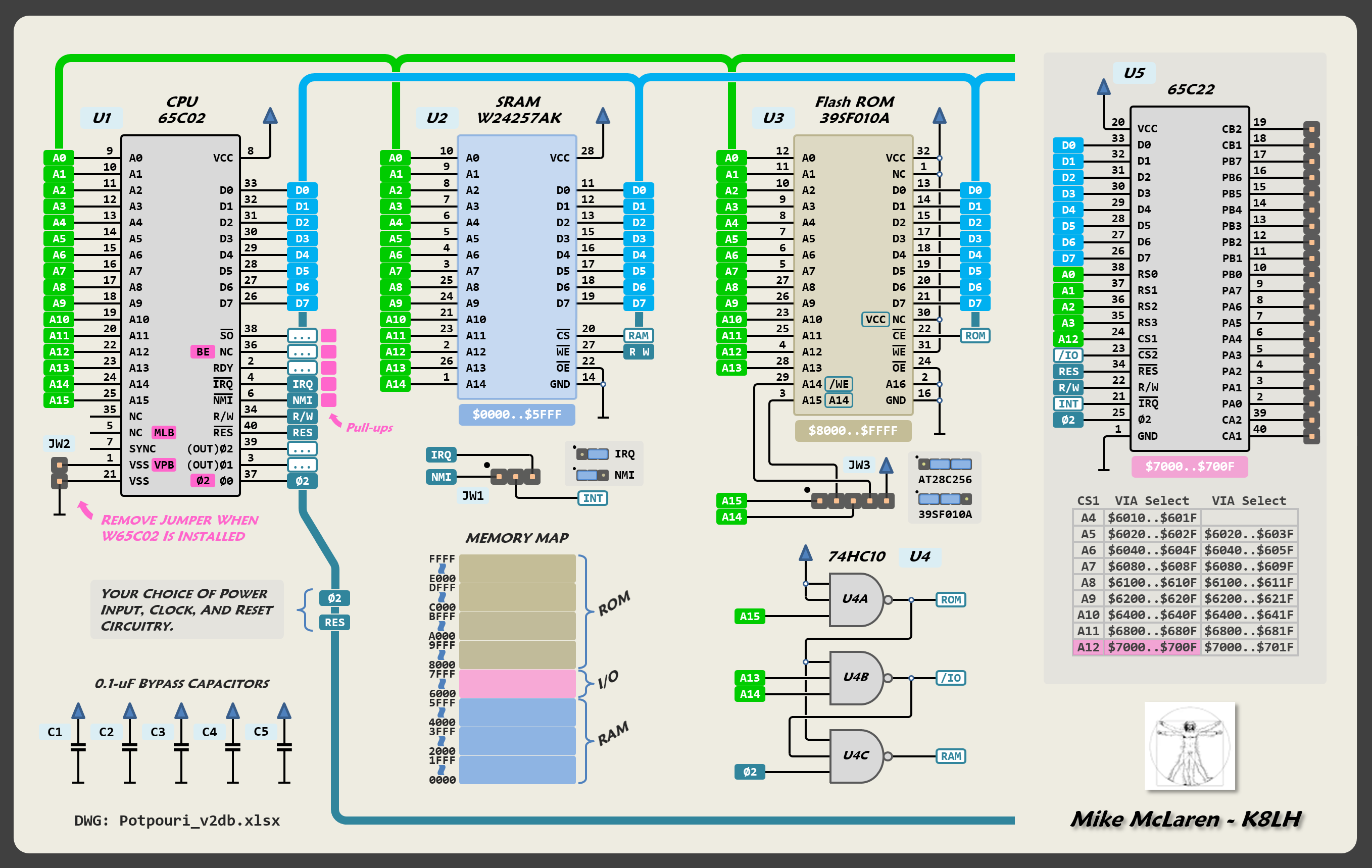

I just think it's kinda' neat that you can 'slot' a bunch of 6500 series peripherals into I/O space without additional address decoder logic. In my rendering of the "very basic whole-computer" diagram from the Potpourri chapter of "The Primer" I included a table of I/O slots available for 6500 series peripheral chips within the minimally decoded I/O block.
Have fun. Cheerful regards.
