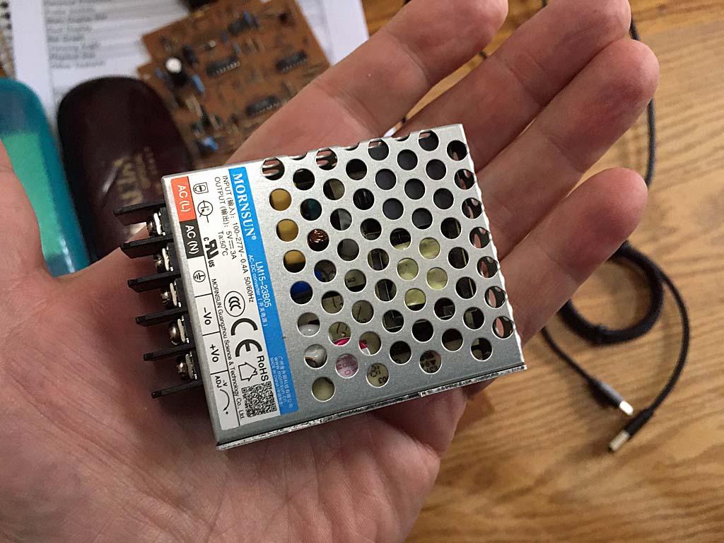

I too am of the opinions that a) the ATX is way overkill and B) SMPS wallwarts are generally trash.
I've taken to use these little Mornsun LM15-23B05 SMPS unit. 5V @ 3A. Sufficient for a very large SBC.
They beat their very good specifications quite handily. About $5 from DigiKey. You would spend more than that on the parts for that schematic you posted.

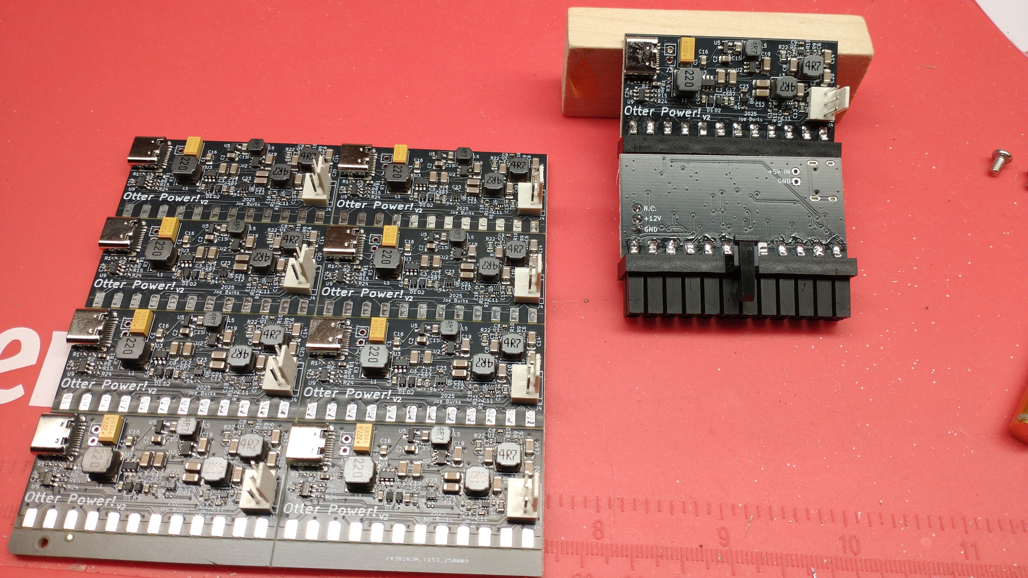

I had a need for a low wattage (~5W) ATX-style PSU that could be powered from USB, so I designed my own. All the problems mentioned here - especially low quality "5V" from USB chargers - had to be dealt with and compensated for. In the end, I made something that produces +5VSB, +5V, +12V, -12V, and +3.3V power rails, a 12V fan header, draws less than 5mW when completely unloaded (the limit of the equipment I had on hand to measure was 5mW), and it tolerates pretty severe dips caused by USB chargers that are slow to recover from current increases. It's great when at a show and a USB phone charger battery bank is the most reliable option for power.
Otter Power! 5W ATX PSU
Sadly, the cost is close to a modern ATX Pico PSU and considerably more than an LM15-23805. So far it has only seen life with OtterX, Commander X16, and Foenix F256 computers; I'm not aware of any other neo-retro computers with a 24-pin ATX receptacle.

To expand on what several have mentioned re: wall warts, local regulation, and buck/boost - that is what I did with my PSU. Initially I had "+5VSB" the same as "VBUS" (USB power) and that was a *very* bad idea. For one, VBUS would droop to around 2V during the power-on inrush current on cheap USB chargers; for another, VBUS was frequently well above 5 volts when unloaded or lightly loaded, especially on good USB chargers.
One solution to this is a USB PD trigger IC that would negotiate a higher voltage that could then be bucked down to supply the various rails. I decided against this because USB chargers that can negotiate 12-20V to the device are expensive and not that common.
The solution I went with on was multiple switchers in boost/buck configurations and a sequencer circuit for energizing the rails one at a time to reduce the peak inrush current during power on. The PSU maintains all five rails even when VBUS misbehaves and fluctuates between 2V and 6V (as long as it never spends too much time at 2V on wires that cannot handle that much current).
There are about 100 of them out there now, and other than audible coil whine and a "warmer than one would like" 3.3V rail on the first version, there have been no complaints. Both of those issues appear to be fixed on the current version.
