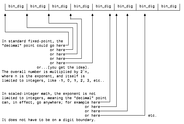

I had kind of forgotten about this thread.  I started it 20 years ago, and when I read the first post, I was thinking, "Wow, my writing has sure improved since then."  I re-read the whole thread though, and feel my other posts are somewhat better.
The introduction of the stack was meant to lay some groundwork for subsequent sections, sections which never came, because I did the article on my website, along with the other pages in that section of the website.  I also have the large section of the website regarding stacks.  This 6502 stacks treatise does, admittedly, mention Forth several times; but the example code is assembly language because the treatise is not particularly about Forth; it's just that so many operations have already been figured out long ago in Forth, and it works well to do these in a Forth-like way even though we're not using Forth (and thus won't have the benefits of incremental native compilation, extending the compiler, vocabularies, having words whose compile-time behavior is different from their runtime behavior, etc.).  Plenty of other HLLs use a stack like this too; but Forth gives the programmer direct access to it, rather than hiding it.  MULDIV, mentioned by others above, is basically the same as Forth's */ .
I spent a lot of time on this reply, and I'm still not totally happy with it; but hopefully it will be helpful.
The big difference I see between fixed-point and floating-point handling is that fixed-point leaves the point's location up to the programmer, rather than requiring the computer to continually handle that overhead on the fly. There's a place for each.
vbc wrote:
I would say to qualify as fixed-point rather than general scaled-integer, the scaling factor has to be a power of the base used for the integers, e.g. 2^n for binary or 10^n for decimal.
Exactly.
I'll try here to illustrate what I mean about fixed-point being a limited subset of scaled-integer:
So how can you put the "decimal" point somewhere within a digit?  ("Decimal" is in quotes because we're usually dealing in binary but lack a suitable term.)  Fixed-point requires that the decimal point be on digit boundaries; so in binary, the number can only be scaled by integer powers of 2, like a quarter, half, twice, 4X, 8X, 16X etc..  In decimal, the number can only be scaled by integer powers of 10, like .01, .1, 1, 10, 100, etc..  Mathematically, exponents don't need to be integers though.
This scaling usually does require dividing or multiplying your input and output numbers by values that aren't nice round numbers that let you just shift left or right; but it can at least partly pay for itself if you have a string of calculations that can then be done with shorter words, for example 16-bit instead of 24- or 32-bit.
Putting the decimal point right in the exact center of a binary digit would make the "n" in the "times 2^n" to be .5, which is the square root of 2, that is, 1.414...  So if the n were 2.5, it would mean the true value of the number is what is shown times 4 times √2, meaning *5.65685..., and the highest number you could represent in an unsigned 16-bit cell is 11,585.1, and the resolution, and the smallest non-0 number you could represent, would be .176777.
This however is just to show that exponents don't have to be integer powers of 2.  It does not particularly require that you get into logarithms to figure out some odd mid-digit placement of the "decimal" point.  You can ignore that and just multiply input or output by whatever constant makes the available quantity of bits in a cell work best for the application.
One of the best examples I can think of for why you would want to is still degrees in a circle, for trigonometric functions.  With fixed-point and 16-bit cells, the best you can do to represent the 360° is making 1° to be 100 or 128.  If you use 100, 360° comes out 36,000 (or $8CA0), which fits ok in 65,536.  If you use 128, it might be nicer for shifting left or right, but the whole circle comes out to 46,080 (or $B400).  For one thing, you're not using the entire resolution that's available; but another thing is that overflows and underflows require detection and correction.  If you instead scale it so 1° is 182.0444 counts, or, put another way, 1 lsb is .00549316°, not only can you use the entire 16-bit resolution of a two-byte cell, but overflows and underflows still produce correct results, so for example 355°+10°=5°, without adjustment.  These things won't be true if you use 128 (2^7) as a scale factor.
Another example on the page is if you had an A/D converter measuring something that ranged from 0V up to a maximum of 7V, and you wanted the maximum resolution and maximum advantage over the differential and integral nonlinearity errors and PSRR you could get with a given number of bits of the A/D converter; so you set the gain on the op amp feeding it such that the 7V gives the A/D converter the voltage that will result in the highest number output, whether $FF (for an 8-bit converter), $3FF (for a 10-bit converter), etc..  Now 1 lsb is a step of 27.45mV for the 8-bit A/D, and 6.843mV for the 10-bit A/D.  Data converters of course aren't perfect, which is one reason you'd want to spread the input voltage across the whole range the converter can handle.  Throughout the multiple steps of processing the numbers, you may be able to leave it scaled until it's time for human output.  In many embedded-control situations, the human output won't even be necessary.  This has been the case with several microcontroller applications I've developed in my work over the years.

As I put the finishing touches on my integer math library V2, I’ve been laying some groundwork for a fixed-point library, since the primitives in integer math are usable with fixed point.
In articles I have read about fixed-point numbers, the author has either used “binary point” or “radix point” to refer to the non-decimal equivalent of the decimal point.  I prefer “radix point”.
Some of the articles I have read on the subject suggest that the radix point can be anywhere convenient.  Since a certain number of bits at the right-hand end of a real number are defined as the factional component, it would seem an oddball number of bits could be used as the fraction, say, for example, 12 bits.  It would all depend on how much precision and resolution one wants in the fraction.
That said, it also seems to make sense to define the number of fractional bits as a multiple of 8 so the fraction can be treated as an integral object.  For example, if one defines a fixed-point number to be 64 bits in size, with 16 bits of fraction, that produces the possibility of six-place precision in the decimal equivalent, with a resolution of 1 ÷ 65536, or ~0.000015.  With 48 bits available left of the (imaginary) radix point, the maximum decimal magnitude of the integer component would be 281,474,976,710,655 (~2.8147 × 10^14), assuming an unsigned number (integer magnitude would be ±140,737,488,355,327 if signed).  In any application involving the 6502 family, such a number range seems to be reasonable and can be processed with some degree of alacrity.
I’m looking at this in terms of 64 bits, with enough fractional precision to allow for reasonable results when doing scientific computations.  In binary form, the processing penalty associated with having a larger magnitude range isn’t all that severe, especially with the 65C816.  Much of the grunt work is in converting between the ASCII representation of a real number and its binary equivalent.  That only has to occur during number input or during display.
