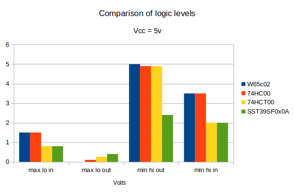

Keeping to a single logic family ensures that the logic will work. The problem is that not everything on your (anybody's) design is strictly a given logic family. Consider: you will need at a minimum a processor, some RAM, some PROM, and some glue logic.
Let's choose - ignoring ram for now - a W65C02 processor, a 74HC00 and a 74HCT00 for glue logic (other parts in the same families have very similar values), and your SST39SF020A.
Some of this data is extrapolated; it's not directly specified for the 5v Vcc for the HC and HCT parts, for example, and neither does the 65C02 specify its output levels beyond 'CMOS'.
Looking at the first two columns: the first is the level below which the input voltage must be to guarantee a low is understood by the part; the second is the maximum guaranteed low voltage output. Every part has a low output which is lower than every other components maximum permitted low input, so there are absolutely no problems there.
The second two columns tell a different story. Here we have the minimum output level for a high, and the minimum level required to guarantee its correct input. We see that all the families except the ROM have outputs that are close to the rail, well above the voltages required by all the parts. But the ROM only outputs 2.4v... that is insufficient to drive either the processor, or normal HC logic, though it's quite happy talking to itself (naturally) or to HCT logic.
The blunt answer is: it won't work.
The more nuanced answer is: it probably will. But it might not, and if it doesn't, you're out of luck. In spite of the minima for output levels, they're the minima at particular currents; in the case of the ROM it's significantly greater than the input current of a CMOS part. You can expect, in most cases, that the output will be plenty to drive the processor's inputs directly - but you would _never_ design a production part like that. One approach would be to use an HCT buffer between the ROM's output pins and the data bus which would provide a level conversion (at the cost of a few nanoseconds' delay).
Sorry if I am repeating what you just said, but I light bulb went on in my head and now I am confused. So according to the 65C02 sheet, the minimum high level for the data lines should be VDD x 0.7 (3.5V in the case of 5V power rails). But both EEPROMs (28c256) and Flash (SST39SFxx) have a min high output of 2.4V . Wouldn't that mean that all example 65C02 designs all over the web works just by pure coincidence? I.e if I am to rely on the output from ROMs or flash I should buffer it with some HCT logic?
Again you probably just explained it but my brain went into overdrive and I can't comprehend nuances at the moment :)

To understand signalling between families, you need to understand that what the inputs will accept, reliably, is one thing, and what the outputs will produce, across all parts and all conditions, is another. Those are the specifications. And then you need to understand that the parts may exceed those specifications. An output high which is for some reason on the low side might nevertheless be sensed as a high by the receiver.
And so you might have a design which works, but is unreliable. Or it works, until it gets hot. Or it works, until you add enough things that the power supply gives a slightly lower voltage. Or it works for you, but when anyone else builds it, it doesn't. Or it works with one brand of memory chips, but not another.

It's that nuanced answer again.
(a) pretty much any CMOS output will drive rail-to-rail _into zero load_. Not all, but most.
(b) any logic input (with the exception of exotica like ECL) will cheerfully operate on a rail-to-rail input. It's the mid-rail stuff that gives it nightmares.
(c) the actual input transition is somewhere around half rail; HCT has a different input arrangement so that it understands TTL input levels
(d) CMOS input stages are generally _very_ high impedance and might require only a few microamps to operate (effectively, you're charging a tiny capacitor).
So TTL nominal outputs will generally be a lot closer to the rail than 2v - stick a scope probe onto the signals on a vintage computer and you'll generally see signals moving up over four or four and a half volts. Which is why you can _usually_ get away with nominal TTL level outputs from RAM and ROM pushing into a CMOS processor.
Going back to the original issue: it seems likely that the current draw through the un-resistored LEDs would cause the output to be below the point at which an LED would light. But I don't know why your bare chip isn't behaving.
