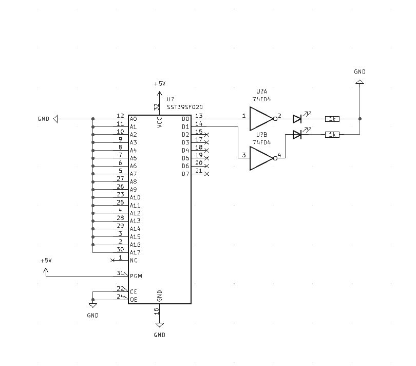

In that case, and assuming that the wiring is actually as you have in the diagram, I would remove the LED block and measure the voltages at the pins _without_ any load. You may well find that the output there is exactly as expected, but that the chip is unable to drive into the low impedance of a LED. In which case, to drive the LEDs, you'll need buffers of some sort.
edit: you mention your LED pack has internal resistors, but are you sure? Do you have a datasheet for the part you can provide (a link to) here? Or a manufacturer and part number?
This was going to be my next suggestion, perhaps putting in a 74xx245 to drive the LEDs from (at least for testing purposes)
Really the LEDs probably should be sent through some transistors that can handle a larger load than most ICs can provide.

Ok, first of all THANK YOU all for the responses; I'm so appreciative of the help y'all are giving me. Second, on reflection maybe this should be moved to the "Newbies" board, especially with some of the questions I'm going to be asking. I'll leave that up to the moderators. Now, to address people individually:
@people mentioning resistors on the LEDs: Y'all were absolutely right, I'd made an assumption based on the fact that they hadn't burnt out immediately when I connected power to them (as individual LEDs had done). I dug up the datasheet and, plain as day, said to add resistors to limit the current. I must have just gotten lucky with my power supply not giving much amperage. Lesson learned, I've put 1K resistors in, and thank you!
@barnacle: Good idea. I disconnected things and used my multimeter to check the voltage on several pins. As a sanity check, I probed the +5V and GND pins and saw, as I would expect, a 5 volt difference between them. When I checked between GND and D0 (which should be a "1" due to the contents of the chip at address 0x00000), I saw no voltage between them, which probably means the issue is there. I'm not sure how to go about debugging this.
@BigDumbDinosaur: Good advice. I think there's an error farther up the circuit than the ROM not being able to drive the LEDs. At present, I don't have any buffer chips (I will get some), but I was wondering if using inverters gates would work in the meantime?
@John West: Thank you for the advice. I don't think that that is an issue, as the power supply and chip are both on the left side of the midpoint (and I'm registering 5V and 0 on the power and ground pins). Additionally, the LEDs are working, and they're on the opposite side of the midpoint from the power supply

Regarding your test circuit:
- Ensure that you have power to your chip - ground to pin 16, 5v to pin 32. Remember that a DIP package starts with pin one at the top left and goes anticlockwise until you get to Vcc. According to the datasheet, pin one is marked with either a notch in the top edge, or a dot at pin one.
- Tie the following lines to ground: A0-A16, CE#, and OE#
- Tie the following lines to Vcc: WE#
- Ensure that pin 1 and pin 30 are _not_ connected to anywhere
That's it. If that part is healthy, and your power is healthy and smooth, and your connections are all good, you'll get the contents of address zero on the data pins.

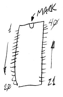

Something I am reminded of is that we may forget that newbies can have something as simple as the pin-numbering convention wrong.  We had one of these some time back but I apparently am not remembering adequate search terms to find it.  Looking at the top of the IC, with the rows going vertically and the notch or pin-1 dot at the top, or a beveled edge on the left, you start with the top-left corner for pin 1, and go around counterclockwise, this way:
I'll put it in the 6502 primer.
Done
Done
Done
Pin 1 is NC, but why pin 30? That's address line A17 on the SST39SF020A. It's currently tied to ground.

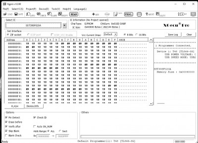

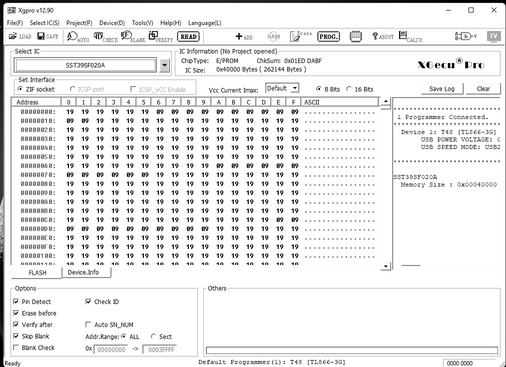

That would suggest that it's something wrong with the chip, but I can read the contents off of it through the programming software:
I've also included an updated schematic of the current state of the circuit:
Right now, the two LEDs that are hooked up to the ROM via inverters are lit up, suggesting that the output on the pins is "00", but the 0x19 at 0x00000 would suggest it should be "01". One thing I've noticed is that if I move either the #OE or #CE wire from Ground to +5V, the two lights go off, suggesting that the chip has gone into a high impedance state, which is what would be expected. It remains there until I plug the wire back into ground, so the chip is doing something at least.
My mistake, I thought you were using the *F010A. You are correct to ground it.
The fact that the output is disabled when CE# or OE# is raised suggest the chip is working. Which raises questions about the programmer... how did you achieve that string of $19 and $09 shown in your programmer software? Is it possible that that's the contents of a software buffer prior to programming, or indeed reading, the F020A, and not the actual contents of the F020A at all? Can you program something different into the part at the low addresses (something distinctive like $55 or $AA) and then try and read again?
I'm not familiar with either the programmer or its software, but if the F010A is new and unprogrammed I would expect it to be full of either zeros or ones.
