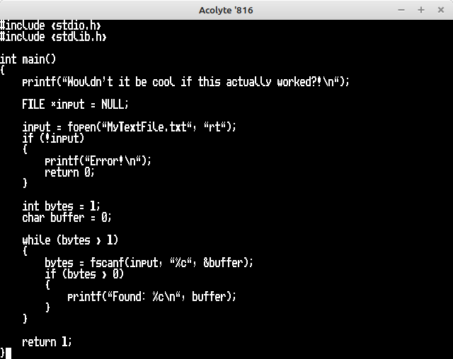

But it works now! Attached is my uncommented code, a GIF showing some features off, and then a PNG of what I'd love to eventually be doing with this.
Defrag seems to be working and vertical scrolling is VERY nice. The reason why it's slow to draw on the screen after Return and Backspace, yet fast after Page Up/Down is because it's not redrawing the entire screen each time... it's hardware scrolling! At least that's the plan going forward with my next SBC.
I have a couple more functions I want to implement, but 99% done now. Now, what am I going to use this for? A programming environment! I'm not sure if it will be version of BASIC, C, or something else, but I am planning on not using line numbers.
Well, thank you again, everyone, for the conceptual help. This was really neat
