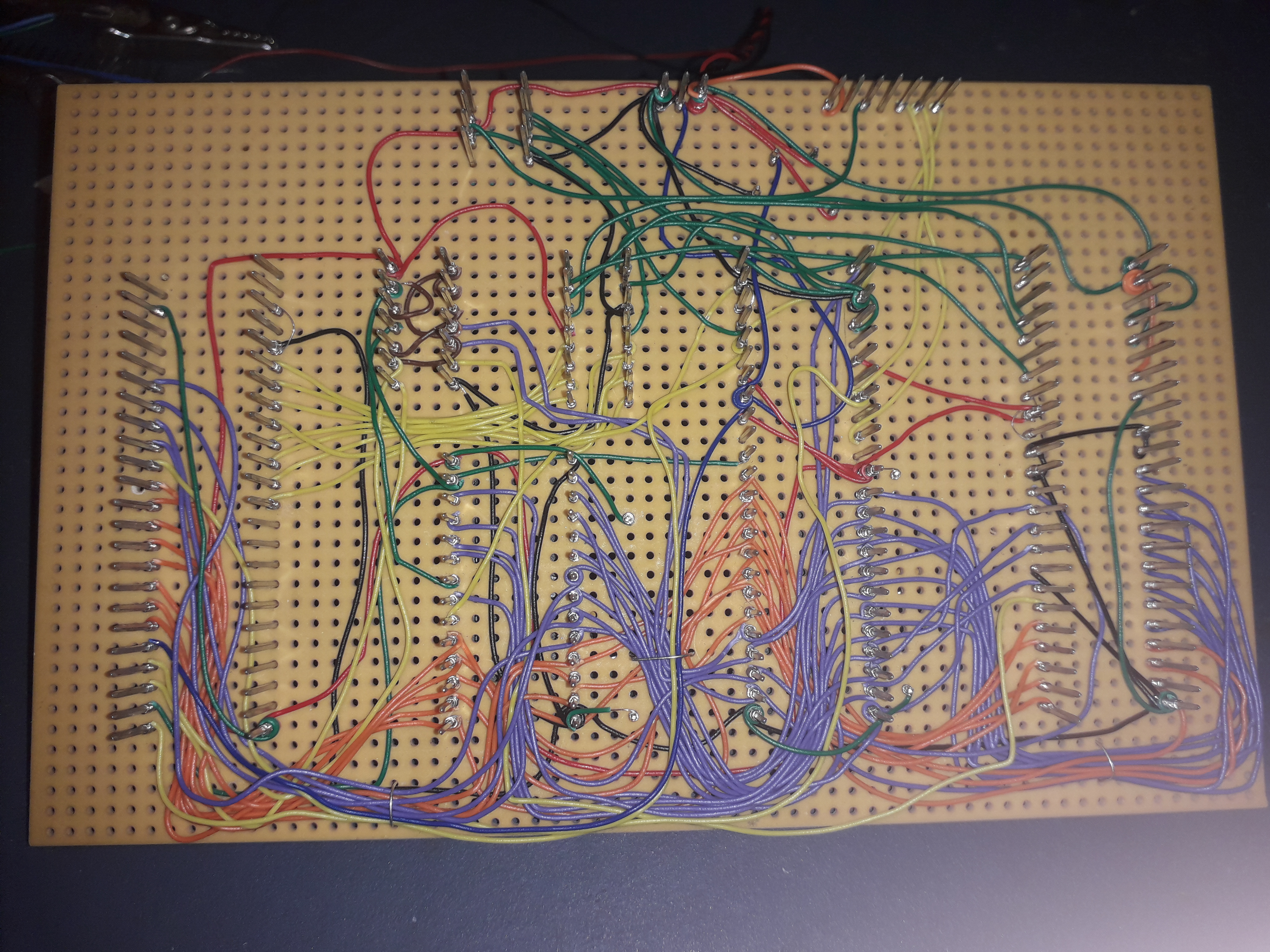

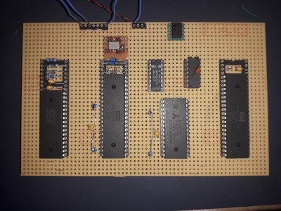

FlimsyFlipFlop
Posts: 3
Joined: 22 Jun 2025
Location: Belgium
Re: Timer interrupts with 65C22
Post by FlimsyFlipFlop »
Thank you for all the replies.
The construction is all wire wrapped (with no bypass caps), so spurious signals isn't out of the question.
All suggestions are appreciated and will be tried, starting with those darned bypass caps.
I will let you know the results thusly
Much thanks,
FFF
Counting every cycle
Posts: 9425
Bypass capacitors in digital circuits are a lot like money: no such thing as “too much.”  I can’t begin to count how many times someone has asked for help in taming a malfunctioning machine, only to find out said contraption has no bypass caps.  :D  The ones I recommend are 0.01 µF, 50 volt, X7R MLCCs.  Each chip should have one, with the cap’s leads as short and direct as possible to minimize inductance.  Beware of capacitor quality!
It is important to understand that in digital logic, it is output state transition speed that causes a lot of trouble, not the MPU’s clock rate.  74HC logic, the slowest logic usually recommended for 65C02 builds (use of NMOS parts in new designs is discouraged), has a very rapid transition speed, which can generate switching noise with effective frequencies in excess of 100 MHz.  If not correctly bypassed, such noise can sneak into all sorts of places and in the case of a wired-OR interrupt circuit, can result in transients that may be seen by the MPU as interrupts.  You will go around the bend trying to troubleshoot such misbehavior.
Also, as Jeff noted, robust power and ground connections are de rigueur.  Ground bounce, in particular, can result in some really difficult-to-identify hardware problems, and as he points out, not just spurious IRQs.
FlimsyFlipFlop
Posts: 3
Joined: 22 Jun 2025
Location: Belgium
Hello all
I have tried the suggestions, with success.
The timeline is as follows:
- my code completely still, but with bypass caps: no change
- without interrupts, just main doing the outputting: there it is.
- with the defensive programming as demonstrated by BigDumbDinosaur: it works, interrupts and all.
I've attached some photos to show the amount of spaghetti my computer has.
I tried to use a colour scheme when I started (yellow I/O data and control, purple address bus, orange data bus, blue clock, and so on),
but ended up just using whatever spool I had by hand towards wiring up the op-amp, DAC and bypass caps, because by that point
my workspace was thoroughly full of insulation and messed up wires.
The DAC is another can of worms because I've never used the DAC0800 IC before, my op-amp output is nonexistent and the current output of the DAC
looks like the sine's been bit-reversed (I knew having that contraption work from the first time would be too good to be true).
Thank you all very much for your help.
Regards,
FFF
Well done FFF, and thanks for the pictures.
