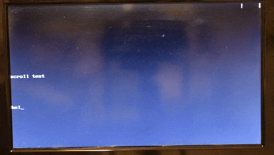

You can decode the 38.4K region of graphic memory such that a data read in that region also write the data into the pixel shift register. This way a separate write operation is not needed. So the instructions are read, increment index, and repeat 80 times to display a line of 640 pixels. While waiting for next horizontal sync, the software can read the PS2 keyboard shift register, and output a byte of sound. So it is a standalone computer with video, keyboard, and sound.
Edit, the design is described here,
viewtopic.php?f=4&t=6517&hilit=Vga65
A demo toward the end showed mixed text and graphic with screen scrolling feature. The graphic is BadApple in 192x144 resolution playing at 17 frames/sec
