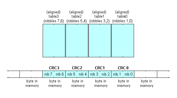

Yes, I had the same idea, or one that's highly similar. But --verbally, at least -- it's quite challenging to explain! So, this morning when I saw your post, BB8, I opted to make a diagram. Perhaps you can confirm if this is also what you were thinking.
the nibbles of the CRC are aligned in memory, and the tables match this alignment
CRC aligned.png (3.32 KiB) Viewed 2081 times
To begin, I'll review. Here (above) is a diagram showing the approach used upthread. I'll refer to the "not-so-bad solution" in this post. As shown in the diagram, the CRC is held in a series of bytes in memory. At the top of the loop (label readvalue:), an input byte is fetched. Then in the rest of the loop, most of the work has to do with shifting the CRC right by 4 bits, fetching an entry from each of the four lookup tables and XORing that entry into the corresponding byte of the CRC... then shifting right again and fetching/XORing again (because there are two nibbles in the input byte).
IOW, for each pass through the loop the CRC gets updated twice... and also the CRC gets shifted twice... which requires a heckuva lot of effort! (As we know, the CPU can't do 4-bit shifts; we can only ask it to shift the entire CRC by one bit, then do it again and again and again.)
It's slow, but the 4-bit shifts do achieve the goal of aligning the CRC so it matches the tables. In contrast, my idea involves temporarily (mis-)aligning the tables to match the CRC! To do that, we need an additional set of tables (as shown below).

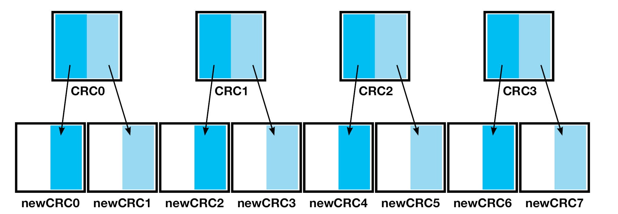

Post by BB8 »
@Jeff: I meant something different. With your approach you are still doing a set of 1-bit shifts, while I want to eliminate that too. And you'd need 4 tables for nibbles in low and high positions.
My idea would be to have everything in the low nibble.
There should be 2 tables: one with the low nibbles of the current table, the other with the high nibbles but moved in the low position. So each table would have values in the form of %0000xxxx.
Then the nibbles of CRC0...CRC3 would be split in 8 new variables each containing half the byte of current variables:
newCRC0 = (hi(CRC0) >> 4)
newCRC1 = (lo(CRC0))
newCRC2 = (hi(CRC1) >> 4)
newCRC3 = (lo(CRC1))
newCRC4 = (hi(CRC2) >> 4)
newCRC5 = (lo(CRC2))
newCRC6 = (hi(CRC3) >> 4)
newCRC7 = (lo(CRC3))
(the nibbles will always be in the "low" position)
So the mechanic of the algo stays almost the same, but instead of 4x 1-bit shifts, you can just copy a byte (nibble) to the next position (i.e. lda newCRC1 / EOR table,x / sta newCRC2: voilà, a EOR plus nibble shift). Probably the EORs will have to be done in reverse order (newCRC7 ---> ... ---> newCRC0)
Then at the end the nibbles must be merged, but this will happen only once.
This requires 8 CRCx variables (instead of 4) and to double the table.
