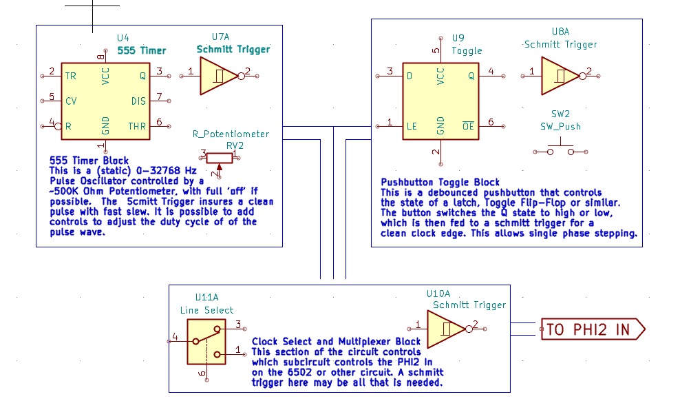

here, this is more what I am trying to do, from a step back

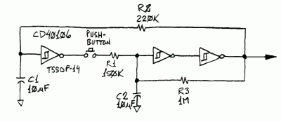

That’s rather complicated. Dr J has a much simpler debounced single stepper here:
viewtopic.php?f=4&t=8059&hilit=Debounce ... 45#p108132
That one is good for delaying the reaction to the button.
Huh?? No, I think you must've only glanced at the circuit, Garth -- it responds immediately; no delay.
BTW, I didn't invent that circuit, but I admire the person who did. I stumbled across it in the user interface portion of a musical keyboard synth I was servicing sometime back in the 20th century.

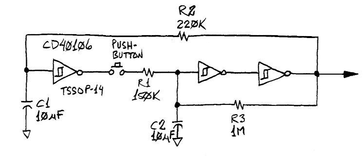

You're right, and once again I embarrass myself by going too fast.  Here's what I did (showing only the relevant parts):
(and the reason it's using a 40106 is because it has to handle up to 12V.)
