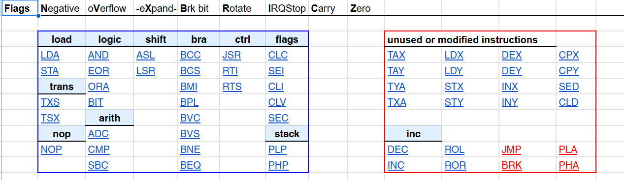

thinking about this a little more, id almost say make it 6 bit opcode, with 2 bit Xtra register select
so that would be:
765432 10
opcode rs
00 Accumulator
01 RAM register/inner register
10 RAM register/inner register
11 RAM register/inner register
if so, this is where I would use the 'select best' comparator, which is now better limited on fan-in/fan-out.
this gets us down to 32 instructions:
LDA AND ASL BCC JSR CLC
STA EOR LSR BCS RTI SEI
trans ORA BMI RTS CLI
TXS BIT BPL CLV
TSX BVC SEC
NOP ADC BNE PLP
CMP BEQ PHP
SBC
JMP can be done with stack trickery i think
PLA/PHA can be done with a TSX/TXS, which are actually just 'transfer now', and you just TSX the address to the stack, if anything, control of stack pointer value is fine, and the address of the top of the stack, you just STA there to push onto the stack.
BRK is possibly a STA of value to the status register and setting it there, similarly, the BCD module is gone and its bit is the Rotate bit, and it controls how the Shifts work. other opcodes might use this too, so its maybe 'Reserved' bit, Im not sure BRK cant be replaced with some stack manipulation and the RTI/RSR operations. SED,CLD are gone, the TXY/TYX/Etc are gone. INC/DEC used a lot of cycles, and are a fetch/modify/repeat operation, so this is not difficult to recreate, LDA, ADC+1, STA, is 2 extra cycles for immediate mode. they are not useless operations, just a nicety we can look at setting aside for this Risc-502.
CPX/Y is now just compare, and it may be done on the stack, or memory addresses etc.
so with a 32 character instruction set, so far, we are now at 5b opcode, 3b suffix, and in style of 6502, 8bit operand.

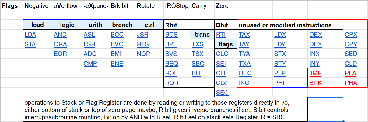

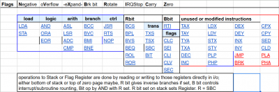

Re: a 16x504 -- the 16 instruction 6502
16x504
a 6502 based 14500b ish 6502
So here we have a 16 opcode instruction set
we use the Break Bit for Interrupt and Subroutine control,
the R bit to access a variety of Reversed or Restricted or Reserved commands.
It becomes out 'inveRse' bit. we still havent use the eXpansion bit,
the Bit command is moved to the AND command with the R flag set,
Branches are mostly inverses of themselves and the R bit serves here as well.
Further exploration into what opcodes would make the final cut remains, however:
this puts the "6502 instruction set in 4 bits" this is now a very minimal system, and should still be capable of running "6502 like code". kinda.
it could be possibly made to run on 4 bit. and a 4 bit set of registers or 'cache' that has the stack pointer address, the flags, the accumulator (on 0) etc, there are some ways here to map the other 4 bits here, (which kinda got moved the the status register, and im saying the status flag register, should be an address, not relocatable)
several places indicate a 'last operation' or 'last state' and a buffer register unseen seems somewhat intuitive, though it may be the 'datapath itself' register. its an odd one to think about.
so, 8 bit (or 4? or 1?) processor, with a 4 bit instruction word and an 8 bit operand, leaves a 4 bit suffix, address space here is not yet discussed. on a 8 bit processor, with 8 'registers' you get an Octlet, and LDx?Stx can be done with a octal suffix, so going to a 4 bit suffix, it is possible some of these opcodes may have different address, control line codes, or other suffixes.
some opcodes, like CMP, might be faster if done to the Stack (1111) than a memory address (0000+operand). again, it is wondered it a 'buffer' register is in the machine.
If this follows the 8/16 address system of 6502, then 4 bit opcode, 4 bit suffix and 8 bit operand words, can now easily by 12, 16 or 20.
a 4 bit compare, would be 'accumulator' to 'the value at address of the register', so 0000 is accumulator, and 1111 is stack, so if we CMP1111, it compares the Accumulator to the value on the stack, if we use, 011, it looks at register (of our octlet) and uses the value there. if we want an offset, we use Status flags to control if we get another operand to increase our addressing space.
for many operations, we have 12b addressing, or 4k.
with control registers for say, inner or outer addresses, it is easy to have 16 bytes of 'register space',
where the accumulator (0), indexes(1,2,3,4,5,6,7) , stAtus flags (A), <Buffer/last value>(B) program Counter(CD), <Extra>(E), stack pointer (F),
so operations such as ADC, OR, XOR can be done on the octlet via command with a suffix of 0001-0111,and 0000 being the accumulator, fetches another byte for the address in memory (to put in that buffer), and might use a Flag (X?) to get a 16b address instead. Further, R 'negates' the operation, and causes NOR or XNOR, or Subtraction is done instead. So, there is more Flag and Control work to be done, however using them allows for a very minimal instruction set.
H7654 3210 (&NVXBRICV), L76543210 (+ X76543210)
Opcode Suffix status modifiers page address outer address

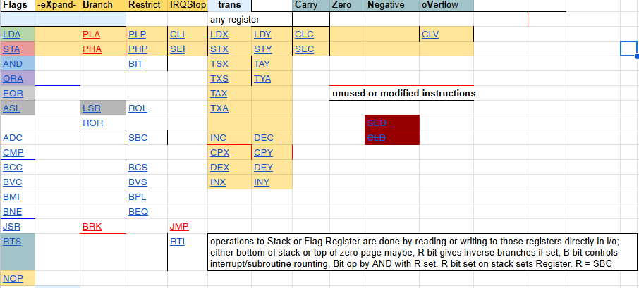

Re: the 16x504, a 16 instruction 6502
https://sleepingelephant.com/ipw-web/bu ... hp?t=11123
on review here, to iterate, instead of 5 bit (3 bit opcode, 2 bit opcode page), and 3 bit addressing (as stated above in the 6303 post)
we are in the 16x504, with a 4 bit opcode, and using the B, R, I and X bits, to give additional control signals or modes.
and reviewing this, using at least 2 bits for addressing, as we no longer have the Y, and X registers, we dont need octal addressing.
00, accumulator, implied, immediate
01, indirect, or direct
10, 8 or 16 bit address
11, uses a direct 16b address, stack otherwise
JSI(JMP) uses relative, absolute, vectors, based on Irq and Brk flags depending on instruction, and may use these op-modes
that leaves 2 bits for 00, accumulator, 01 Status, 10 PC, 11 stack, maybe.
this would allow for several forms of relative addressing, indexing and other operations, while maintaining the 6502 instruction set overall.

Here, I think I have all commands from MOS6502 represented here, through the use of control and ALU flags (which gets set from the new comparator) too
you can perform each 6502 command, give or take, 4bs at a time (possibly 8/b with register chaining/echoing, if i get that to work),
its going to use the B bit more, and Im leaning towards using the X bit, to address 'inner registers and vector tables'
yellow shows how orthogonal register addressing is used, TAB/TBA/TBS etc, is performed using OPCODE+MOD+SRC+DES and is simply a LOAD/STORE sequence.
SWAP is done in software using XOR fast Swap, or a vectored register maybe. thats more likely to cause a collision though.
this means that MOS6502 ASM should 'tran-ssemble' or cross compile down to, 6404 asm thats more expanded. it would not be optimized, it does mean that 6404 ASM is more and more a subset of 6502 ASM
oh, one "language" I would want a Compiler for, is VHDL, either to print a object file, a netlist intermediary file, a vhdl interpreter, to parse vhdl files (another language here is g-code), and for the vhdl compiler, to use the general purpose language features, to compile a executable for the 65xx family computers. vhdl is a general purpose language.
I checked the C documents, this computer chip can support a very slow, minimal C environment.
