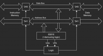

Im still thinking Harvard arch... to me, the Program Counter should be completely removed from memory access.
getting the next operation, should not be something that changes data addresses, however, this can complicate design by requiring two separate data and program busses. Opcodes should mostly come out of ROM, and Data should mostly be in RAM... to me at least

that's the main problem with running a DMAC and CPU at the same time on the same bus.
one way around that is to seperate their busses (via a 74x245 for example) and give the CPU the ability to access the DMAC's bus, but not the other way around.
that way the DMAC can run while the CPU still has it's own private section of RAM/ROM and some IO to access, but would get blocked when trying to harass the active DMAC's section of the address space.
of course it's not an ideal solution as that means the DMAC cannot copy data from/to the private address section.
so another way is bus sharing, since the 6502 and 65C02 only use the second half of a clock cycle to actually access memory, you can use the first half for a DMAC. this allows both of them to run at the same time with no performance loss on either site, but of course it also requires much faster logic and memory (especially at higher speeds like +10MHz).

Sadly, there are no huge speed gains here. It's 13 cycles per byte so for small (≤256 byte) copies it saves only a couple of cycles per byte for a DEX (and maybe one more during the entire copy if it crosses a page boundry), and not exactly a huge amount more if you're doing larger copies. That's far from even the 7 cycles per byte of a 65816, much less the 2 cycles per byte of a DMA engine.
I am seeing that as well, and "PHI1 DMA" might be a better choice overall
Using MVN/MVP has the limitation that the 65C816 doesn't have the handshake mechanism typically implemented by a true DMA controller.
