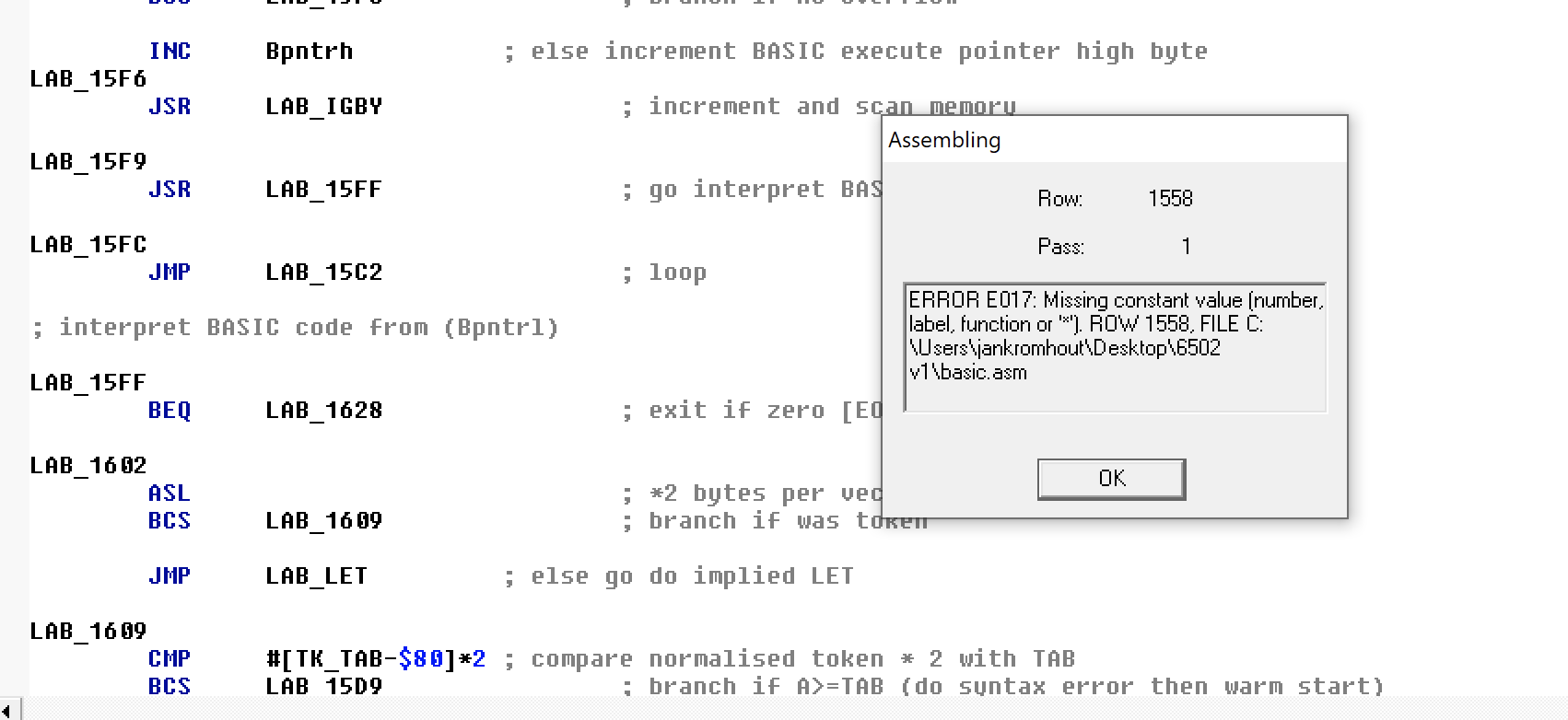

When I try to compile min_mon.asm I get. error in the iclude file.
When I compile the include file basic.asm I get this message.
Maby there are more errors but the program is stopped here.
The source I use is in the zip file.
Thanks for any help.

Re: Runing EHBasic on Kowalski Simulator
Ah, sorry, of course Kowalski includes its own assembler. I wonder, then, are you running a very old Kowalski - what's the version number?

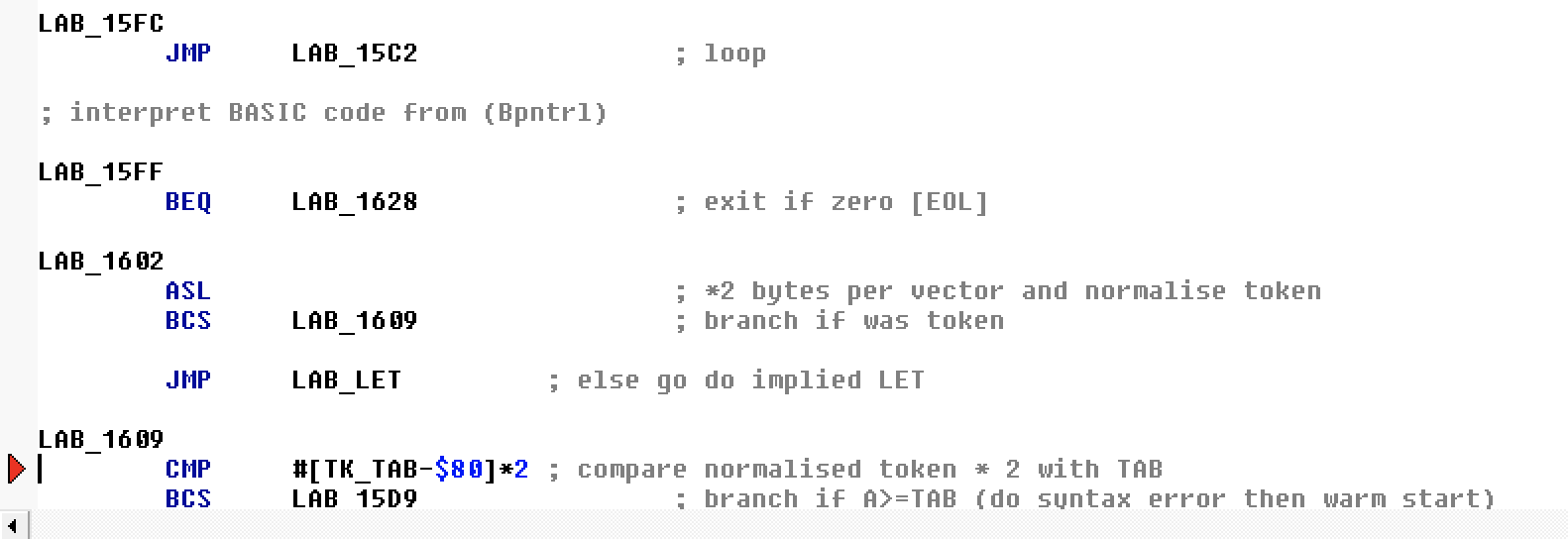

The rejected line is a syntax where square brackets are used as expression parentheses:
LAB_1609
CMP #[TK_TAB-$80]*2; compare normalised token * 2 with TAB-

LAB_1609
CMP #[TK_TAB-$80]*2; compare normalised token * 2 with TABTry replacing the [ ] with { }. That should work.
Be sure the IO area in the Simulator is set to $F000.
After you assemble the min_mon, start the simulator, press the run button, then the RST. The reset should bring up the Cold/Warm start message.
Daryl

powersoft_51 wrote:
This is my version:
As suggested, go to Daryl’s site and get the latest version.
Also as noted, expressions such as 2*[4+12] should be edited to use curly braces, like this: 2*{4+12}. This change was necessary due to Daryl having enhanced the Kowalski assembler to work with the 65C816 and its new addressing modes. In particular, the 816's indirect-long addressing modes use square brackets instead of parentheses, e.g., LDA [ZPPTR],Y. Since an arithmetic expression such as 2*{4+12} may be used in place of ZPPTR, the curly braces are necessary to avoid confusing the assembler, e.g., LDA [2*{4+12}],Y.
Speaking of the 65C816, the latest version of the Kowalski package is able to simulate the 816 and its environment—including extended memory, something that I have found useful in testing 816-specific algorithms.

Thanks for the replay, it is working well on this moment.

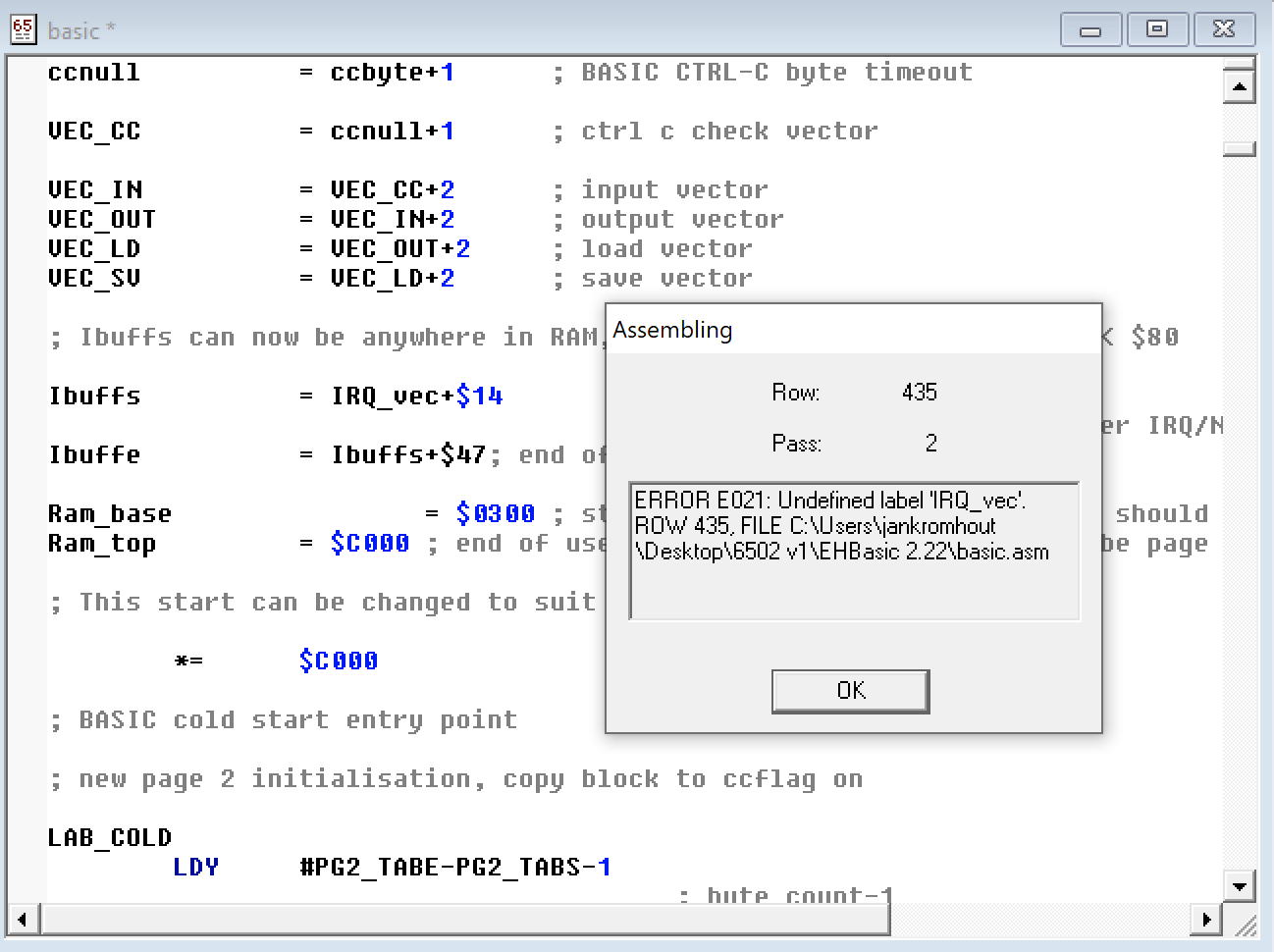

When I try to compile got an error on line
Ibuffs = IRQ_vec+$14
The files I use I also included.

Please discard last message, I compiling the wrong sequence.

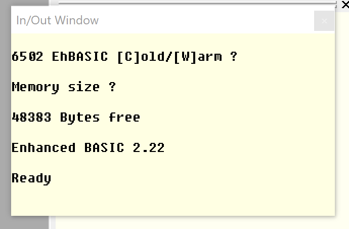

Compiling is okee, but when I stated NHBasic and enter the "c" for cold start and a return for the memory size
the program is running to the end (without anything) and prints ready.
Some idee, what could wrong?
Can you post a capture of the Simulator Options tab and the Assembler Options tab? As long as you are running the default source with the exception of editing the [] with {}, it is most likely something in the Kowalski options.
Daryl
