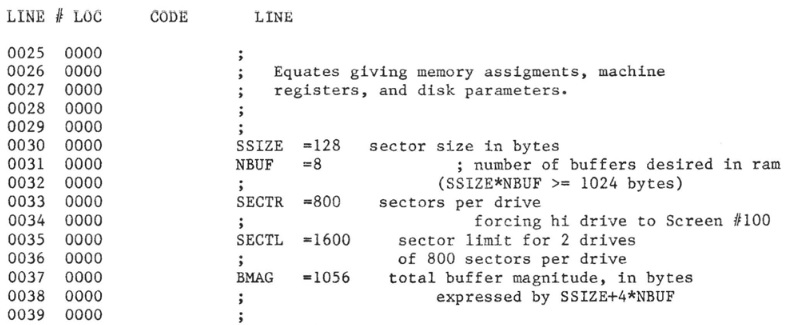

I have a figforth running. The editor is when loaded running well when I use the original setting:
SSIZE     = 128          ; sector size in bytes
NBUF      = 8            ; number of buffers desired in RAM
;                             (SSIZE*NBUF >= 1024 bytes)
BMAG      = 1056         ; total buffer magnitude, in bytes
;                              expressed by SSIZE+4*NBUF
When I make a little program and store it in screen 5, and do 5 load it is working fine!
But when I increase the sector site like this:
SSIZE     = 512          ; sector size in bytes
NBUF      = 4            ; number of buffers desired in RAM
BMAG      = 2064         ; total buffer magnitude, in bytes
The system is crashing when I do the same as above.

One difference I see right away is that they have the assembler compute BMAG.
Also, they are set up to have a raw sector block system on a single 128KB track, so they set up SECTR to force Drive1 to be empty.
	;; to start with, disk I/O will be to a single
	;; 128 kB on track $C0 but could keep going
NBUF      = 2 ;4 		; number of buffers desired in RAM
;;; these will limit things to 512*256/1024 128 screens..
SECTR     = 2560		; sector per drive
				; forcing high drive to zero
BMAG      = (SSIZE+4)*NBUF	; total buffer magnitude, in bytes
Compared to the 1980 fig-Forth listing in the screenshot.

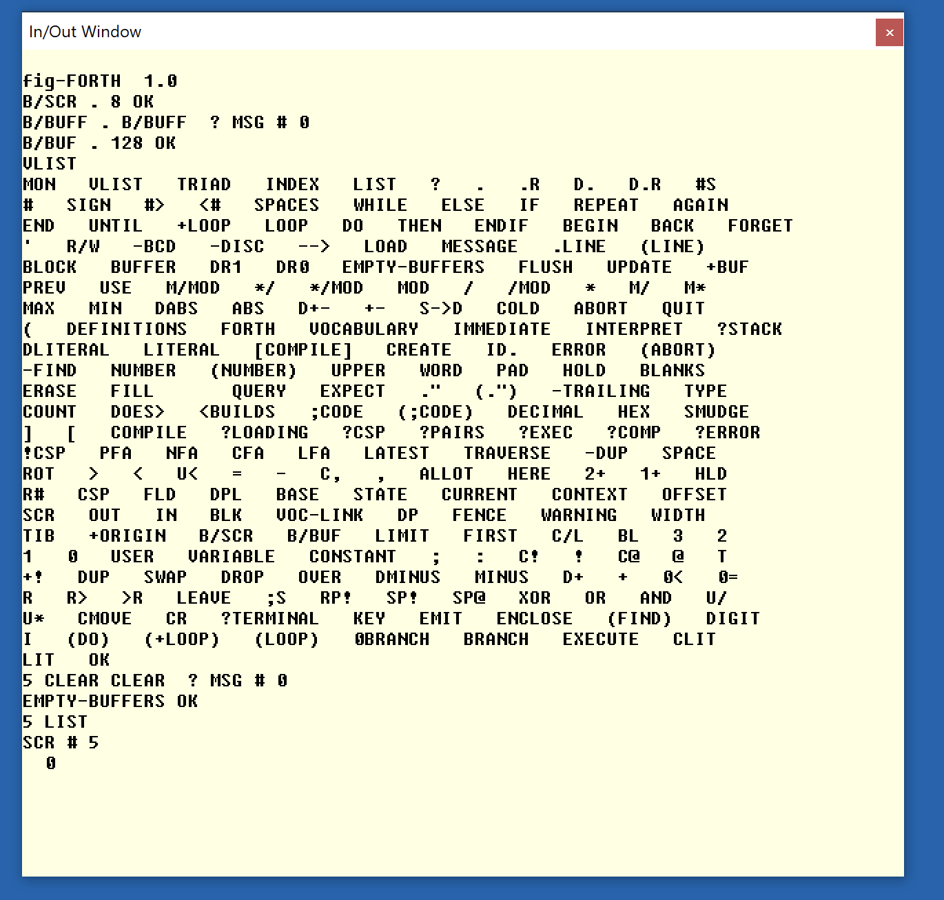

Today have taken a fresh FigForth source, make two modifications.
Replace u< because in the original was a error, and change te R/W routine.
Fig is running in the Kowalski emulator, and runs fine.
But when I do empty-buffers, 5 list the system is hanging, or waiting for input.
I have further make no changes.
Include as zip my source file, and a screen print when list screen 5
