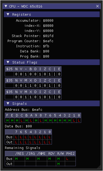

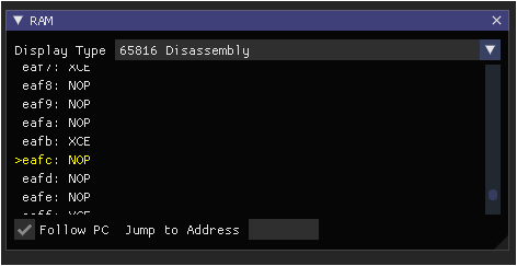

It may not be much but.... I now have a second opcode implemented!
Ok. No, it is not much to be honest... but I've been doing more things meanwhile.
The new opcode is XCE and with it, the ability to switch between native and emulation modes. The status register properly reacts to this, swapping the Unused and Break flag in emulation mode, for M and X in native. In the CPU Panel, I have both "versions" of the status register, and on the bottom, the current one, depending on E value.
SP high byte becomes 0x01 when the swap happens. As I cannot yet change M or X, nothing new is added to the Acc, X or Y registers.

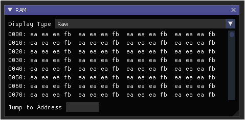

Also, the option to step instruction by instruction is in place. Before, I could only step the clock. The emulator puts a breakpoint on the rising edge of VPA and then it stops. Keep in mind, this is not 100% correct, as VDA (which is not yet implemented) should be added to the ecuation.
Execution trace (replicating Andrew Jacobs emu816 trace, to compare both) and a memory explorer with a dissasembler are implemented too. I am adding opcodes to the disassembler as I go. As I am only working on 1 byte instructions (implied addressing) I have not paid too much attention to the addresing modes. Meanwhile, I am still reverse engineering the original emulator, to understand how the 6502 modes were implemented, and the same time, investigating the 65816 new modes.
I am attaching an excerpt of the execution trace. Some bits are still missing though.

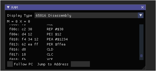

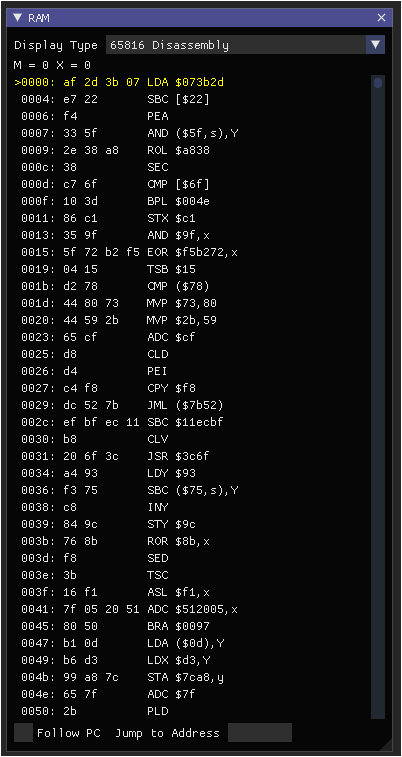

And now, a complete disassembler! The original project had a 6502 disassembler, which I have extended to work with all 65816 opcodes and addressing modes.
When using immediate addresing, to choose between an 8bit or 16bit operand, the current M and X flags are taken into account. Also, the disassembler offers the option to follow the PC, so it will stay aligned with the execution flow.
I am aware of more complex solutions to the operand size problem, but I hope this is accurate enough for my needs.
Also... and of this, I am not sure... If the opcode targets the Accumulator, then the operand size depends only on the M flag. If the opcode targets X or Y, then it only depends on the X flag. It makes sense to me, but still...
PS. Do not try to make sense of the code in the image, I am using a 64kb image of random bytes.
That is correct if an immediate-mode instruction is being disassembled.
The disassembly of PEA at $0006 and PEI at $0026 is incorrect.  Where are the operands?

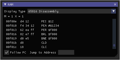

Awesome, thanks for the feedback!
Lost in the WDC datasheet I'm afraid.
In Table 5-5 Operation, Operation Codes, and Status Register, both PEA (opcode F4) and PEI (opcode D4) are listed as using the Stack, s addressing mode. Then...
3.5.22 Stack-s.
Stack (s) addressing refers to all instructions that push or pull data from the stack, such as Push, Pull, Jump to Subroutine, Return from Subroutine, Interrupts, and Return from Interrupt. The bank address is always 0. Interrupt Vectors are always fetched from Bank 0.
Unlike most other addresing modes in the datasheet, gives no indication on how many bytes the operand has. Next source of information was Table 3-1 Addressing Mode Summary which, indeed, says that stack addresing mode opcodes use only 1 byte (So no operand). Other opcodes with this addresing mode (Again, always blindly trusting the datasheet) which I'm familiar with, from my limited experience with the 6502... PHA, PLA, PHX, PLX.... all single byte, no operand, so I didn't even question the other opcodes which were unfamiliar to me.
To be be fair, Table 5-4 Opcode Matrix actually lists PEA and PEI as being 3 bytes and 2 bytes long respectively. I've noticed I've made the same exact mistake with PER.
It's an easy fix though. In the disassembler I have :

And then, another array containg the addresing mode for each opcode.
Each addresing mode has an associated length, and a printing format. Fixing PEA, PEI and PER it's as simple as adjusting it's addresing mode to the correct one. It's importante to note, this is just for the dissasembler, this is not used in the actual instruction emulation, though it may be a good idea at some point.
The above code still contains the wrong values for those three opcodes. And there may be others. As I implement each one of the opcodes, each one of them will be put to test, so I hope to catch any mistakes, sooner or later.

“Current PC” meaning what?  The offset is computed relative to the address of the next instruction, not the value of PC at the PER opcode.  Assuming the instruction is PER $1234 and is assembled at $AB0000, the base address from which the offset will be computed will be $AB0003 and the offset will be $1231.  The disassembled instruction would appear as:
AB0000  62 31 12     PER $1234
As far as I can tell, E, M and X do not affect PER, PEI and PEA in any way.
Correct.
I've amended the disassembler with all these changes.
Your disassembly of the PER instruction is incorrect.  It should be:
F013: 62 D4 0F    PER $FFEA
The operand seen by the MPU when it executes the instruction will be $0FD4, not $FFEA.  In this case, the offset would be computed relative to $F016, which is the CLD instruction.
Also, note that disassembly should be displaying 24-bit addresses in the first column, even if operating in emulation mode.  For example:
00F013  62 D8 0F    PER $FFEA
The 816 always emits a 24-bit address, regardless of mode.  Even when running in emulation mode, access to extended memory is possible, as instructions such as LDA $AB1234,X are perfectly acceptable, as is changing DB to some bank other than $00.  Also, doing a JML or JSL is legal in emulation mode, and will run code in an extended bank.
BTW, no need for the trailing colon in the assembly address field.
"Current PC" meaning the PC by the time the last byte of the instruction has been read — but now I see that was both inaccurate and wrong, as that meant the last byte of the PER instruction. As a side effect, I also found that my code for calculating the offset for BRL was off by one byte due to pure laziness. I was adding 2 to the instruction address for 1-byte branches, and just reused the code for BRL.
Noted, and changed. Keep in mind I am expanding the original emulator, which was a PET emulator only. There’s a lot of "8bit-ness" scattered throughout the code. Changing the memory panel and the disassembler is only a matter of tweaking a couple of "printf"s. Being able to add more than 64KB of memory to the emulated system will have to wait for now. This will involve creating some glue logic to capture the Bank Address due to how the emulator is implemented:
- The chips are emulated. The CPU, memory, clock, and many others (there's a 6522 in there that I haven't tried yet) are emulated with a lot of IFs and SWITCHes. No trace of the physical implementation of the real chips.
- However, the connections between ICs are simulated (a digital simulation, comparable to Logisim, I’d say). So yes, latching the BA is a real need here, much like it is in a real system.
It may be a bit too much for an emulated computer, but as my goal is to ultimately build what I am trying to emu/simulate, I feel it will be extremely useful.
All fixed now!
