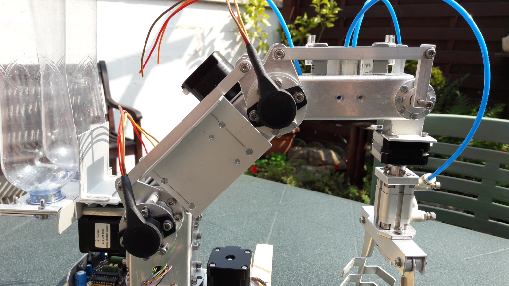

For a contest in the robot club, we need to collect 5 cola cans,
and bring them to the base station.
So, I'm building a robot arm, with a pneumatic gripper for that,
yes I know, it is much to complex for that task, but it is fun to do, and I learn a lot of robot arm control.
Like you say, its the path to the goal who is the fun ...
Also for the Inverse Kinematics I need lots FP calculations ...
I'm thinking using a Teensy 4.1 for this, this MicroController have a hardware FP core in it.

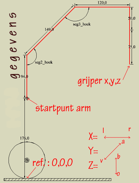

Thanks for the posts,
But, I need some help,
- For my robot arm, if segment2 (150.0 mm) and segment3 (120.0 mm) are in linear position,
the max. distance from the robot arm base, will be 150.0 mm + 120.0 mm = 270.0 mm
- If I want a resolution in the motion of the Zaxis rotation (top view)
that will give me a circumference of (2*pi*radius) = 2 * 3.14159 * 270.0 = 1696.460033 mm
- my steps will be, at a resolution of 0.1 deg
360.0 deg/rev / 0.1 deg/step = 3600 steps/rev
- The resolution on the max robot arm distance will be,
circumference / steps/rev = 1696.460033 mm/rev / 3600 steps/rev = 0.4712 mm/step
- for my data of cos()/sin()
Q) can I use a resolution of 0.10000 deg/step with a 16 bits floating point data
I don't know that I'm in the good direction with my calculations ??
And its all new for me, a floating point calculation with a 8 bits CPU.
I just love it, is a new challenge, so ...
Controlling all with one 6502 CPU at 4 MHz and a 6522 VIA.
PS: I found some older EPROMS 27C2001 (256 KB) and 27C4001 (512 KB)
Thanks,
marc
Sorry for the picture, it's all in dutch,
gegevens = data
grijper = gripper
segment 2 = old data = 149.0 mm, now = 150.0 mm

Re: My new 6502 robot project ...
As a quick reaction, it sounds to me like you need 16 bits of precision.
You might be able to do without floating point, but if you do use it, you've moved some difficulty into the building of the floating point package, and removed some difficulty from the user-side calculations.
So, three-byte floats might be enough. MS Basic can be built with either 4 or 5 byte floats, so probably either of those would do. Just possibly that existing build-time flexibility could be used to make a 3 byte version, or possibly it's not something you'd like to do.
VVV
1696.460033 mm
.000400 mm <──wavelength of violet-colored light
.000700 mm <──wavelength of red light
(the two ends of the visible light spectrum)I highly doubt you really need resolution that's down to 1% or less of a wavelength of visible light.
...<snip>...
...<snip>...
16-bit scaled-integer can give you nearly 20 times finer resolution. No need for floating-point. But please read the tables front page linked above. Scaled-integer is not fixed-point. Scaled-integer is much more flexible.
I like your robot arm.
I have built several robots. The languages include C, C++, Forth, and assembly. In C/C++ I use the float data type and associated C-RTL trig functions. But these can really bog down a microcontroller because there's a lot going on in the C RTL.
When I use Forth or assembly, I only use 16-bit scaled integer arithmetic. I've done inverse kinematics for a robot arm using Forth. I tried CORDIC for trig functions but concluded lookup tables are faster and EEPROM space is plentiful.
For my latest robot arm I built a serial relay on the microcontroller that lets the host PC send commands directly to each arm joint. The host PC can do the heavy lifting at that point.
