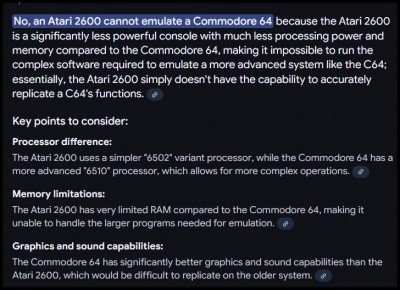

AI perspective
AI perspective

That’s not emulation, as the Atari 2600 doesn’t have the sound and graphics hardware of the C-64.  At best, I might call it a simulation.
Incidentally, the AI diatribe mistakenly implies the 6510 in the C-64 has more capability than the 6502.  Both MPUs have the exact same instruction set.
The diatribe doesn't say that at all. The 6510 does have more capability than the "simpler '6502' variant" processor.
The Atari 2600 uses a 6507.
The key differences being-
  • Address lines: 13 vs 16
    Addressable RAM: 8K vs 64K
    Internal IO Ports: 0 vs 2
    IRQ pins: 0 vs 1
    NMI pins: 0 vs 1
    AEC pins: 0 vs 1
Same instruction set and similar internal structure, but that's where it ends.
