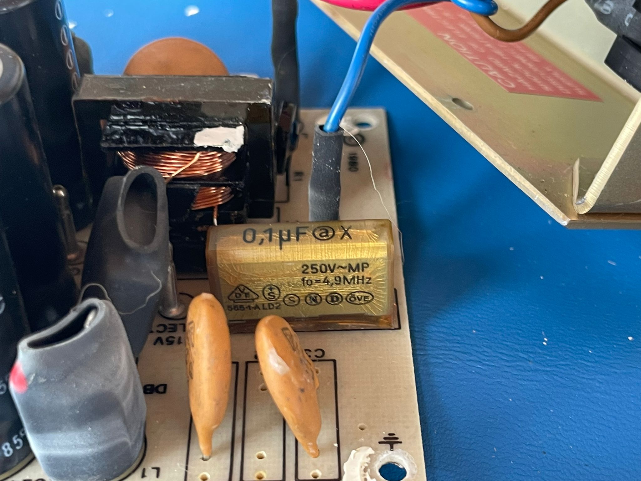

Before I start up my old AppleII, is it better to replace the old capacitors, or just start up and see (smell) ?

At minimum replace the RIFA cap in the power supply. It will blow and make alot of burnt butter smell as well as smoke. I pulled my dads AII plus from his garage rafters and used for a few days and then walk back out in the garage where I had it my house. Luckly it was in the garage and not in the house so the wife didn't get PO'd. It lingers for a few days.
The cap is on the power in mains across hot and neutral. I never replaced it but this reminds me to order one with the next Digikey order.
It is used to filter out PS switching noise from the AC connection going out. It is the long yellow device in attached pic.
https://www.reactivemicro.com/product/r ... er-supply/
Greg
Greg

You can just remove the rifa for now and order a modern 0.1uF "X" type capacitor to replace it.
There is a small electrolytic that sits very near a heatsink somewhere near the middle of the power supply, that very often goes bad. This could be restricted to only some models of the PS, but it has been bad in every one I have repaired. Sorry I can't be more exact right now, but it's a fairly obvious situation and should not be that hard to find. Simply replace any really small electrolytic caps that are quite close to heatsinks. Use the highest temperature one you can find.
I honestly do not think this can be done. A lot of things would need replacing including memory and much of the logic. There used to be accelerators available that "replace" the NMOS 6502 with a CMOS 65C02 and faster memory. They buffered everything and communicated with the Apple II bus at the old speed. Here is a modern example that uses the 65816 and allows access to 16 bit mode: https://www.reactivemicro.com/product/u ... celerator/. A lot cheaper and simpler than hacking up an increasingly valuable old computer.
