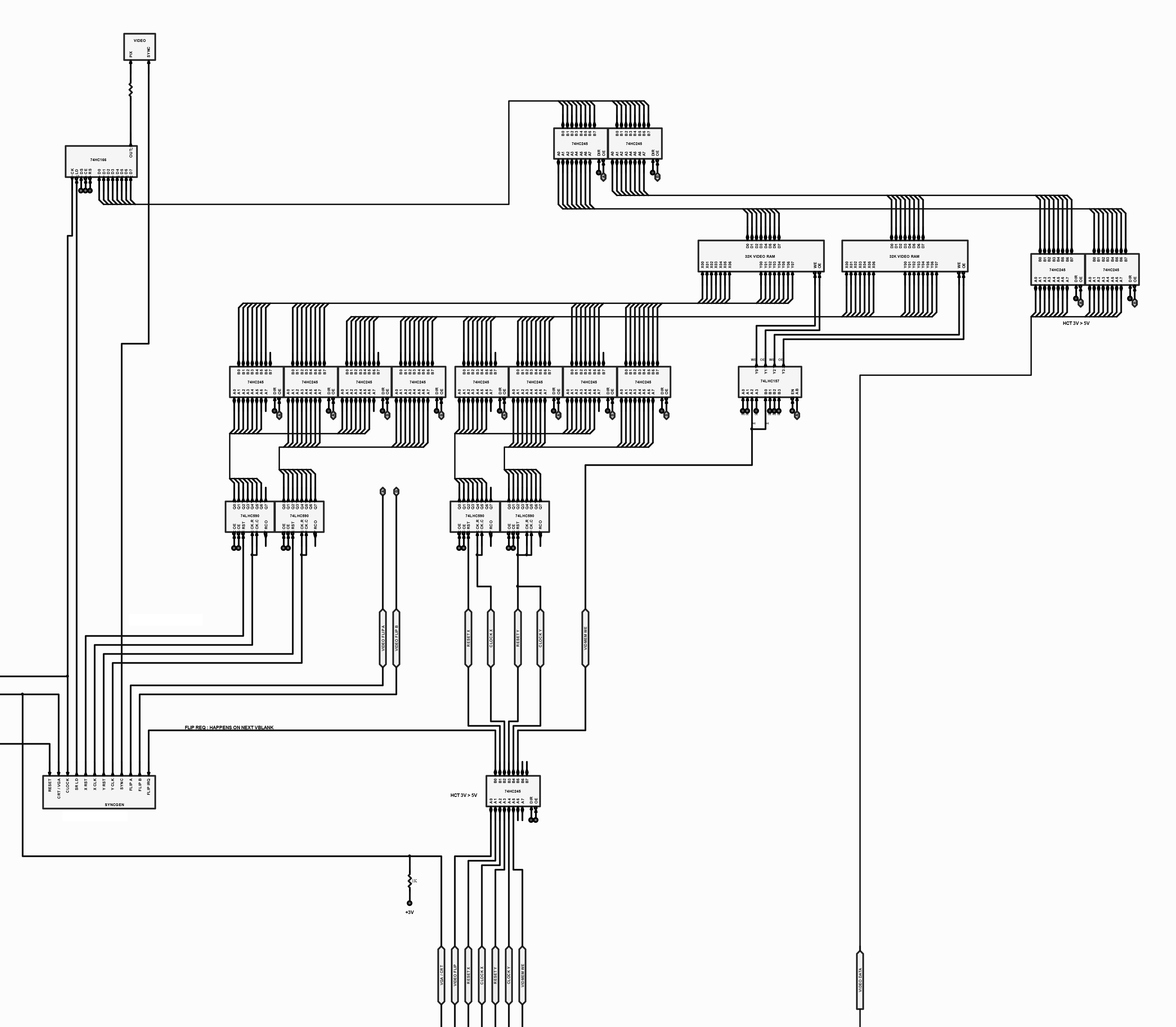

Here is the frame buffer segment of the video circuit.
Nice and simple, but also very fast.
The 6502 writes to the one video memory while the other is shifted to the CRT display.
On the VBlank, the 6502 flips the buffers. This lets the OS continue to work as the SyncGen hammers out the screen.
The SyncGen is made of several counters and 688 comparators.
Dual buffers are probably overkill for this project, but it's not like I am afraid of adding more ICs!
Brad

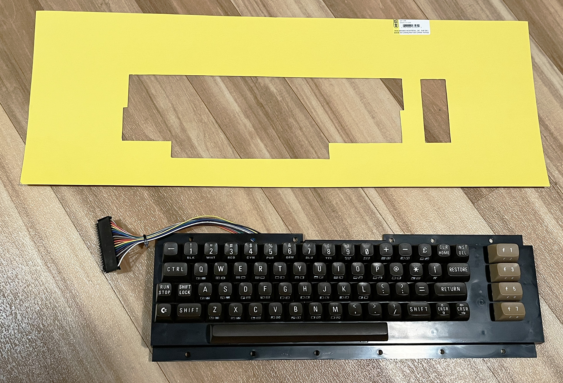

The keyboard assembly arrived today, fresh from the Admiral V20 production line.
What a great mechanical keyboard, and a simple Row + Column matrix interface.
I made a paper template so I can transfer the dimensions to the keyboard front steel panel.
I will hack out the opening with a grinder, keeping inside the lines and then tune it with a hand file.
The function keys will probably be the most used keys with apha keys being mainly for song naming when saving.
Brad
