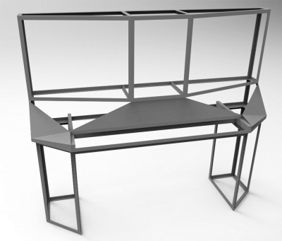

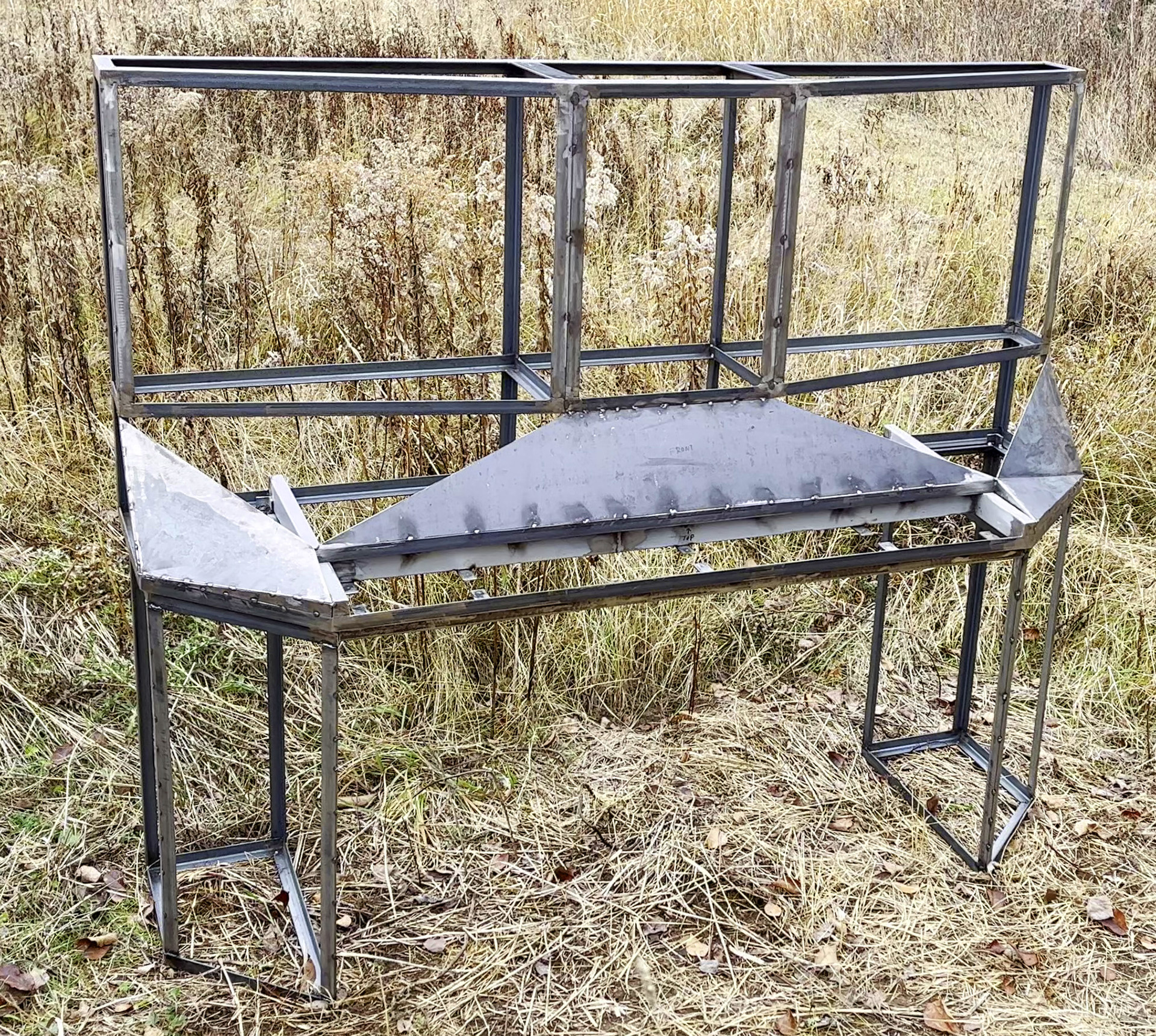

Had another day out in the shack and managed to get the frame for the base completed.
There is a lot of final welding and grinding to do, but the frame skeleton is mostly complete.
If winter continues to hold off, I might be able to complete the speaker area framework as well.
The frame will have two removable pillars that include pull out floppy storage drawers.
Hidden caster wheels will jack up from the underside to allow moving the unit.
The two sections of the stand...
Here is the basic frame ready to rock the back 40...

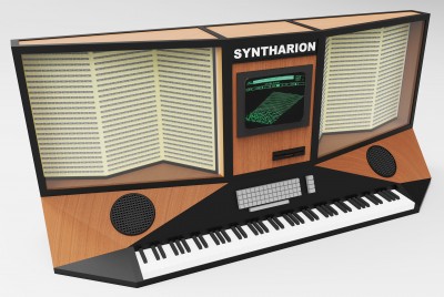

I came very close to the original concept model...

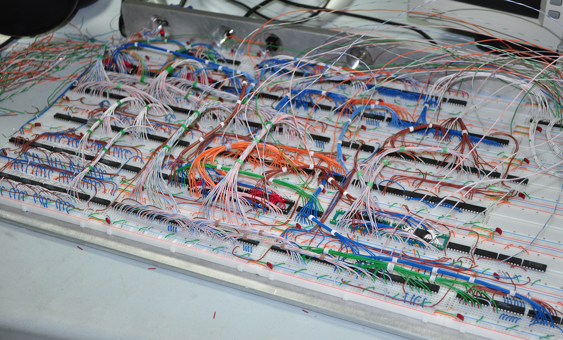

I have also made a lot of progress on the Channel and OS code, which is all 6502 assembly. I can now read data from the 1541 drive used for this project, load basic samples into one channel, and play some basic music. Composite video is also being generated at 640 x 224 and it looks great. It is so easy to run out of breadboards space in a hurry!...
Hard to fathom that what is shown above is only one half of one channel. There are 16 of these!!

That is an _impressive_ amount of breadboard!

That breadboard represents the number of ICs on just one of the 16 channels, and that doesn't include the analog portion.
The video circuit is also about the same size as well.
So what you see in that photo is about 1/32 of what I will be hand wiring.

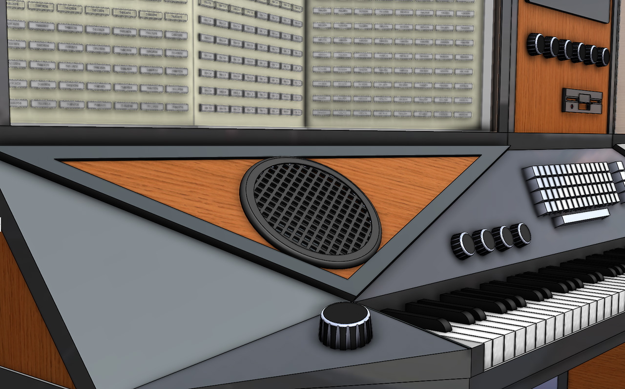

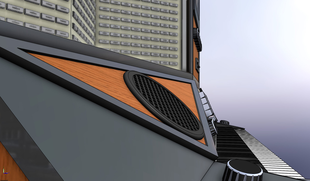

It sounds like BDD was thinking the piano keyboard was at an angle. I guess the angle of the render did look that way.
Here are a few more shots of the unit. The model has been updated to match what I actually built (backwards methods, I know!)
Notice how challenging that CRT bezel is goin to be!
I found some 1.5 inch angle iron and will try to make it tomorrow.
The angle grinder is going to need a lot of finesse to hack out that curvature so it mates with absolute precision.
If all goes well tomorrow, this is what I will have...

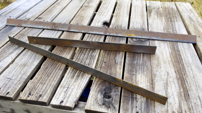

When I went out at noon, I realized I had no angle iron to work with (needed 1.5 inch minimum).
Disappointed, I started cleaning up for the winter and found an old rusty bed frame. Perfect!...

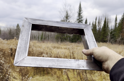

A few cuts and some flap disc cleanup, and I was making the bezel frame...
Whadda ya know, it is exactly what I had envisioned yesterday...
The curvature was hacked out a bit at a time using my usual high precision method...
Not sure why, but this was very easy to do!
It didn't even need to be this close as I will be installing a rubber edge when I can find one to fit.
This is one solid bezel...
