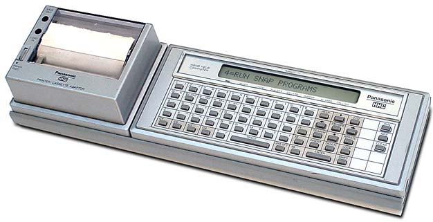

I recently found out that the Panasonic HHC is 6502 based. Maybe not an oddity, but quite interesting.
Re: 6502 oddities from the past..
(Panasonic HHC featured 10 years ago in our weekly posts!)
It was given to us 20 some years ago as a joke wedding gift!
