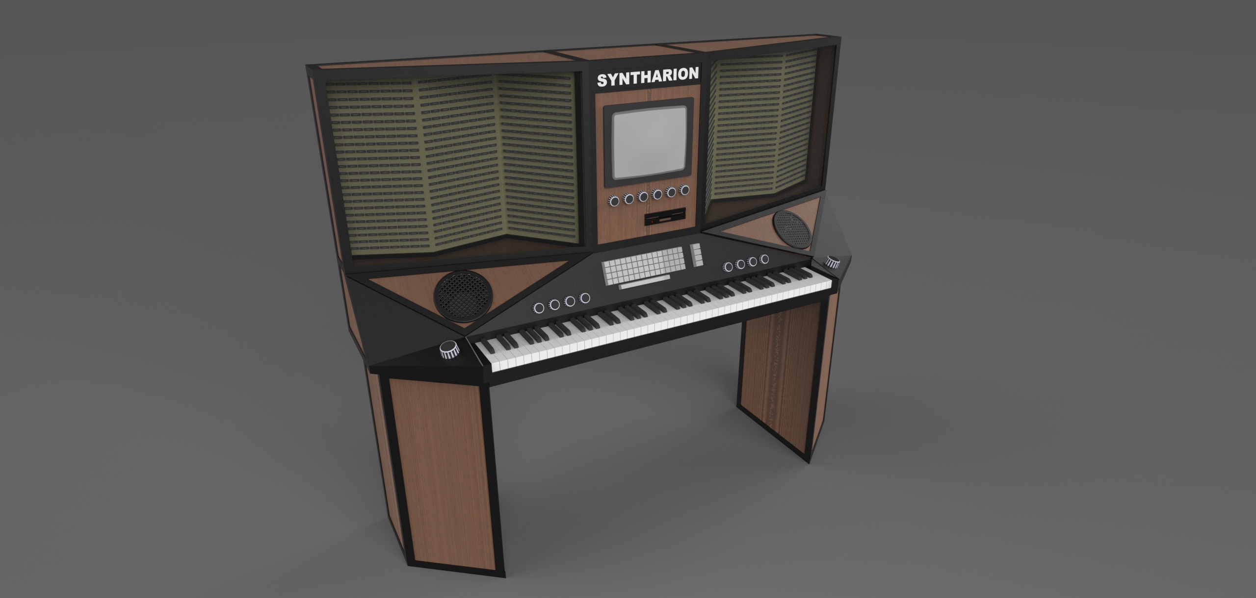

Boring night in a small hotel along the North Shore of Lake Superior tonight.
I wasn't planning on working on the 3D model anymore, but it does give inspiration.
This isn't the final layout of controls, and I may change the speaker grill design, but this is probably close to what the final Synth will look like...
On my way home I am stopping at the hardware store to get the four 5 inch casters so I can finish the rolling stand this weekend.
Next parts to acquire will be the front glass panels and a source of 1/2" thick cherry wood or mahogany for the trimmings.
Not sure what wood these 70s and early 80's synths had, but this is the look I am going for...
I can't wait to connect the keyboard up to the protoboard and jam out for a while, even if it's just on a single channel for now!
Later!

The LucidScience Musical instrument Company has commissioned me to also make a desk style stand instead of the typical tubing style keyboard stand.
This will have lockable 4 inch floor safe casters as well as pull out drawers on each side that double as 5.25 inch floppy disk organizer for all those sample disks.
Design work will start soon.

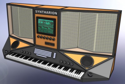

Not much to report on frame development as I have been busy with work.
It was cold and rainy today, so the outdoor welding shop was closed.
I did manage to work out the basic frame for the stand that I am going to make.
This will use up the last of the angle and flatbar that I have sitting around.
Basic renders, not showing the pull out floppy disk drawers yet....

Do you have any diagonal bracing in or between the pillars?
Oneironaut
Posts: 734
Joined: 25 May 2015
Re: Vulcan-74 - A 6502 Powered Retro MegaProject
Post by Oneironaut »
Yes, at the back there is a cross brace which is not shown in the render.
Casters also jack up from inside the pillars to lift the unit 1 inch from the floor for moving around.
Pillars also sit in channels under the unit for centering.
