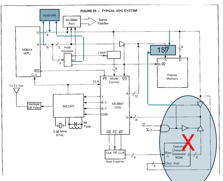

Looking to use a 6847 on a project, and wanted to try to use the external ROM for characters noted in the datasheet. But, I am confused about how to feed some of the character ROM address lines (the 8 that appear to be coming from the Data bus, but that does not make sense to me)
Anyone ever used the external ROM on the 6847?

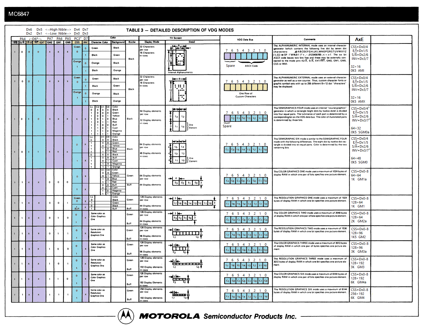

Hello Jim,
Maybe these (compiled pages from a datasheet) will help:

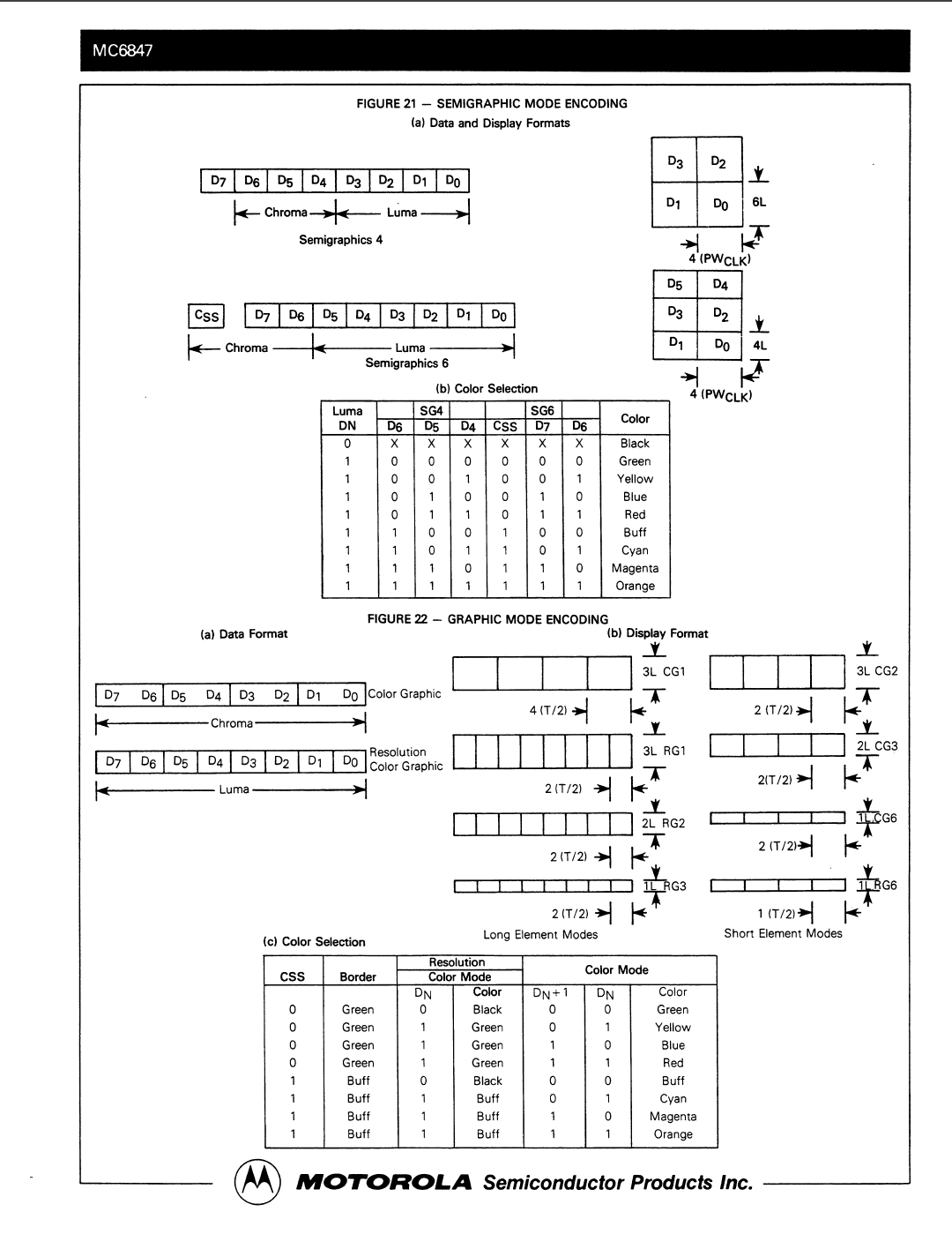

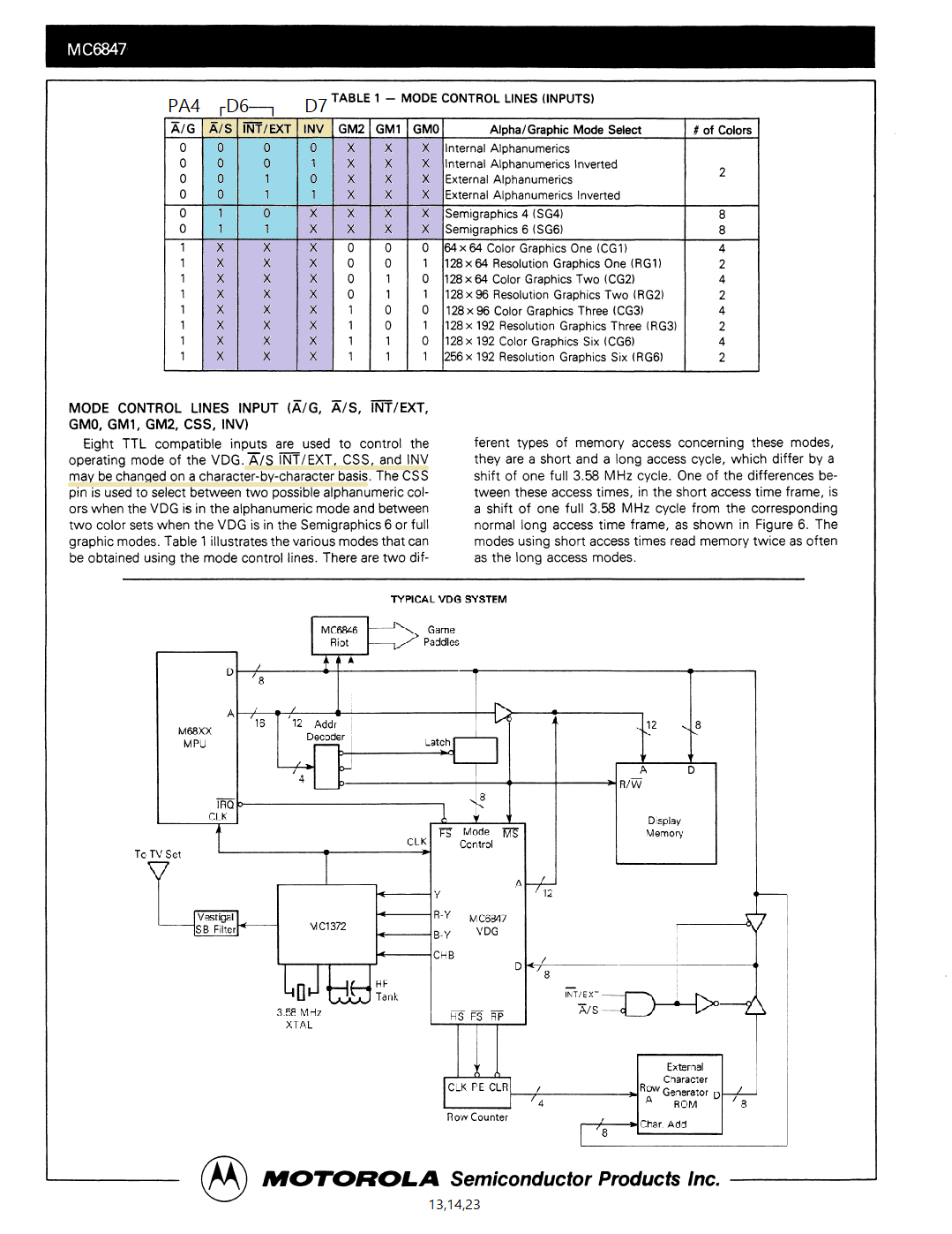

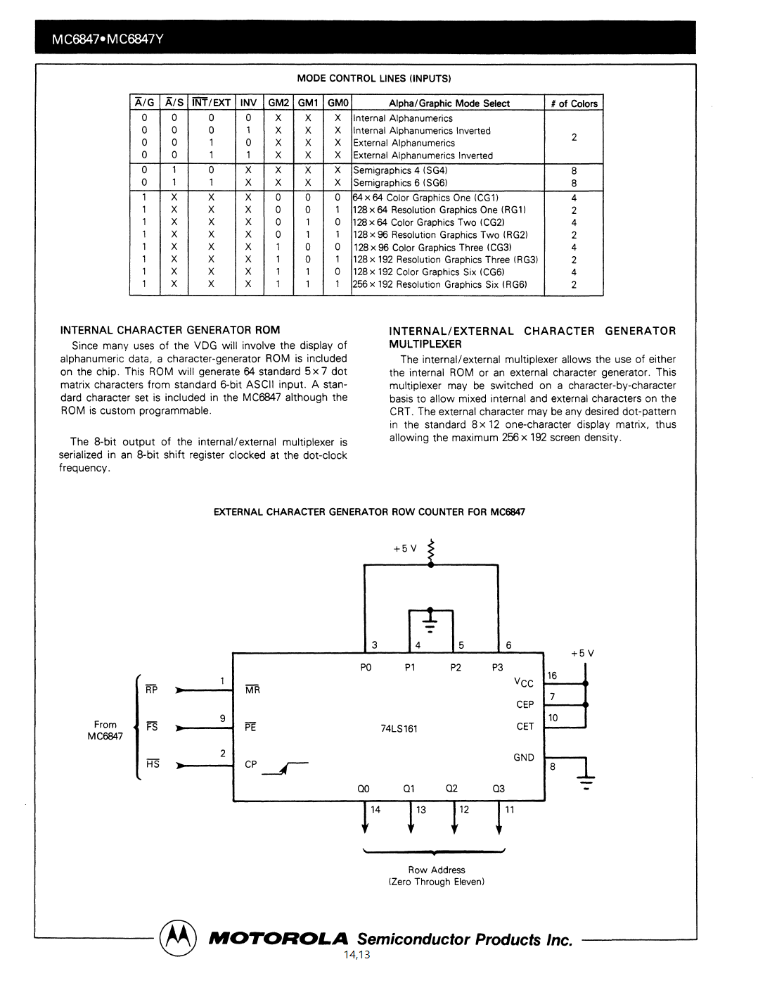

6847 Mode Control Lines (Inputs) - External Character Generator Row Counter.png
6847 Mode Control Lines (Inputs) - External Character Generator Row Counter.png [ 220.02 KiB | Viewed 405 times ]
6847 Typical VDG System - External Character Generator Row Counter.png [ 141.08 KiB | Viewed 405 times ]

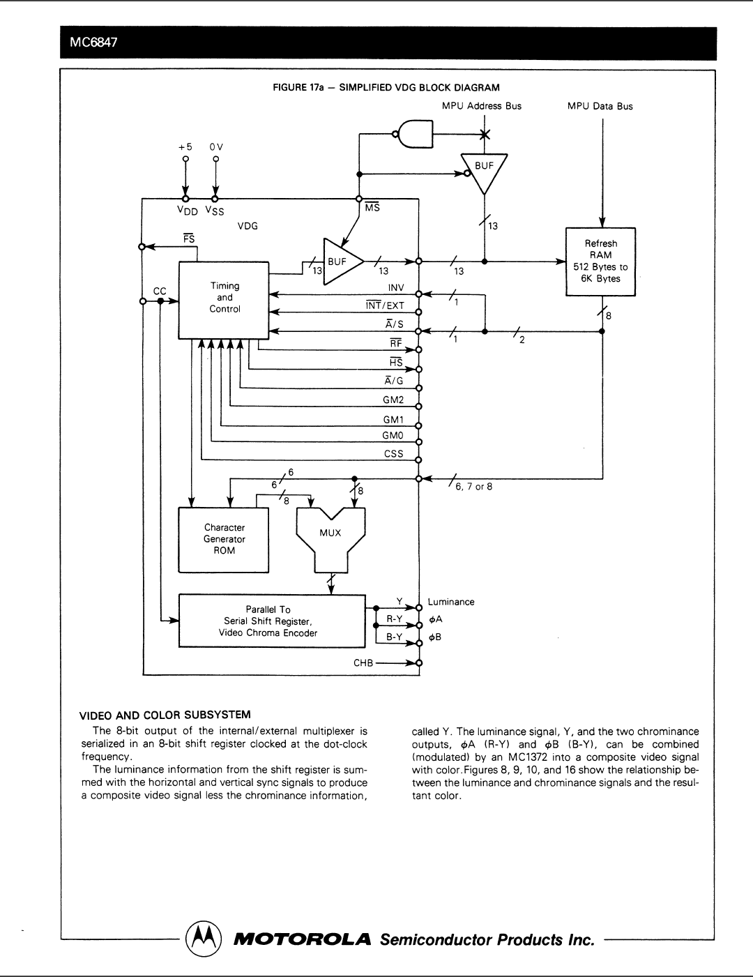

Gr :D :D tings, Louis

I have used the 6847 before, but not with an external character ROM. I assume you are referring to the schematic figure 23 in the data-book? It may be a little confusing but data lines coming from the display memory need to be connected to the address lines of the character generator. The address lines from the VDG are feeding the display memory to select the memory cell containing the character to display. Then having the character to display on the data bus, it is used as an index into the display ROM. There are tri-state buffers to isolate the CPU data bus from the output of the generator ROM.
It saves 3 or 4 chips to use the VDG’s internal character ROM.
I think the Y, R-Y, and B-Y signals can also be used without the MC1372 via voltage comparators to generate RGB signal levels. It may be possible to interface to a VGA connector. I sketched up a circuit to interface to a monitor a while ago which I may still have somewhere on my computer. I never got around to trying it though.
Another solution for using an external ROM, may be to mutliplex the data bus into the address lines of the display memory. Part of the display memory would then be for a programmable character set. The character set could just be stored in a ROM connected in the ordinary fashion, and software used to load the the display memory appropriately. It may be fewer parts if the character set is stored in the system ROM.

Thanks, but I already pored over the data sheet (downloaded). However, Rob Finch's comment about the data from the regular memory (which is addressed by the VDG) being used as the top 8 bits of the address for the external ROM makes sense to me. I was trying to determine why data lines would be used as address lines.
Thanks, that made it click. I was trying to determine why data lines would be connected to address lines. It makses sense now.

I see 2 '157s (which are the buffers showin the diag), an '86 (which could replace the NAND gate in the design), an '04 (the inverter in the diag, though an '86 could also be used), and a 749X (maybe a 7493, replacing the '161 that needs to be the rest of the address bus), but then a 7473 (?) and an unnamed IC (maybe a 7492 divide by 12, since the 90 can't be preloaded). The '73 seems odd as I don't see it anywhere in the schematic, unless it's part of the 7493?/7492? counter/reset (not sure why they would not just use the preloadable '161 as shown in page 14 in @Louis.m's atatchments.
Maybe it's that the LowerKit designer did not understand the '161 idea, or they wanted the ROM laid out a different way (to use the std way shown in the 6847 datasheet, I assume the lower 8 address lines would go to the data bus lines "the character", and the upper 4 address lines would go to the counter. So, the first line of the first char would be at 0, the second line at 256, etc. Not sure it saves anything, though, as 256x12 is 3072, and 256x16 is 4096, and ROMs never came in 12x256 sizes. Thus, you're wasting 1024 bytes either way. And, it's a ROM, so not sure anyone would care how the data is stored there (obviously if it was RAM, you would).
I think it is more likely that the lower address bits are connected to the counter, and address bits 4 to 11 of the ROM connected to the data bus. That way the first row of a bitmap is at address 0, the second at address 1, etc. Each character would use 16 consecutive bytes then. The FF might be to control one of the other signals on the 6847 like the alpha vs graphics signal. Or to disable the external ROM.
Using a couple of adders on the address lines would allow the ROM contents to be packed. (The character number could be multiplied by 12 using adders, then added to the counter, but that may cause timing issues).
