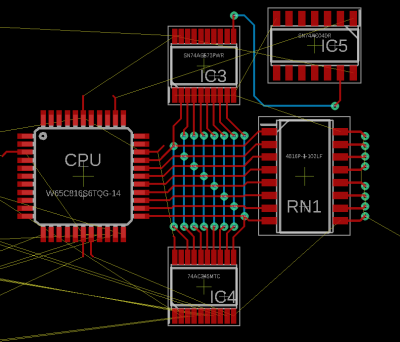

There were a few other reasons I didn't bring up as to why I didn't want to use that module, not just price. I just wasn't sure how to say it without sounding like I was stomping all over the modules you were suggesting at the time.
It honestly sounded like overkill if I could run an entire 65C02 on it and have room left over for a video processor. It felt like that FPGA would have tempted me to put too much of my system onto that when I wanted the focus to be on the real 65C816 running it. Part of why this thread also asks about the viability of using a second 65C816 to run the graphics instead, which I'd still prefer over an FPGA. I'm just still early enough in my research that I don't know if this is an option.
In the case where I'm not using a second 65C816 to run the graphics, I wanted an FPGA that would be a stand-in for an ASIC since I don't have the resources for designing/manufacturing a custom chip. I still wanted it operating within the limits of being a dedicated graphics chip for a handheld of the 16-bit era (since no one makes 16-bit VDPs anymore.) Those modules sounded like overkill. I already felt like I was cheating a bit using an FPGA, but that looked like it would have been taking it further than I wanted to go since the entire hypothetical system could be run off it alone. At that point, all the fun in this project is gone for me and I'll go back to making games instead of hardware.
Your suggestion does have some merit I haven't written off, though. A module with an FPGA would help with prototyping because it would be easier to reprogram than pulling the chip and sticking it in a programmer, sure. I just want the end product to look like something that could have been made in the mid to late 90s with parts that are at least (acting) in spec to what was available then. Maybe I'm making this more difficult on myself than I need it to be by doing that? I likely will try to package the FPGA I want to use into dev module (if it's not already available as one, haven't looked yet) for breadboard prototyping, though. I just don't want a USB programmable module on the end product if this project gets that far.
The budget issue is that my current LCD takes up almost half my parts budget at a whopping $45 out of a $100 parts budget (not accounting for things like shipping, breakout boards, etc. Just the components I would to solder to a PCB if this project gets that far.)

Part of why this thread also asks about the viability of using a second 65C816 to run the graphics instead...
Not fully understanding your objectives, I’d opine that it is likely a 65C02 or 65C816 running at 20 MHz would not have enough horsepower to manipulate the frame buffer an acceptable rate.  Using the 816 as the example, the best throughput it can achieve at 20 MHz, using MVN and/or MVP to shift bytes around in the frame buffer, would be ~2.79 MB/second.  While that may be fast enough to manipulate a monochrome frame buffer—or possibly a 4-bit color setup—with reasonable alacrity, I don’t think it will cut it with 256-or-greater color depths.

VHDL/Verilog were things I was planning to learn as part of the journey to making this system since it's looking like running graphics on a second 65C816 isn't going to happen unless I can manage clock speeds that would likely fry it without external cooling. I will probably ask for help from people more knowledgeable to help get this done right along the way, though it's going to be more "can someone double check my work?" than "how do I do this?" type questions, things I've tried to do myself first but can't get working or not well enough.
I don't have the resources to hire engineers or marketers and I will not turn to crowdfunding until I have at least a working prototype and am looking to produce them at scale. If anything, I'd be setting aside my own money to pay a few hobbyists for their time to help me program the FPGA display chip, boot ROM and development tools. I just want to have a semi-final hardware plan in place. I can do PCB design and even have a 65C816 with a de-multiplexer setup for the upper address pins in EAGLE right now (see attached, also to help me make sure all the parts I'm throwing in my Mouser project list actually fit in the size I want this to be,) but most of that prior experience is just designing or modifying flash cartridges for existing game systems.

That was the conditions I was setting myself for using an FPGA for graphics. I may even experiment with different FPGAs if I find the one I'm currently looking at is overkill. I figured a $7 Lattice FPGA was a good starting point. I know what I'm aiming for in terms of graphics capabilities, just not how to get there yet.
I don't really have plans to go as far as a Kickstarter or any kind of crowdfunding platform or starting a business off these as I don't think there's that big of a market for a new 16-bit game system, but I haven't written them off. Just not optimistic enough to see a need for those. This is just a hobby to me. If it is one that breaks even or helps pay for itself just a little, I'll call that a win. If I get as far as a playable prototype and there's serious interest, I might look into making more or publishing resources for people to build their own. The goal was to keep this along the lines of a 16-bit system. Graphics/audio comparable to an SNES or Sega Genesis, but in a handheld form factor.
I guess the better way to put this is that I don't really have an end goal, per se, more of a "see how far this goes" approach with multiple jump off points depending on a combination of my own motivation and demand for such a product:
First stage is the "I give up" point where I decide this project isn't possible with my time/resources or just won't become what I want it to be. Should it reach that point, I intend to make all notes/files/designs related to it available in case someone else wants to take over where I left off (probably under an open source license.) This would be me hoping that I put in enough work to inspire someone more talented to take a swing at it.
Second stage is a working prototype (breadboard and eventually its own PCB) that I can package into a 3D printed shell and show off and publish design files for (again, open source.) Likely to remain a small hobbyist thing since I don't see much demand for a pseudo-retro game console. Might sell kits with all the parts people need to assemble one on a web store.
Third is if that working prototype shows a lot of demand, I might look into getting the design refined for manufacturing and see about a limited run through a crowdfunding platform as pre-orders. Maybe distribute a few with homemade games to local used game stores, maybe a few convention dealers.
Fourth is if this thing somehow catches any large scale appeal and getting a more serious production run made.
I would start off simple and get a feel of the hardware/software challenges. Pc boards are so cheap and basic hardware is cheap that iterative approach can be fun yet cost effective. In my exploration of 6502 world, the most costly component is W65C02. Everything else is cheap by comparison. I’m doing VGA graphic with cheap CPLD, so FPGA seems overkill. Anyway, the sort of high resolution color graphic FPGA can handle seems out of balance with what 6502 can reasonably manipulate even at 25Mhz. Balanced designs based on 6502/65816 are necessarily cheap. $100 seems very reasonable goal.
I have been considering trying to break this down into simpler stages or smaller side projects to see what I can/can't do on my own and help learn along the way. I might even see if I can find some open source 65C816 computer designs or kits to mess around with to get a better feel before I order parts for my own system. I am jumping into this with very little knowledge outside of how game consoles manage their memory and an understanding of how computer components work and C programming knowledge. I will likely see if I can make Small Device C Compiler or WDC's own tools to work with me to get 65XX binaries for this so I don't have to learn assembly (I struggling with shorthand and abbreviations and assembly is nothing but shorthand, so I struggle to even read it.)
The $100 parts budget means that, if I get far enough that I have something to sell, I might be able to save money on bulk orders on parts and sell the system as a DIY kit for $100-$150 (components, PCB, shell, etc.), though I was hoping to sell a completed system would be closer to the latter price of $150 (even if that's very optimistic.) I want to get the barrier for entry on these as low as possible both to play them and develop for them. I may even go down to a 2.8" LCD (I wanted 3.2", but the manufacturer I was looking at doesn't offer that size) to get the price down further. Theoretically, the LCDs I'm looking at are all the same at the controller side of the ribbon cable, so making shells for each size of screen is possible and making cheaper kits for smaller LCDs available.
