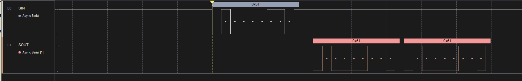

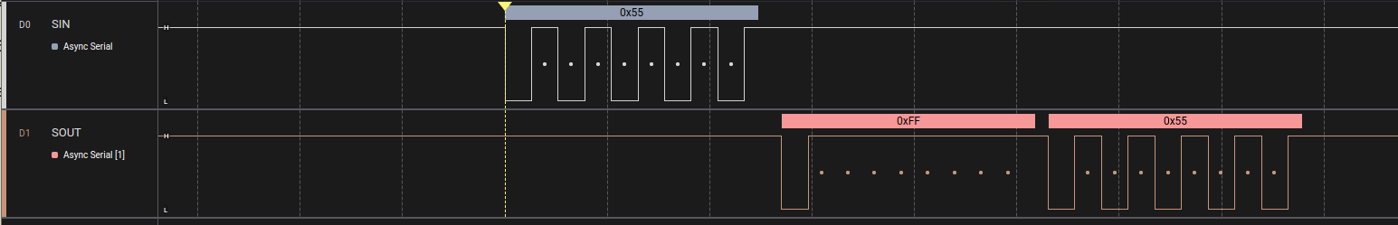

I've attached two images showing a logic analyzer capture of the serial lines. In one, it's clear that the letter 'a' was typed, but the output was TWO 'a' characters. Sometimes they appear as 'aa', others as 'Aa'. It gets weirder with other characters such as 'U', which outputs a 0xFF plus the original 'U' character. I've attached the captures as images to this post.
To me this smells like something to do with flow control, but I've gone over my code many times and I can't pinpoint the problem. I'm hoping someone here might have had the same experience, or can immediately spot what is happening.
I've probed the RD and WR logic, which works just fine with the attached SRAM, and I can verify that I am receiving the character correctly as well as transmitting the same single character to the 16550. Something in the chip is wonky. I've tried three different 16550s, and each display the same issue. It's not completely unheard of to get a bad batch of chips though. I've also as a last resort attempted to set up a small delay between character transmits, to no avail.
Anyway, any pointers would be very well received. I'm open to trying anything. My code (using ca65) is below.

File comment: Capture of the letter 'a'
File comment: Capture of the letter 'U'

For future reference...all of the issues I had were caused from enabling the FIFO. I didn't realize that by leaving the FIFO disabled it would work character-at-a-time.

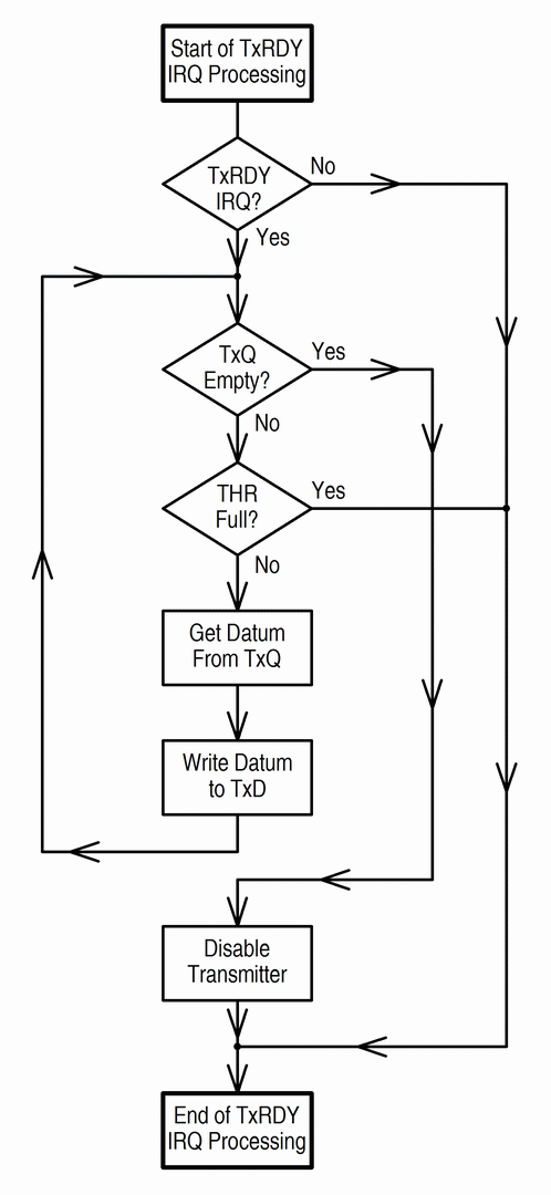

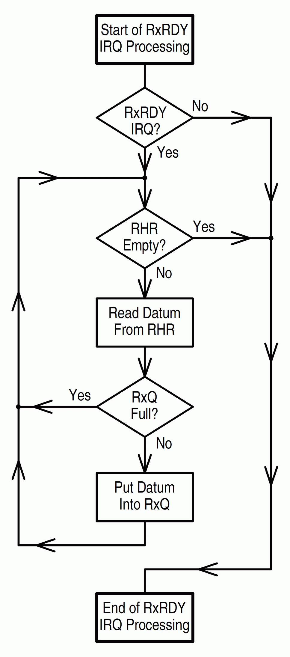

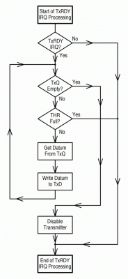

FIFO usage isn’t at all difficult once you understand the principles—it’s a simple looping operation in assembly language.
File comment: Receiver Access During IRQ
File comment: Transmitter Access During IRQ
The 28L92’s FIFOs can be configured to be 16-deep and the device can be set up to interrupt at one of several fill levels.  I have my receivers set to interrupt when there are 12 or more datums in the FIFO, which tactic minimizes the risk of a data overrun (as does use of CTS/RTS handshaking).  I have the transmitters set to interrupt only when the FIFO is empty, which makes it possible to load 16 datums into each transmitter in a single interrupt and then go on to something else.  Can you say “greatly improved transmit throughput?”  :D
Judicious use of the FIFOs will substantially reduce interrupt activity and enhance overall system throughput.  I can simultaneously run all four serial ports on POC V1.3 at 115.2 KbpS in both directions without bogging down the machine, even at the relatively slow Ø2 rate of 4 MHz (usually, Ø2 is 16 MHz).  Efficient eight-channel serial I/O using the 28L92 (four of them) is possible in a system running at 8 MHz or better.

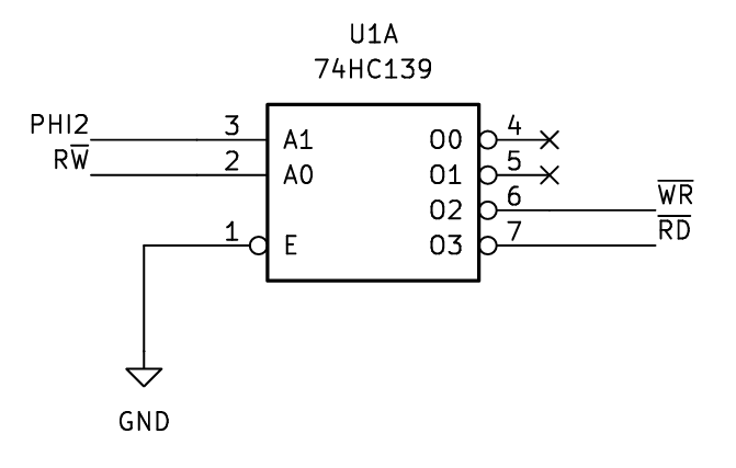

I did not qualify anything with the VDA and VPA pins, all I did was swap the 6502 with the 65816 in my bread board. Mostly as an experiment to see if it would work.
That being said, the read/write signals are coming off of a 74HC139 which is using PHI2 to gate the RD/ and WR/ values.
I'll take a gander at the VDA and VPA pins.

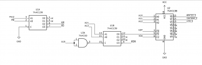

EDIT: Ignore the fact that the schematic says "LS" I forgot to change it when I was quickly drawing that up in KiCAD, I am in fact using an HC part in that circuit.
EDIT2: Corrected diagram:
(This is what I get for going fast..... >_< )
PostPosted: Thu Sep 26, 2024 10:51 pm
Posts: 8504
The 74HC139 is a little on the slow side for that particular use, but is probably okay.  On the other hand, with no VDA qualification, there’s an excellent chance the 16550 is being adversely affected by false bus cycles generated by the 65C816.  You’d have the same problem if there were an NMOS 6502 in the circuit, as without VDA and VPA qualification, the 816’s bus behavior is like that of the NMOS part (something that Apple demanded of the 816 to support their stupidly-designed disk subsystem).
Mmmm.... lovely.
Yea, the 139 & 138 are the parts I had on hand when I built this along with the 8KB ROM, it worked out well.

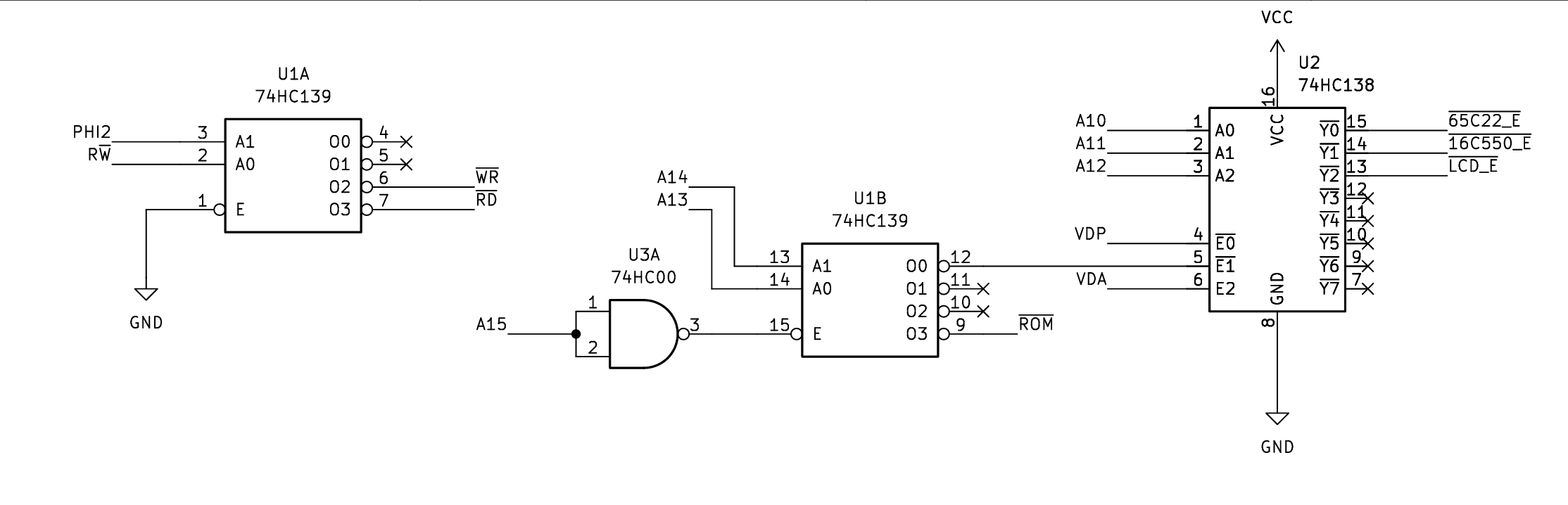

The 16550 is still very unhappy with this even with the qualifications though. The little LCD is quite happy with things though, so I'm fairly sure the wiring is right.
Here's the revisions (complete with both the 139 and 138)
May have to break down and get some 1508s.

The VDP connection on the HC138 is not doing anything useful for you.  The 74HC139 used to generate /RD and /WD is likely keeping those signals asserted too long after the fall of the clock.  I suspect (without seeing the circuit running on the bench) that your timing is too skewed relative to Ø2 to produce reliable results.  Can you try replacing the 74HC hardware with 74AHC?
PostPosted: Fri Sep 27, 2024 7:07 pm
Posts: 257

I finally threw up my hands and broke out the 44 LCC breakout board and hooked up one of the SC26C92s I have.
Got that working just fine with both the 6502 and the 65816.
At this point the CPUs @ 2MHz are just blasting the characters so fast it's overrunning the TX buffer at 1200 baud, no surprise, but easy to fix in software.
(Full schematic will be forth coming once I get it drawn up)
