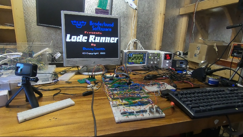

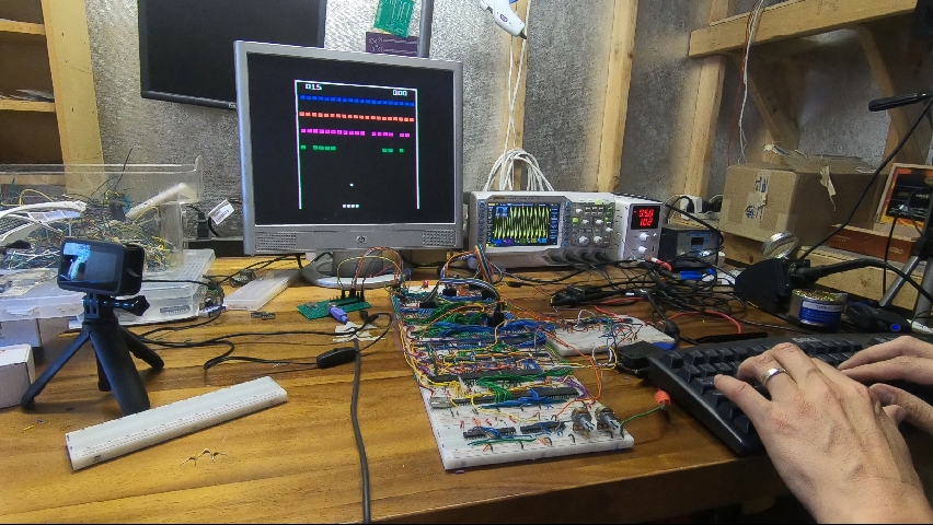

Hi 6502 people, check out my project:
https://www.youtube.com/watch?v=1Ee2avGRPNI&lc=UgxMLm3CwTRlZ5njyRJ4AaABAg

PostPosted: Tue Sep 12, 2023 3:43 am
Joined: Sun Sep 10, 2023 7:30 pm
Posts: 7
Thanks all, happy to be here. 6502.org resources have been very helpful!
Started as a Ben Eater 6502 kit and has gone feral.
Things that I'm ridiculously happy about:
Building a VGA circuit that shares the RAM with CPU at 1.57MHz and works reliably.
Emulating the mind-bending Apple II high-res graphics color over VGA.
Porting the Apple II version of LodeRunner and getting it working on my machine.
Building a 6502 emulator
I didn't start trying to create an Apple II, but I'm definitely moving in that direction - tweaking the hardware design as part of an effort to bring up Ultima IV.
Will be making changes that hopefully will make future other games easier to port as well.
Have to give credit to George Foot who implemented a 6502 fat32 and MicroSD SPI library that I've shamelessly stolen (thanks George)
George's video series and discussions were also very helpful in understanding VGA.
