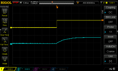

My first goal was to get SRAM working, which was a breeze. I removed the resistor packs that connect Port 7 to the LEDs and soldered a wire wrap line from /CS3 to /CE on the SRAM. Eventually I'll use additional SRAM chips and a CPLD to carve out the memory.
The struggle I have right now is running without the internal ROM. According to the datasheet (and some support from David Gray) if the BE pin is low when /RESET goes from low to high, we are instructing the chip to use external ROM..circuit simulation mode as the datasheet calls it. My thoughts here is that if this condition happens, the internal ROM should be completely bypassed. I'm not seeing that behavior. I'm not sure yet that I just haven't given enough time between RESET and BE going high, or if there is some other thing that I'm missing.
At the moment, I've removed both the /RESET and BE pins from the board - both are lifted from the board and have wire wrap wires connected. I'm using a MCP100 supervisory chip to provide the /RESET signal. There are two lines coming from the /RESET pin on the MCP100, one going directly to the reset pin and one that winds through two gates of a 74ls04, then into a 47k resistor, and then to the BE pin. I've attached a capture from my scope to show what is happening during boot.
What I see is that the internal and external ROM seem to be in conflict with each other...the cpu executes something over and over, but it's not what is programmed on the external flash as I would expect.
Has anyone been down this path before, or someone who knows how to more reliably control the BE pin and leave it available for use after the boot sequence?

Looks like I was too quick to write. @tokafondo has made the point here that the ROM can't be disabled. Oh well.
Given that, I guess I can get the system going with the WDC string in the ROM. Now to see how fast I can push the thing, given I am limited on how fast the chip can start up...
