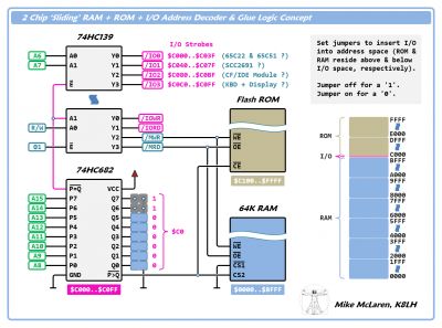

May I share one possible (untested) two chip "discrete logic" concept with capabilities similar to your GAL solution? It uses one variety of the 8-bit Comparator ICs Gordon mentioned along with a 74HC139 dual 2-to-4 line decoder IC to provide RAM and ROM selects, four I/O selects spanning a single (jumper configurable) 256 byte I/O page, and PHI2 qualified /RD and /WR signals. The circuit also uses a 64K RAM and 64K of a 128K Flash ROM and provides more flexibility in the way you partition memory. Basically, you install jumpers to select the I/O page location almost anywhere in address space with RAM mapped below and ROM mapped above that I/O page. Example drawings below.
Good luck. Have fun. Mike, K8LH

Michael, thanks for the diagrams. I was exploring the idea of switching from '688 which I read about in one of your other posts, to the '682 (adding the P>Q flag) and then discovered this post. I know you said it's untested but I had a couple of questions.
1. Here you don't explicitly create a /LO flag so presumably the RAM is enabled at the same time as I/O but relies on MRD/MWR being disabled via the IO select in the '139? Is that right?
2. I thought the ROM normally didn't need clock-qualified read but maybe i'm misremembering, i guess it doesn't hurt?
3. In my current setup I use a '139 downstream of a VIA, with a couple of port A bits wired to '139 inputs and used to select one of several devices for I/O on port B (SD, keyboard, LCD). I like the IO strobe idea - can I read more about that somewhere? For example could I run the '139 in parallel with the VIA rather than downstream and save the port A bits? ie. VIA would be enabled by /IO in a full 256 byte page, with A0...A3 mapping 16 different 16byte blocks to it. Depending on which 16 byte block you accessed, the '139 would determine which device is active on VIA's port B during the access. Am I understanding that properly? I'd have to think about whether the instantaneous nature of the strobe is problematic: I guess the device would only be active during each read/write instruction to a relevant IO address, rather than persistently based on port A? The LCD probably doesn't care. Input from the SD and keyboard are run thru '595 shift registers but maybe that's fine if '139 is just disabling SR output until the via is actually trying to read it?
PostPosted: Fri Aug 02, 2024 2:23 am
Posts: 589
Yes, that's correct...
ROM read operations don't normally need to be clock qualified but it shouldn't matter in that example.
Not sure I understand what you're describing. Sorry.
