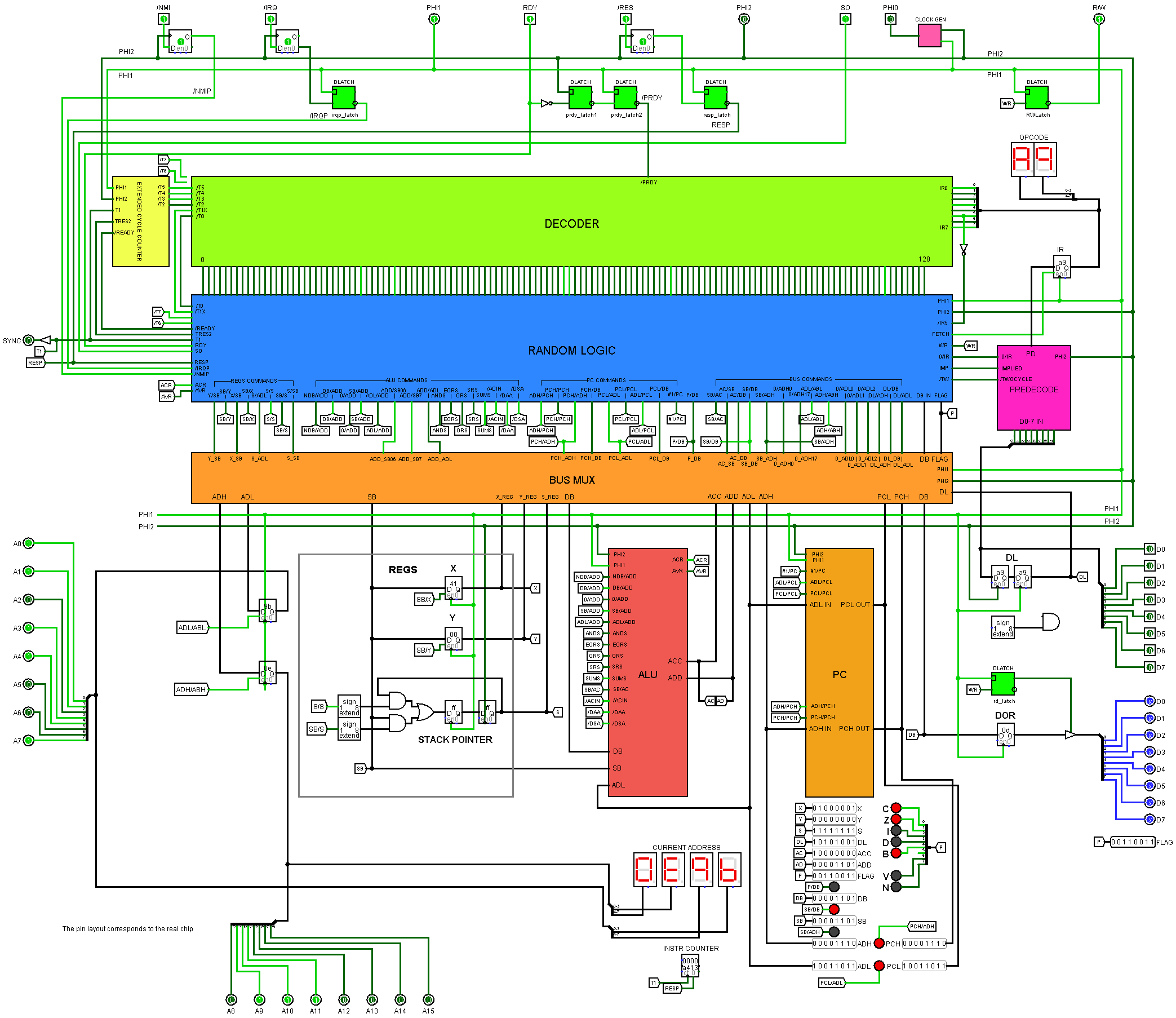

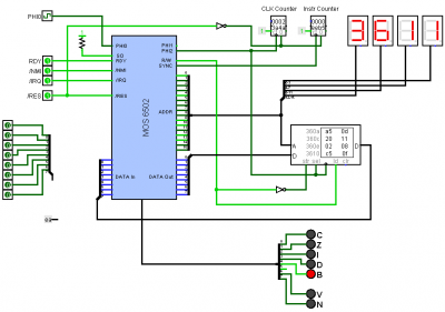

Which version of the circuit is the most recent one, the one currently at GitHub (shown below left) or the one described in the documentation (Breaking NES Book 6502 Core Rev. B4) (shown below right)?
Which is the most recent version?

Both are an approximation of what is actually there.
Logisim does not support bidirectional connections, which are used in large numbers at the bottom of the processor (buses).
The one in the book contains no special "hacks" to handle bus conflicts.
You need to figure out on your own how best to simulate bidirectional connections in your program if it does not support inOut entities (in Verilog terms).
It is best to read carefully what is written on our wiki, I think all questions will disappear naturally :)
