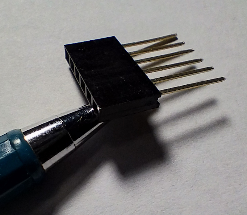

Some of my Arduinos came with some neat socket headers with long pins
which would be perfect, but I don't have enough of them... What are they called ? (No, I'm only half forgetful - remember I've lived and worked in France for ~40 years and some jargon I never actually learned in English...)
Any hints (or links) would be welcome :)

Thanks guys!
I've found a few possibilities at Mouser, mainly from Samtec, similar to the ones proposed by BDD. My worry though is that the pins are 0.6mm dia. (Edit - just saw that they're 0.4mm also) :)
The ones in my photo, and proposed by Barnacle, do work with the DIP sockets that have wide, flat, connection surfaces. At only 0.4mm thick, the pins don't damage the sockets. Unfortunately Mouser don't have those. So I'll order a few samples and see how it all works.

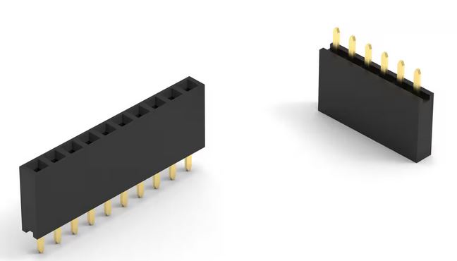

Hi Glen,
for my piggy-back boards I'm using the following combinations.
The shown socket header (I prefer the gold-plated versions) comes with 0,36mm thickness (typical) and fits perfectly into the mentioned sockets. Also, the socket contacts do not get stressed and afterwards, the IC will go back in nicely.
A standard pin header goes into the PCB. When the socket headers are pre-inserted into the socket, it is quite easy to plug/unplug the PCB on top.
Socket Header
https://www.we-online.com/de/components/products/PHD_2_54_SOCKET_HEADER_6130XX11821
THT Pin Header
https://www.we-online.com/de/components/products/PHD_2_54_THT_PIN_HEADER_6130XX11121#61300511121

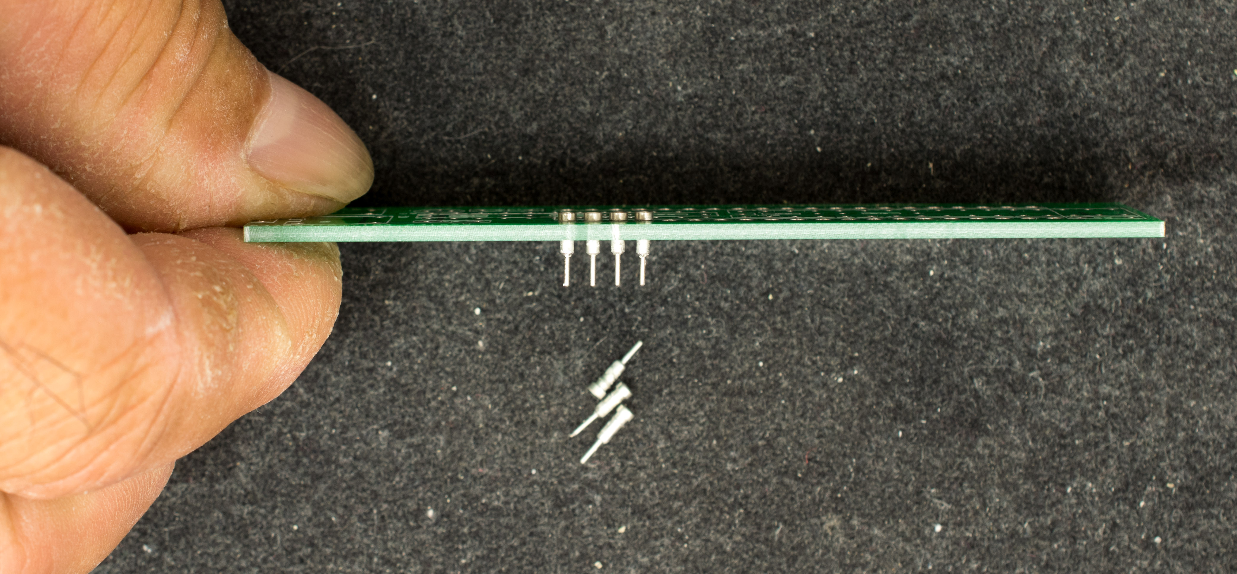

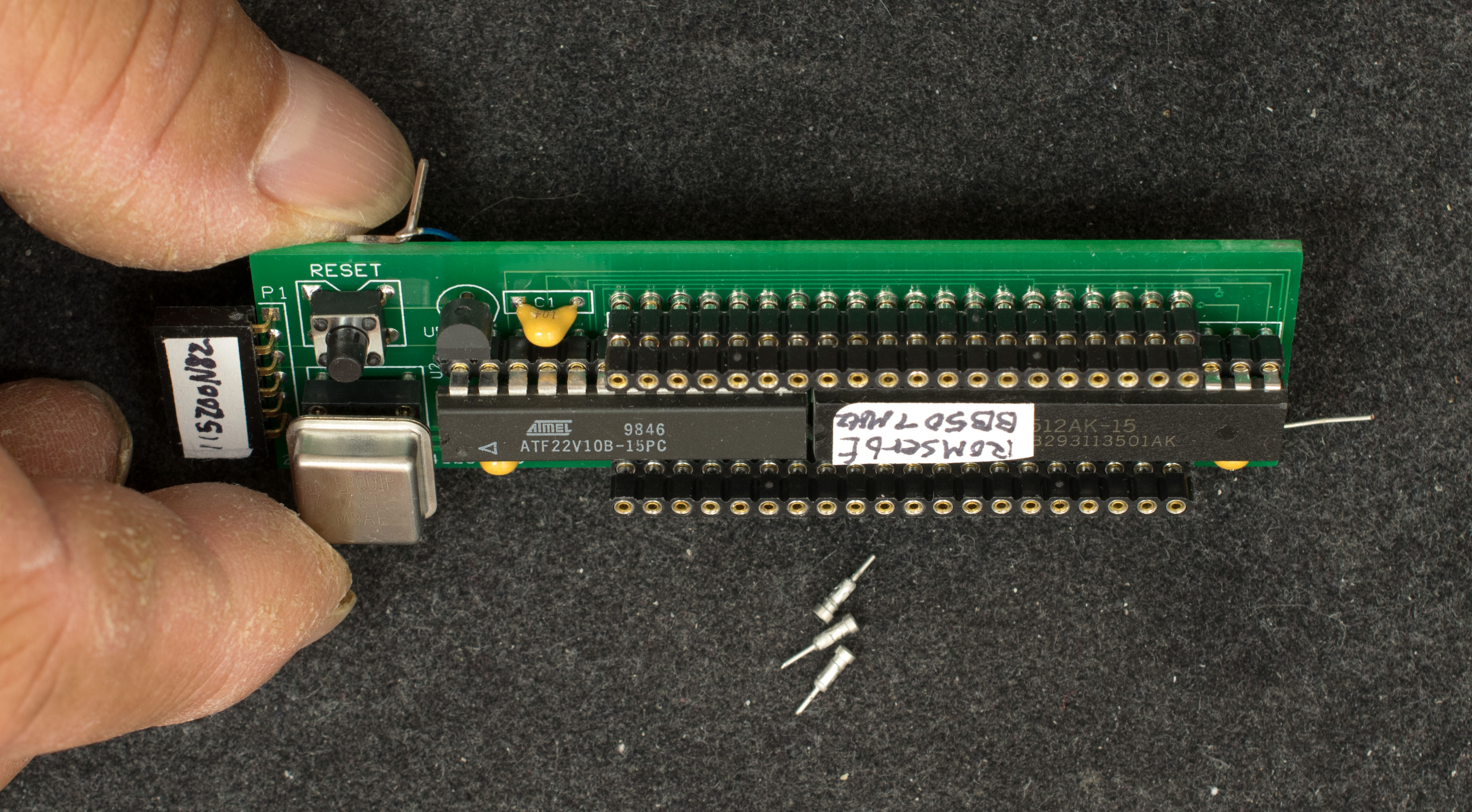

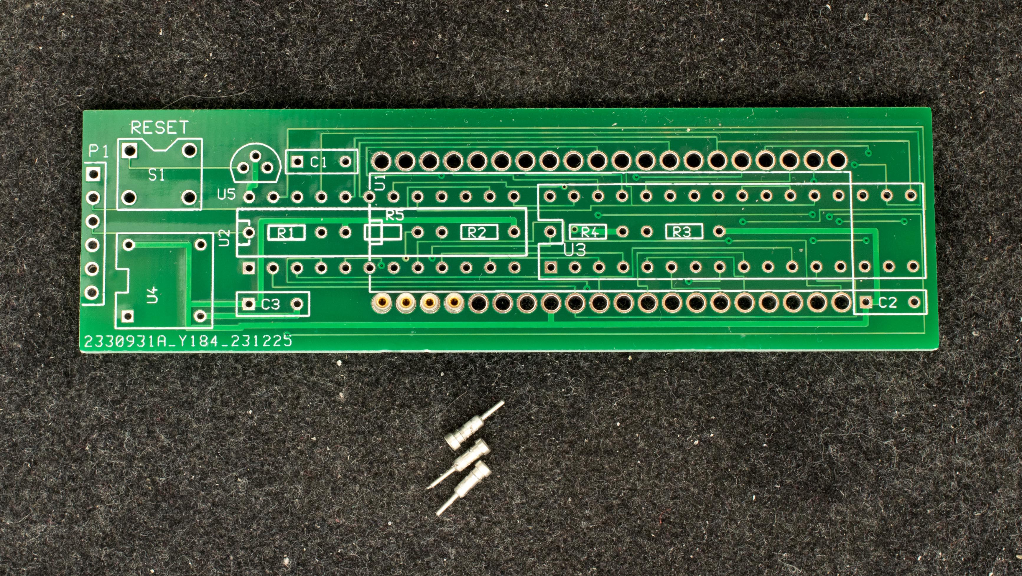

PostPosted: Tue Aug 13, 2024 11:07 pm
Posts: 1108
If you drill large holes, 0.060", for the DIP IC, then you can use the standard machined socket pins that serves both as IC sockets as well as pins to plug into another socket. This is a 6502 carrier board plus RAM and 22V10. The 40-pin DIP for 6502 are 0.085" pads and 0.060" holes to accept machined socket pins up to their shoulder. The pins extended far enough to plug into a 6502 socket below and the socket above can accept a 6502.

PostPosted: Wed Aug 14, 2024 4:54 am
Posts: 844
A source for those pins, please, Bill?

Posts: 1108
I make full-size 4-pin oscillator sockets out of 14-pin machined sockets or 8-pin sockets for 1/2 size oscillator These are pins pushed out of machined sockets. Alternatively you can buy socket strip like this, https://www.ebay.com/itm/253662456287 and push out pins from the plastic holder.
That’s basically the arrangement I used with my new SCSI host adapter.  In order to keep the pins square to the PCB, I mounted the PCB on the POC V1.3 unit and inserted the pins so they plugged into the receiving socket on V1.3’s board.  Then a touch of solder on each pin secured them.
