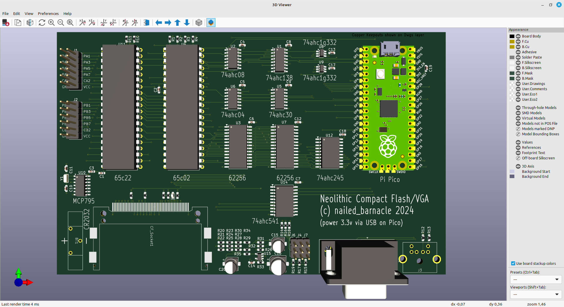

PostPosted: Tue Jul 23, 2024 5:58 pm
Posts: 983
So here's a first cut at a PCB which might probably perhaps maybe work... if I can sort out the bus interface.
Basic specs:
  • 65c02 and 65c22 running at (hopefully) 8MHz
  • MCP795 real time clock, SPI from port A on the 65c22
  • VGA video output, USB serial, and PS/2 keyboard input via Pi Pico. Either 3-bit RGB, or 3-bit (8-level) grey-scale, selected by jumper.
  • 3.3v operation, from the Pi Pico (my PS/2 keyboard is quite happy at this reduced voltage)
  • CF Card as long-term storage - probably with a FAT-16 file system if I can make it work
  • Pico controls the 65c02 at reset to organise the initial program load; thereafter it is just an active part as above.
    The intent is that the Pico uploads the disc (CF) operating system and a monitor, like DOS used to do.
Obviously still a lot of software to play with and probably some hardware too. I'm not ordering this board until I've sat on it for a few days! (Four layers to simplify power distribution, and because there's some high speed signals flying around.
PostPosted: Tue Jul 23, 2024 6:08 pm
Posts: 8504
Instead of using two 32 KB SRAMs, why not use a single 128 KB SRAM and just ground (or pull up) A16?  One SOJ32 package instead of two SOIC28 packages and all that extra real estate.  You end up soldering 32 pins instead of 56.
PostPosted: Tue Jul 23, 2024 6:34 pm
Posts: 983
A very simple reason: I _have_ two 32k rams and I don't have a bigger one :mrgreen:
A single chip would simplify the decoding a little, too.
And to be fair, that's hardly a PCB that's pushed for real estate! I could probably make it half the size if I tried hard...
