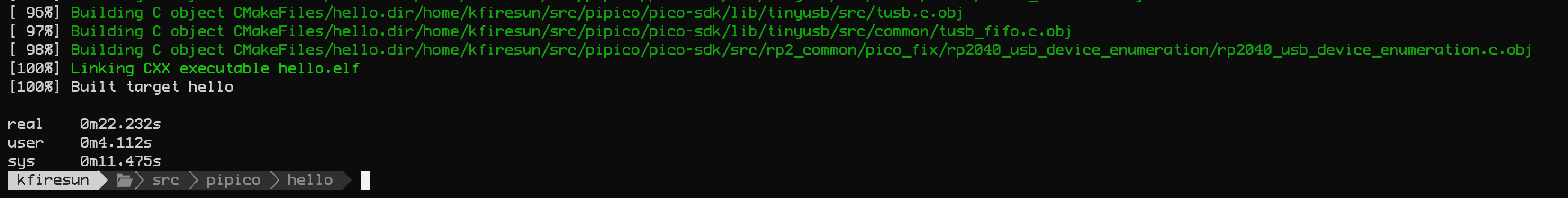

Immediate requirements were to find a tool-chain that worked. Because the official getting started approach didn't/doesn't work with my Linux Mint setup (it couldn't download MS Visual Code, and apparently couldn't work with a pre-installed flatpak version of same) I looked at other approaches. The CLI approach appears to work, but one needs to keep a careful eye on one's working directory, or the damn thing compiles everything in your directories - which took half an hour.
Not sure how you have it setup, my structure looks like so:
/home/kfiresun/src/pipico/
|- pico-skd
`- hello
    |- CMakeList.txt
    |- pico_sdk_import.cmake
    `- hello.c
The CMakeList.txt only has the hello.c listed in it. You can get cmake to recursively read all files in a directory, but if you have a complex project structure that might not be the best idea.
Anyhow, my commands look like so:
cmake . -DPICO_SDK_PATH=../pico-sdk -DPICO_BOARD=pico_w
make -j22
(Adjust -j22 to the number of threads your CPU can handle)
