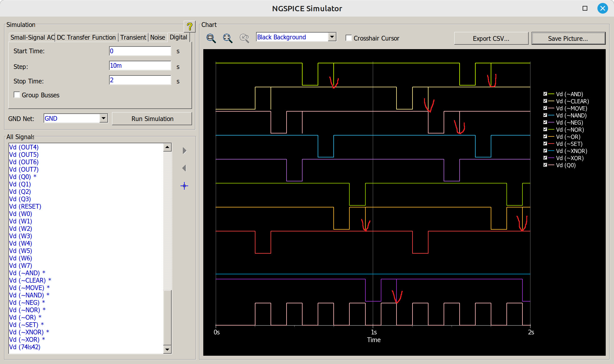

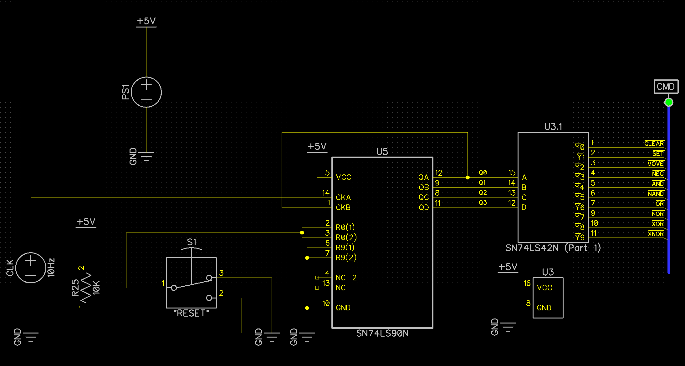

I have created a schematic, see the attached screenshot. Now I am trying to simulate how it works in a digital SPICE simulator (built-in DipTrace 5.0 beta).
In general, it works almost reasonably. But there are strange signal distortions on some outputs of U3 on each falling edge of the clock coming to the input of decade counter U5. I have shown the problem with red marks.
What I am doing wrong? Is it a simulator issue or the schematic is incorrect?

I might be the wrong person to answer this as I know nothing about NGSPICE simulation and almost nothing about the 74LS90.
However my first thought would be that running a ripple counter into a decoder might cause some weird glitches as it's quite possible that all the 74LS90's outputs will not transition at exactly the same time.
My second thought, depending on how accurate the 74LS90 Spice simulation is, is that it has propagation times on the order of 10s of nanoseconds but it looks like the simulation is stepping at 10ms. The 10Hz clock and second long output scale may not give you the resolution to see what is actually happening. Maybe try increasing the clock to 10MHz and increase the simulation step to 1ns and see if the output makes a bit more sense.
My last thought is that there is some feedback from QA to CKB (which is correct according to the datasheet) and that this will be occurring in 10s of nanoseconds. What this means for the simulation I don't know; but I don't think there's enough resolution to see what's happening there.
Andrew
PostPosted: Tue May 28, 2024 11:14 am
Posts: 872
Exactly this: the '90 is a ripple counter - a stage doesn't clock until the previous stage tells it to, rather than everything changing on the clock edge. So the last stage doesn't change until tens of nanoseconds after clock that triggers the change, and that means that there are, for those few tens of nanoseconds, unexpected and unwanted signals on the outputs.
Which the '42 will happily decode, producing those glitches that you indicate. There are probably also other glitches which you don't see because they're too fast for the simulator to display. This is always an issue with simulators because they're rarely transistor-gate-accurate and sometimes not internal-logic-accurate - I have counter circuits which rely on that phase delay which simply won't work in the simulator I use, because the simulated chip apparently is synchronous.
Whether the glitches are an issue for you or not only you can answer. It looks as if you are using the '42 outputs to control a function in an ALU(?) in which case, any delays in the ALU circuit are likely to exceed the brief time that the control is incorrect, so no issue. But only you can tell - you may need to gate the decoder output with the clock, for example.
