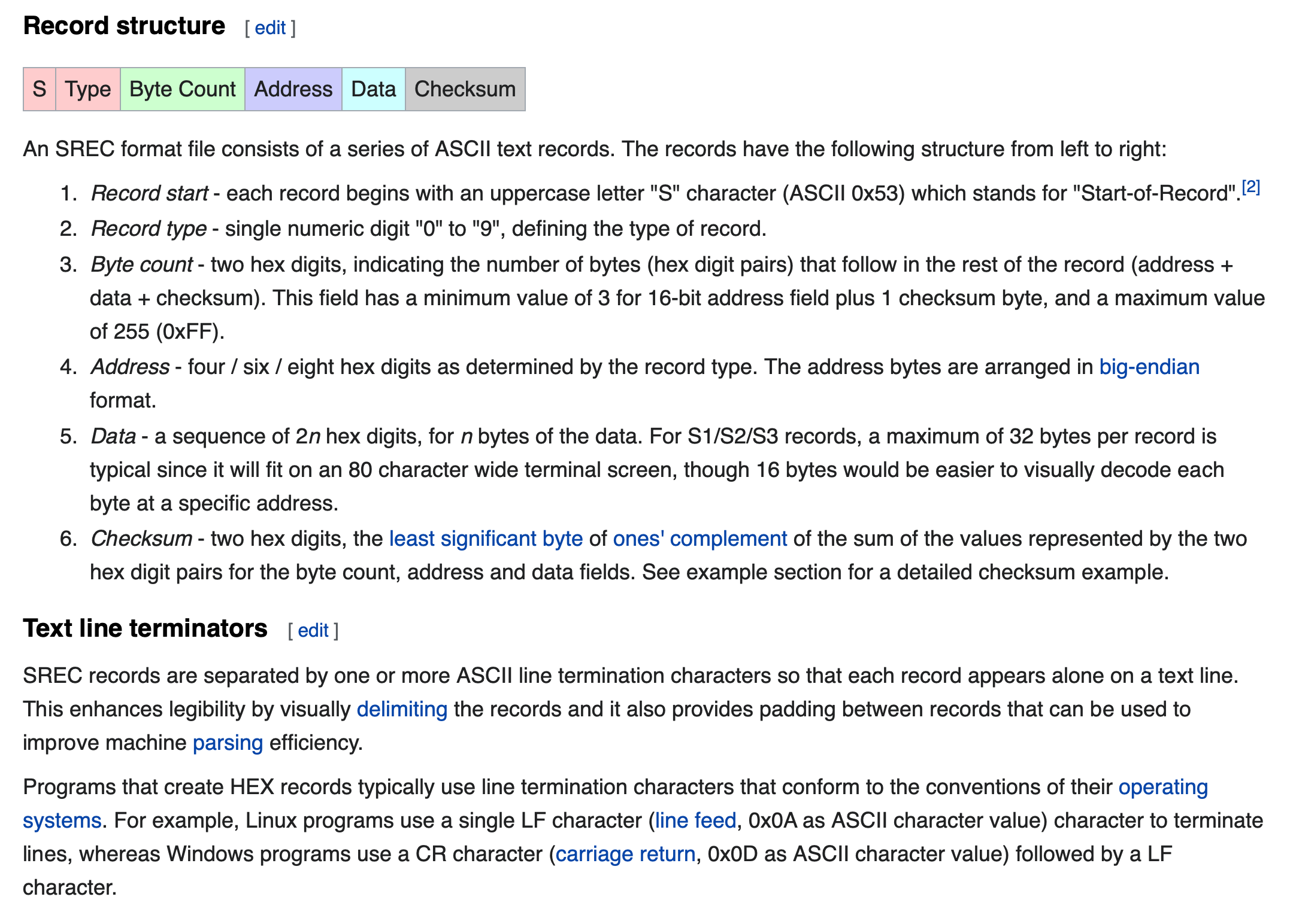

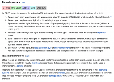

Here is the "S19 Record Loader" portion of the monitor.
; 'S' - S19 Record Loader
      cmp   #'S'
      if   eq
       jsr   NextChar
       cmp   #'1'      ; Data record?
       if    eq
        jsr   GetByte      ; Extract length
        bcs   .S19Fail
        sta   ADDR_E+0
        jsr   GetWord      ; Extract address
        bcs   .S19Fail
        jsr   SetStartAddr
        dec   ADDR_E+0   ; Reduce count
        dec   ADDR_E+0
        dec   ADDR_E+0
        ldy   #0
        sty   ADDR_E+1
        repeat
         jsr   GetByte      ; Extract data byte
         bcs   .S19Fail
         ldy   ADDR_E+1   ; And save
         lda   TEMP+0
         sta   (ADDR_S),y
         inc   ADDR_E+1
         dec   ADDR_E+0   ; Until line processed
        until eq
       else
        cmp   #'9'
        if    eq
         bcs   .S19Fail
         jsr   GetWord      ; Extract start address
         bcs   .S19Fail
         lda   TEMP+0      ; Copy to PC
         sta   PC_REG+0
         lda   TEMP+1
         sta    PC_REG+1
        else
.S19Fail:      jmp   Error
        endif
       endif
       jmp   NewCommand
      endif
Motorola S-record is a file format, created by Motorola in the mid-1970s, that conveys binary information as hex values in ASCII text form. This file format may also be known as SRECORD, SREC, S19, S28, S37. It is commonly used for programming flash memory in microcontrollers, EPROMs, EEPROMs, and other types of programmable logic devices. In a typical application, a compiler or assembler converts a program's source code (such as C or assembly language) to machine code and outputs it into a HEX file. The HEX file is then imported by a programmer to "burn" the machine code into non-volatile memory, or is transferred to the target system for loading and execution.
https://en.wikipedia.org/wiki/SREC_(file_format)
And here is a Windows tool to convert binary files to S19 format
https://www.keil.com/download/docs/4.asp
However it's not really obvious how the S19 data is loaded. Whether pasting/typing line-by-line or if a file can be opened for loading.
