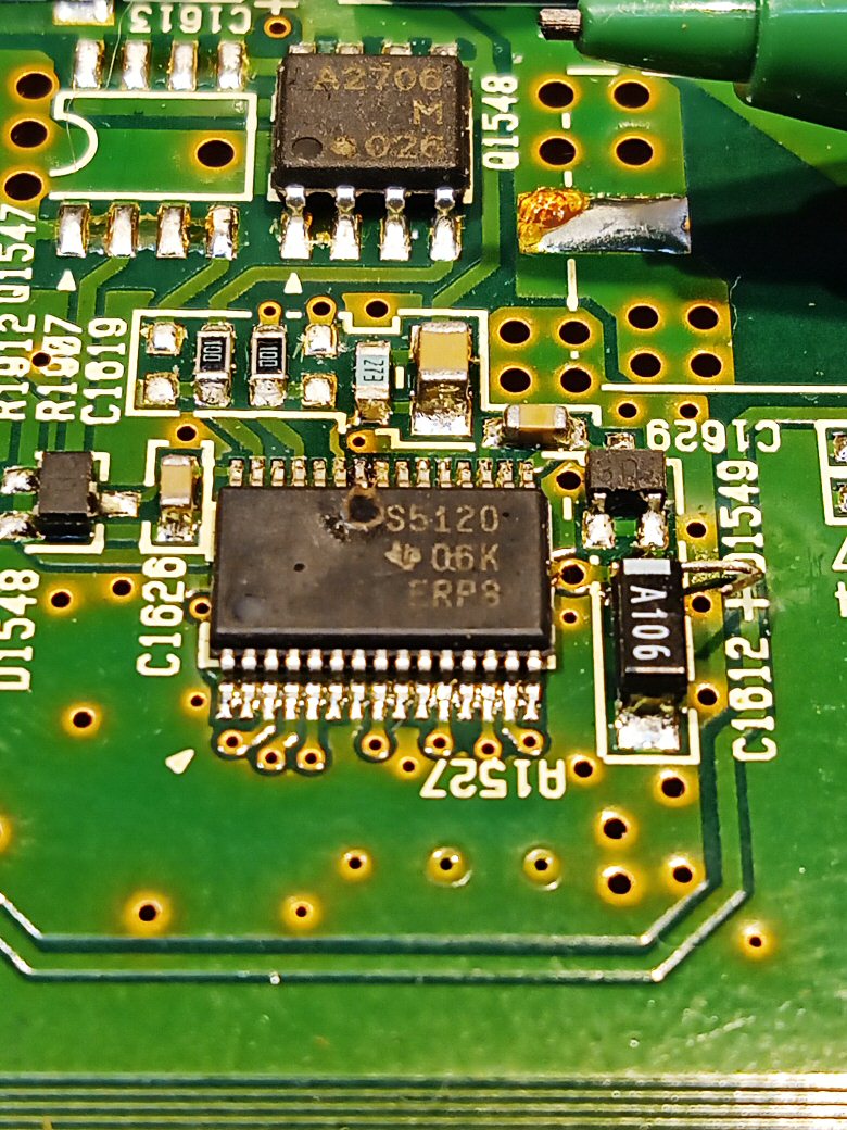

I assume you're just being colorful with your speech... although chips truly can and do sometimes explode! Check out the DC-to-DC buck controller IC in the Keyence industrial vision controller I repaired earlier this year! A surge on the incoming 24VDC left a crater in the IC and also vaporized one of the tiny PCB traces underneath. :shock:

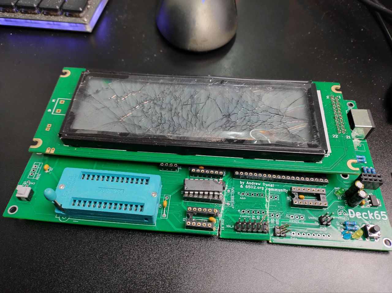

And to let you know you're not the only one with frustrations - my current project is on breadboards and I've so-far had 2 issues that caused me much head scratching - both wires in the wrong places...
I can relate. I even angrily destroyed one of my older Deck65 prototypes which I was SURE had all issues fixed, but still refused to work as intended... I promised myself to never come back to this hobby again...
And yet here I am, after 5 more revisions and some crunching, it finally worked. Those dreaded open-drain lines... Good thing that JLCPCB sends 5 copies of the PCB. :D
