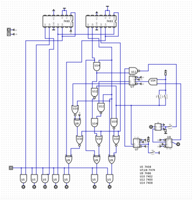

The parallel ASCII keyboard
I want to build the keyboard from logic chips and Cherry MX style switches. The idea is to create a keyboard that outputs 7-bit ASCII codes that I want to connect up to a 6522 via. I have found an old schematic in an old Brochure of the Cherry B70 Pro keyboard on bitsavers http://bitsavers.trailing-edge.com/components/cherry/keyboards/B70-05AB_Pro_Keyboard/PRO-977-2_B70-05AB_Pro_Keyboard_Brochure.pdf. This keyboard is quite complex and it has a lot of optional parts that I'm not interested in. I want to try to create something similar but a lot simpler. I like the combination of the 4-bit counters and the 74150 (16-line to 1-line data selector/multiplexer) and 74154 (4-to-16 line decoder/demultiplexer, inverting outputs) to scan a keyboard matrix. But the logic for the shift/Caps Lock (Alpha Lock in the schematic) is quite complex and I don't really understand what is going on. I did an attempt to replicate the circuit in Digital here is the result:
File comment: Attempt to replicate the Cherry B70 Pro keyboard logic
But unfortunately it does not work. I added an extra flip-flop to for keeping the caps lock on after clicking the key once and turn it of when clicking a second time. Unfortunately Cherry does not make alternate action switches any more since 2015 https://deskthority.net/wiki/Cherry_MX_Lock.
As I could not figure out how the logic of the Cherry B70 Pro works I tried to get something working myself. The theory is quite simple. I found the article Things Every Hacker Once Knew http://www.catb.org/esr/faqs/things-every-hacker-once-knew/#_ascii there is a explanation about the workings of ASCII together with the Wikipedia page about the Control key https://en.wikipedia.org/wiki/Control_key I found out how this could work. The Caps lock/Shift key toggles bit 32 or bit 16 dependent on the key you clicked (for 0-9 and keys : ; < = > ? bit 16 is toggled and for keys a-z and ` { | } ~ DEL bit 32 is toggled). The control key could be implemented by doing a bitwise AND on the key value with 0x1F.
I have a working simulation made in Digital but it doesn't take bit-5 into account yet and the clock circuit is not there yet I wanted to keep it as simple as possible and just focus on the shift/caps lock and control logic. Here is an screenshot taken from the simulation. It has tests and they all pass but the implementation is not correct. Perhaps someone has some tips or suggestions.

I'm still contemplating whether to include a keyboard onboard. Cherry switches have been historically lovely, but a cherry keyboard is not inexpensive (and if you brew your own you'll need to make the case and organise key-caps as well. I'm most likely to get a cheapo PS/2 keyboard and bit-bang it...
I know it will be easier and cheaper to use a PS/2 keyboard but I really want to pull this of and create a real parallel ASCII keyboard. The Cherry switches are expensive so I bought cheaper Cherry MX compatible Gateron Pro switches and I also already bought a keycap set. I need to design the pcb and order the pcb somewhere and the components and solder it. I also have another option for this pcb and have a much simpler matrix with just one 4-bit counter and the 75154:
This also outputs a 8-bit value. The only problem is it does not handle shift/caps lock and control. I could add a eeprom to decode the 8-bit value and the shift/caps lock or control keys. The 8-bit value is not ASCII here bit just the value of the counter and the row information.
This design was my first attempt to create a keyboard design it is much simpler. I just has straight rows and columns.
But I find it much more satisfying and educational to design a solution that outputs ASCII codes from logic chips. I don't have a complete working solution yet but I hope I can figure it out.

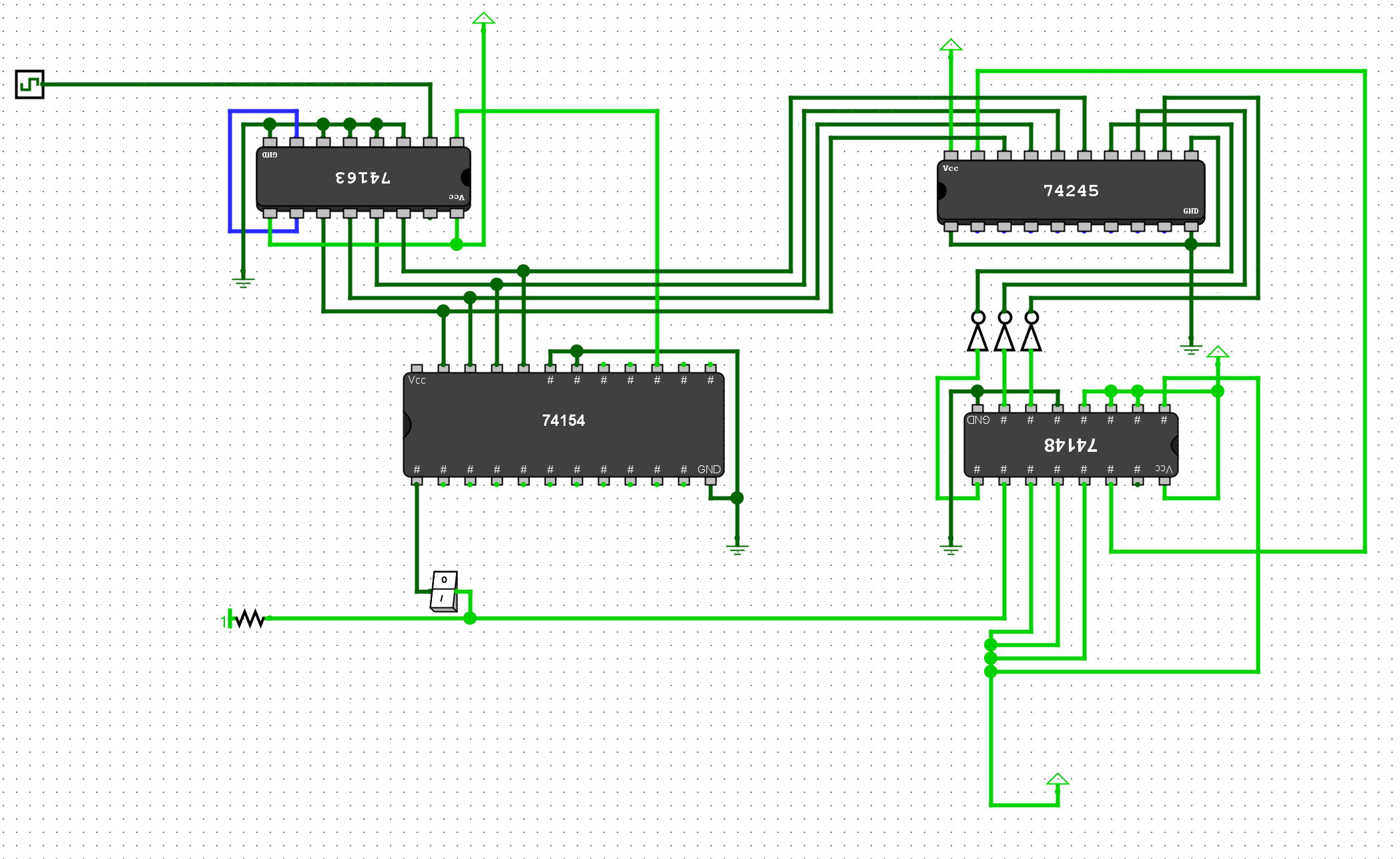

I could hook the output of the 74245 up to an eeprom together with the shift/caps-lock and control keys to the address pins of the eeprom and have the eeprom programmed with the right ASCII code at that address. The 74148 and the logic gates there are to encode the selected row.
In my design I used only 7 out of 8 bits as output. I could add another row or column to make use of that last bit.

 Post subject: Re: My 6502 computer
PostPosted: Thu May 02, 2024 4:21 pm
Posts: 257
viridi wrote:
The attachment Scherm­afbeelding 2024-05-02 om 13.53.08.png is no longer available
Lot of inverters there that appear to be changing the signal multiple times. Might be able to strip a few of those out.
I'm presuming the goal of the 245 is a connection to the 6502 databus. You'll likely want to drive that OE pin with the 6502 and not when someone presses a key. (Otherwise you'll be sending signals down the databus when other devices are trying to use it.)
I'd likely use that logic to toggle a flop to signal an interrupt on the 6502 that a key is ready to be read.
When I was looking into to doing this with a PIC, I planned to use some of the onboard memory of the PIC as a ring buffer for the keys pressed. That way the key strokes could be read by the 6502 when it was ready.
Something similar could be done in hardware, but I haven't been able to find any memory ICs with a reasonably small queue. (Most are phenomenally huge these days, at least for a simple keyboard buffer)
Edit:
Here's what I'm thinking with simplifying this:
(Edit/Edit, fixed a minor logic flaw I saw)
You are right I just could not get it working without them. It needs some further investigation.
No I want to hook it up to one of the ports of a VIA. The VIA then can signal an interrupt to the 6502.
Yuri wrote:
Edit:
Interesting I will have a look thanks.
