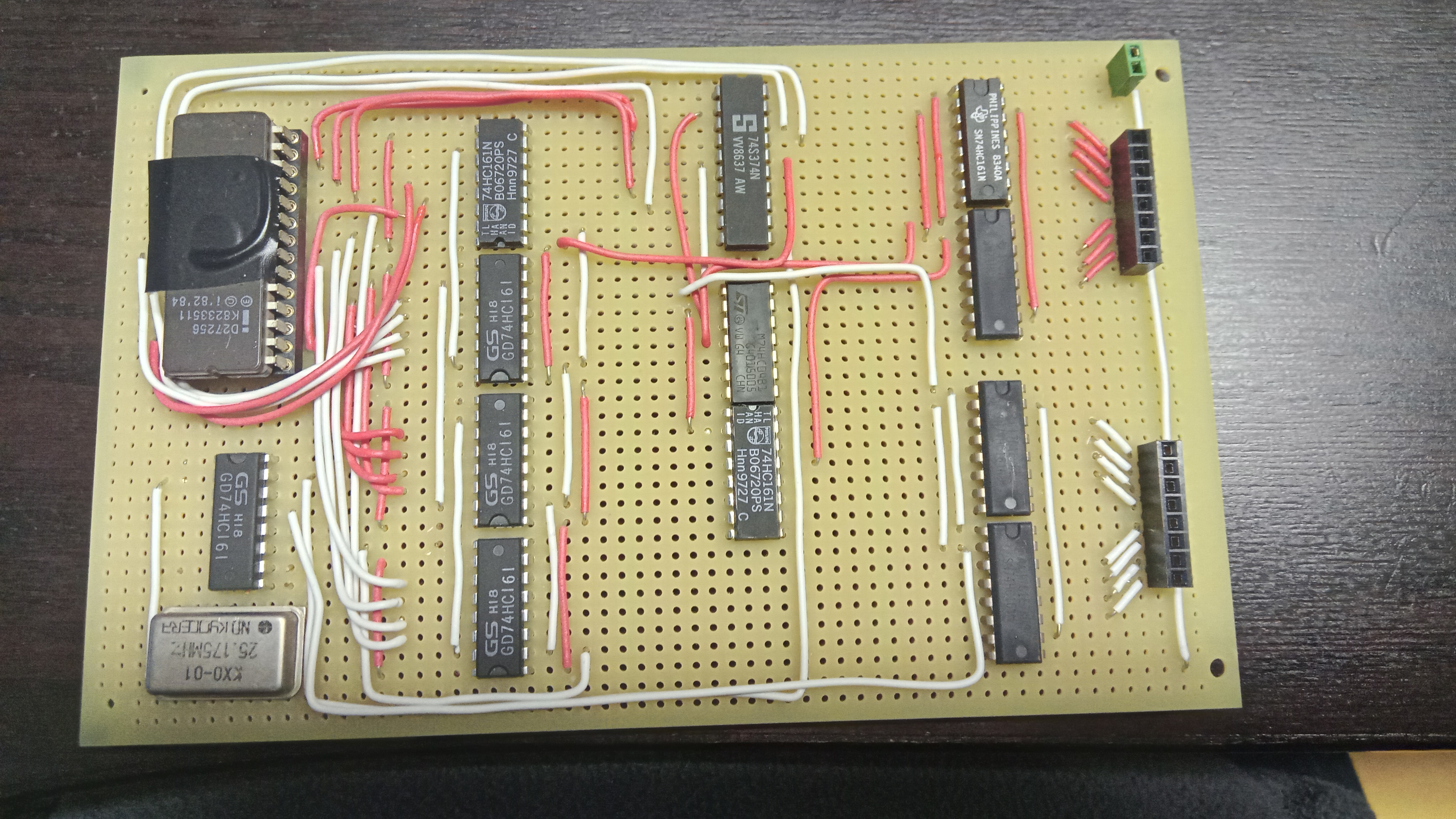

Martin_H wrote:
o your use CPU gener
Hi Martin,
i'm pleased of your interest.
in brief I use counters to take out timing signals programmed in a EPROM, then counters (llots of 74ls161) to take out 3 bit from a 32Kbyte Sram (video ram) in order to put color signals in sync.
The bus interface is 2x74ls273 and a 74ls245 with some glue logic + 4x74ls157.
The problem is that writing an entire screen causes lots of flickering... sooner or later I will put on the logic to allow writes only during blanking, but I don't want to insert wait states to the processor, I will use a FIFO buffer. To be enginereed... :D
File comment: Timing board...

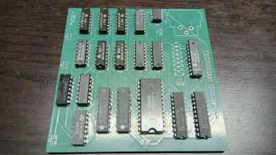

Here you are...
PCB with chips mounted, soon resistors and capacitors...
Kicad project. please note that kicad project is derived from breadboard construction, and I could not test pcb yet... it can be Buggy... :shock: :shock: :shock:
when everytingh will be tested I will notice here...
File comment: Kicad
DMX-OUT.rar [127.26 KiB]
Downloaded 24 times
File comment: PCB not yet finished
SittingBull
PostPosted: Wed May 01, 2024 6:16 pm
Posts: 1013
Some empty holes are for bypass capacitors? Best practice is to have an own bypass cap per chip. With all chips 74LS types chances are it'll work, but your mileage may vary
André
In fact I'm not a fan of bypass capacitors, on the other hand I'm a fan of your works...
Thanks for your comment.
SittingBull

Uh...bypass capacitors in digital work should not be considered an option if circuit stability and predictability are expected.  Saying you’re “not a fan of bypass capacitors” is kind of like a competition marksman saying “I'm not a fan of rifled barrels.”
Incidentally, 74LS logic is not a recommended choice for new designs.  If you are interfacing to a circuit being driven by a 74LS device, make that connection with a 74HCT (fast with gentle edges), 74ACT (very fast with aggressive edges) or 74AHCT (very fast with gentle edges) equivalent.  Other devices can be 74HC, 74AC or 74AHC, since that part of the circuit will be 100 percent CMOS and no TTL compatibility will be required.  The resulting circuit will have better noise resistance, be more tolerant of bus loading, and will consume less power.
It was just a pun...
I made everything on breadboard, with 4 capacitors and it worked as espected, hoping on pcb with 6 cap it replays...
It's the first time for me with pcb... :mrgreen:
I will put every capacitor needed on rev. 2
okay, forgot to mention I'm using - not only but as many i can - used parts, wich I took off from 80's Olivetti computer pcb.
A firiend of mine has his backyard full of these parts, time to time I catch something for free...
I know that for the purists it's awful but I also mix 74LS with 74HC, as long as they work togheter for me is fine... :D
