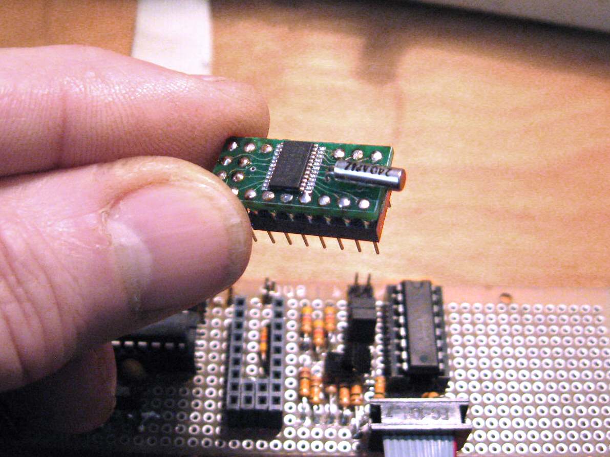

Well, the 16is750 a 16550 register-compatible UART that's still around (although seemingly only in a HVQFN-24 package). :| But the reason it doesn't have a zillion legs is, it's not bus-driven. Instead, the host interface is SPI (or I2C, depending on whether a certain pin is tied high or low).
So, not quite the same animal. But it's possible to make a little module that plugs into a DIP site (as I did with this now-obsolete 24-TSSOP version)...

PostPosted: Fri Apr 19, 2024 8:27 pm
Posts: 962
Yabbut... there's something a bit weird about using a serial interface to, um, talk to a serial interface... kinda non-intuitive.
Though I suppose the big advantage is the self-clocking nature of SPI (I'm not a fan of I2C).
