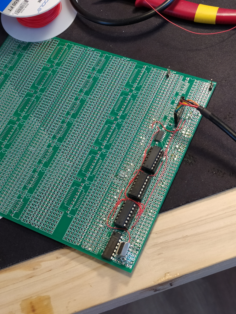

So... I finally got round to building it, and it works.
Fifty percent of the time...
It looks like there's a race hazard I hadn't thought of. The idea is that the sequence starts when the low going edge of the start bit sets U2A, clearing the ~Q output and enabling the counter U1. Every time its Q3 output goes high, at count 8, the current input signal level is clocked into U3. When it goes low again, U1B increments its count. When that count is nine, it asynchronously resets U2A (and also triggers the data latch U4 and sets the ~RXF flag), which resets U1 back to zero.
So after nine counts, nine bits of data have been clocked in, including the start bit which by now has been discarded; the received byte has been latched, and the rx received bit has been set. Now we're waiting for the next start bit, since we're now looking at the stop bit.
Or are we? It appears that depending on the phase of the master (1.8MHz) clock at the time of the first start bit, and the relative speed of the data source clock, it is possible for the counters to reset a few nanoseconds before the rising edge of the stop bit. And that's a problem, because in that case, U2A is in an indeterminate state. Whichever of the ~S and ~R resets rises last will rule, and if the input is still low when the reset pulse rises, then things will immediately start counting again... straight into receiving an all-ones signal.
The issue is down to the relative timings of the serial clock and the count; one is in the middle of the bit and one at the end; sometimes the one at the end arrives too soon.
There is an easy answer, I think, which I'll check this morning; a three input NAND to replace U5A. That should inhibit the reset until the stop bit is high. If that doesn't work, I'll need to look at the count detection logic a little harder.
Nand that makes all the difference (sorry!)
Two words read due to the end of the last bit being read as a new start bit (so eighteen clocks).
And with the reset inhibited until the input goes high (i.e. the stop bit starts), just the nine clocks for a single read that we expect.
Here's the circuit built on my dual-mode proto board, the oscillator at the bottom, the serial chip is the only SOIC on here. I didn't bother with the latch at this point.
Not as small as a single chip solution, but as an input only serial port it's handy (and not limited by system clock speed) and cheap
