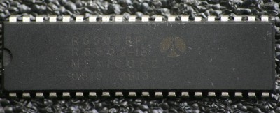

To be clear, I have a Rockwell R6502BP, which I understand to be a 3MHz (as denoted by the 'B') NMOS(?) CPU with a 2008 date code.
The way I have things right now, I can run this up to about 500Hz before the signal noise becomes to great. All I really have right now, is a proof on concept, and I'll build a proper timing circuit as and when I need to.

PostPosted: Tue Apr 02, 2024 9:32 am
Posts: 8453
That's a fake.  See our sticky topic, "65xx parts sources, genuine and fake."  The R prefix means it's made by Rockwell; but Rockwell quit making the 65c02 years before 2008 (maybe around year 2000?) and the NMOS 6502 undoubtedly before that.  You almost certainly have a 65c02 (which is good), as the NMOS had a specified minimum of 100kHz to guarantee that it wouldn't lose internal states and lose its way, kind of like DRAM that needs constant refreshing.  65c02's have always been able to stop; but only the ones from WDC could stop in either phase.  Ones from other manufacturers, like Rockwell, Synertek, and California Micro Devices, could only stop with phase 2 high, not low. In the clock-generation page of the 6502 primer, you can see the way shown to allow single-cycling without violating that timing, where there's the paragraph starting with "You may someday want to single-cycle".

That's a fake....
Ah, okay. Thank you for that.
I've removed it from my board, so that I could get a good picture. That way you can check the markings and know that I've got the identification correct, or tell me where I'm wrong.
It was off of eBay and was real inexpensive, so there's that. If it won't hinder my progress, I'll continue to use it, but otherwise I'll replace it.
From what you said, it could be that I have a more 'usable' chip than what I though, yes?

PostPosted: Tue Apr 02, 2024 11:49 am
Posts: 10821
A 'C02 is probably more useful, so stick with it!
An NMOS '02 is handy if you're looking for some kind of historical authenticity, or you really like to code with undocumented opcodes.

PostPosted: Tue Apr 02, 2024 12:53 pm
Posts: 303
The way to be sure is to try executing one of the new 65C02 instructions and see what it does. Once you've got it reliably executing instructions, try opcode $8f. On the 65C02 that's BBS0, which will take a zero page address and an 8 bit offset, read from memory, and either branch or not depending on the value it read. On the NMOS 6502, that's the undocumented instruction SAX abs, which will store the result of ANDing the A and X registers. Feed it $8f, $ea, $ea, $ea, $ea, ..., and see if it writes to memory. I expect it won't.
That chip appears to be laser-etched: the top right of the logo is dark and the bottom left is light, which is what I'd expect from an indentation being lit from the top right. I'm pretty sure that wasn't happening when Rockwell were making 6502s.

PostPosted: Tue Apr 02, 2024 4:12 pm
Posts: 8198
Welcome, Rob!
That's a fake.  See our sticky topic, "65xx parts sources, genuine and fake."  The R prefix means it's made by Rockwell; but Rockwell quit making the 65c02 years before 2008 (maybe around year 2000?) and the NMOS 6502 undoubtedly before that...
According to information I have, 2000 was the last year Rockwell produced any 6502-family chips.  That R6502BP is indeed a fake.  You should be aware that the 65C02 is a commonly-counterfeited part that regularly turns up on eBay sites.  As Garth notes, we have discussion around here on where to obtain parts and how to avoid being gypped by unscrupulous sellers of fake 6502 parts.
In any case, an NMOS 6502 cannot run that slowly—it is a dynamic design that will lose state at subnormal clock rates.  All 65C02s of which I am aware can be safely stopped on Ø2 high.  Only the WDC 65C02 can be safely stopped on either clock phase, which is possible because it is a fully static design.
PostPosted: Tue Apr 02, 2024 4:33 pm
Posts: 8198
I noticed that as well.  The markings are wrong for a genuine Rockwell part, and I have never seen the real McCoy with laser markings.
PostPosted: Tue Apr 02, 2024 9:21 pm
Joined: Mon Apr 01, 2024 9:58 pm
Posts: 24
Location: ZZ9 Plural Z Alpha
Thanks guys, for all these responses. I'll take them one at a time:
I'm not too sure if I've done this correctly, but here goes...
Running at 5Hz: for the first 21 cycles, I simply have 0x00 being presented to the data bus, while the CPU settled into its 4 reads, 3 writes cycle. Given that, it was then easy to time my app to present 0x8F at T-State 22 and 23, after which 0xEA all the way.
This is my monitor trace. I've done a little rework on my code, so that the output is clearer to read. As I'm unsure about what I should be seeing, I'm hoping that you'll come back and tell me what you see, and if ti's what you expected to see, or maybe tell me what I've done wrong, if I have in fact, messed this up in some way.

Thank you very much, John.

That's a very good suggestion and would be (as you say) a fun & useful first project. I would, in fact, like to remove the Pico from the loop entirely, once I no longer need it to monitor the 6502 and provide its ϕ₀(IN) signal.
I will certainly find and read what others have posted on the topic of 'bootstrapping'.
Thank you so much, Bill, for this and the welcome.
Thank you very much for your input and the welcome.
It seems that I've fallen into the same trap as I'm sure that many others have done before me. To be fair to the seller from whom I got this CPU, maybe he's not as 'up-to-speed' on these facts as he should be, and he's unaware that he's selling fakes.
I will indeed use better suppliers, moving forward.
