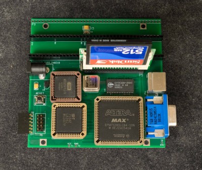

I assembled the PLCC84 version of 65ALL this morning. It is working.
Lessee...we got some itty-bitty chips in PLCC44 and then there is that great big gorilla in the lower right-hand corner. :D  Reminds me of one of my (never-built) designs using the Atmel ATF1508AS, which too is in a PLCC84 monster, and which overwhelmed the board.  :shock:  My POC unit’s SCSI host adapter has an AMD 53CF94 controller, which being PLCC84, takes up nearly one-third of the total PCB area.  No wonder QFP and smaller became popular.
Have you got anything specific usage planned for this unit?

Posts: 1076
Something I should've known when designing for retro computers is retro frequently means used parts which are likely salvaged from old boards of uncertain conditions. So parts should be easy to remove, easy to test and replace. Used SMT parts are more likely to be damaged during removal and hard to test and replace, so I should stick with PLCC where possible. However, like you've said, PLCC84 is huge, but a component can be placed in the back, if that's any consolation.
I plan to port DOS/65 and port an text editor so I can use it to learn Forth.
