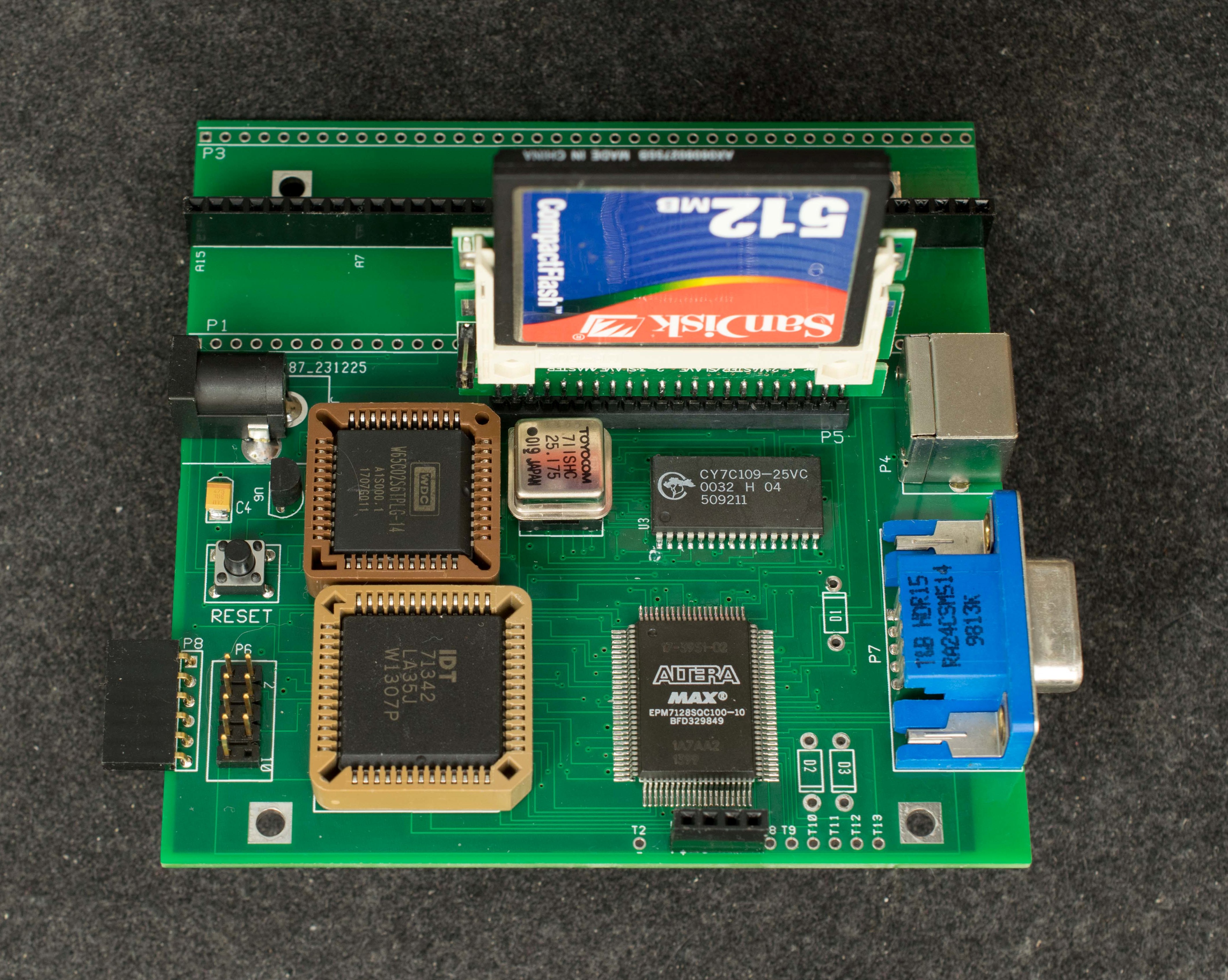

Rev1 of 65ALL has fixed all known problems. It bootstraps from CF to monitor; VGA display and PS2 keyboard are working. It is a standalone computer but I can load updates and applications from workstation via serial port. It can load and run BadApple, Game of Life, and passed Dormann's instruction tests. I'm putting it aside now because I have several new pc boards to check out. My plan is to port DOS/65 to it and work toward a self-hosting computer. Current discussion about editor and high-level program running on 6502 are very applicable to 65ALL. DOS/65 has CP/M equivalent ED and BASIC, but I hope to port Miguel Garcia's TE screen editor. For high level language Forth seems the most compact language for 8-bit processors, but sadly I have no working Forth experience. On the other hand, I've programmed mostly in assembly and have forgotten most of my C/C++, so I might as well start afresh with Forth.

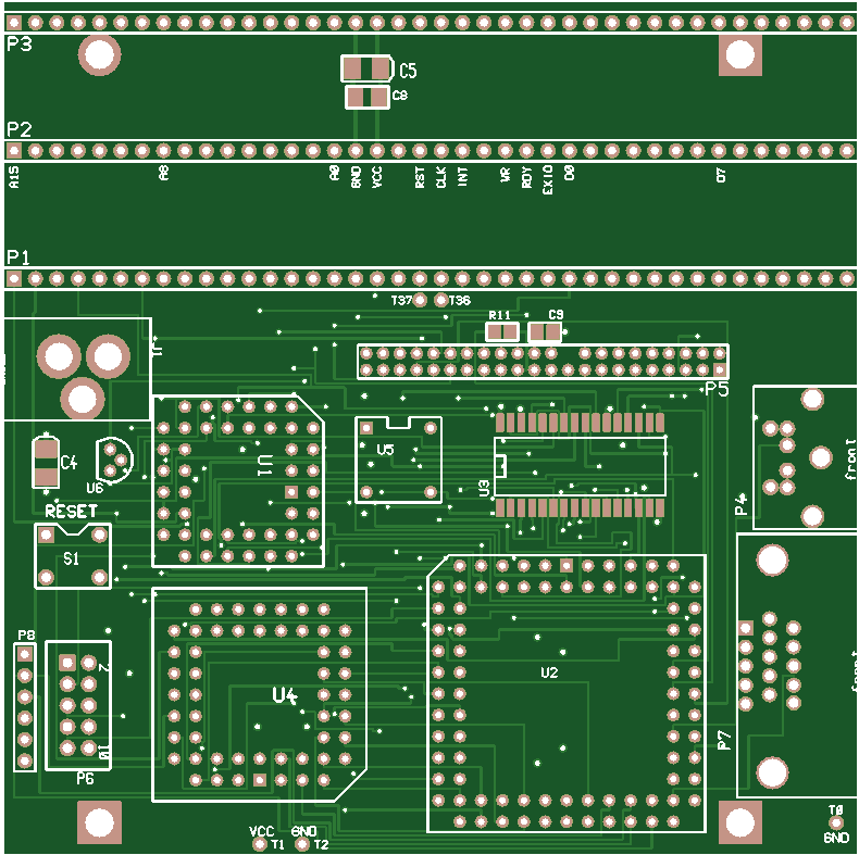

I have feedback from users that EPM7128SQC100 (100-pin QFP) is expensive, difficult to acquired, hard to solder and has higher percentage of locked JTAG which render it useless. (I must've gotten lucky with my existing stockpile of used EPM7128SQC100.) Any rate, EPM7128S in PLCC84 package is much easier to get and easy to test and replace if defective, so I've redesigned 65ALL with PLCC84 version. Software is compatible with 100-pin QFP version EXCEPT I2C interface is eliminated due to insufficient IO pins. I had a choice of either 115200N82 serial port or I2C and I picked serial port which is useful for files transfer. 65ALL has 3 expansion slots so either I2C or serial port can be added via expansion IO board, but serial port is more useful especially during the software development phase, so I picked the serial port function.
The design is currently being fabricated at JLCPCB. It is 4-layer, 100mmX100mm

I've created a repository for 65ALL rev2 design information. https://www.retrobrewcomputers.org/doku ... 5allr2home
The pc board is not proven right now so I don't recommend downloading and sending the gerber photoplots to board fab house.

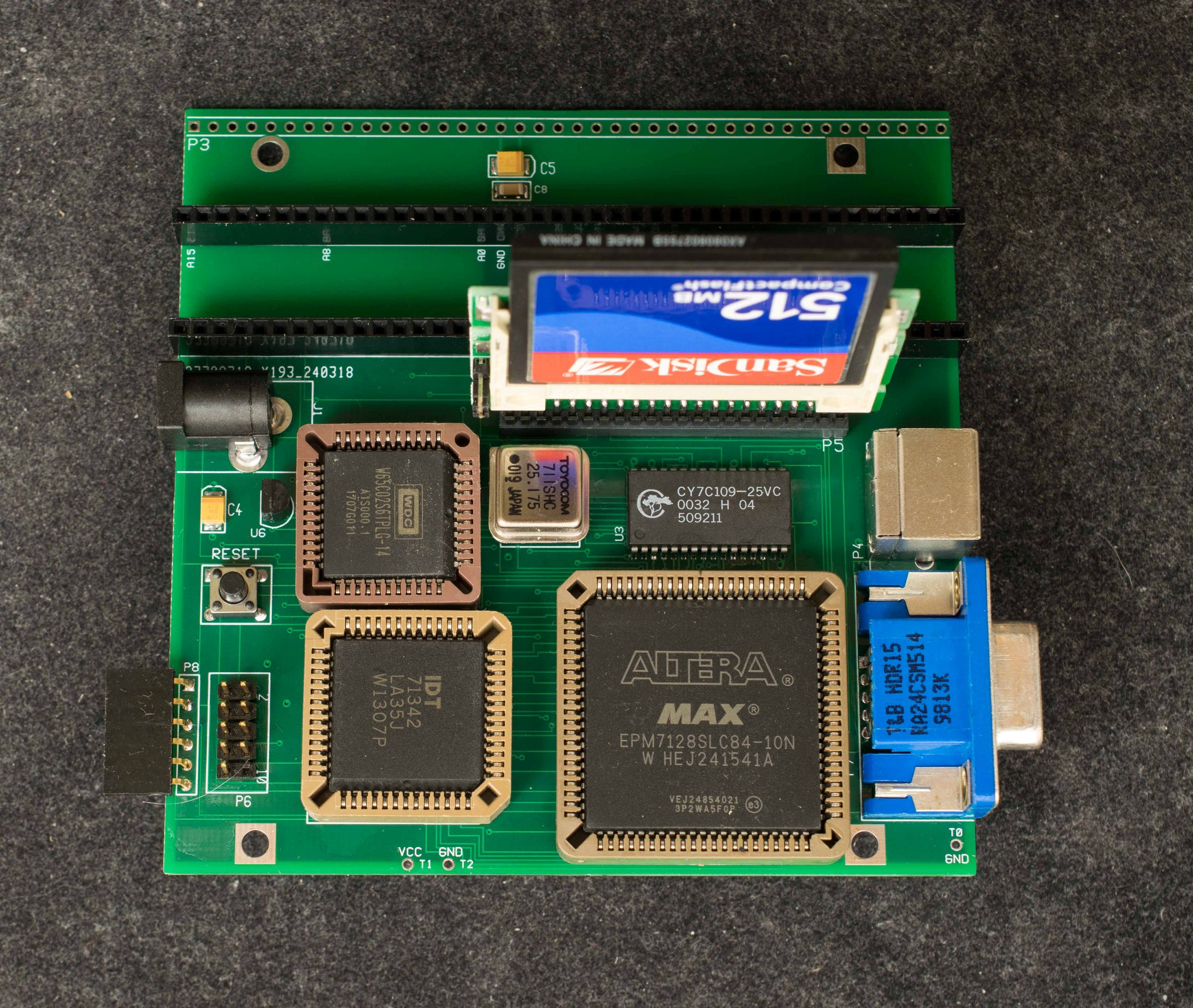

I assembled the PLCC84 version of 65ALL this morning. It is working.
Lessee...we got some itty-bitty chips in PLCC44 and then there is that great big gorilla in the lower right-hand corner. :D  Reminds me of one of my (never-built) designs using the Atmel ATF1508AS, which too is in a PLCC84 monster, and which overwhelmed the board.  :shock:  My POC unit’s SCSI host adapter has an AMD 53CF94 controller, which being PLCC84, takes up nearly one-third of the total PCB area.  No wonder QFP and smaller became popular.
Have you got anything specific usage planned for this unit?

Posts: 1121
Something I should've known when designing for retro computers is retro frequently means used parts which are likely salvaged from old boards of uncertain conditions. So parts should be easy to remove, easy to test and replace. Used SMT parts are more likely to be damaged during removal and hard to test and replace, so I should stick with PLCC where possible. However, like you've said, PLCC84 is huge, but a component can be placed in the back, if that's any consolation.
I plan to port DOS/65 and port an text editor so I can use it to learn Forth.
