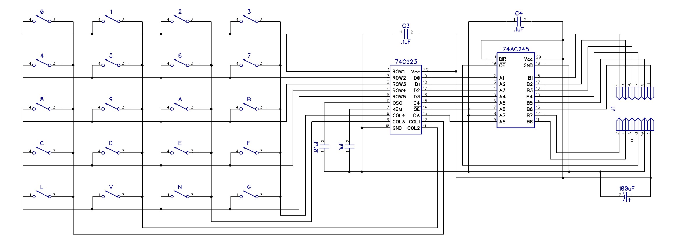

I'm more of a hardware guy so I've used 74C922 and 74C923 keyboard encoders for this.
The 74C922 encodes a 4x4 matrix and the 74C923 does a 4x5 for 20 keys. In the past I have used one of the same little 4x4 keyboards for the HEX numbers and then added 4 more push buttons as function key along with the 74C923. This makes a nice stand alone keyboard that can be used for various experiments/systems as required.
For me, cutting down on code is more important the saving on hardware.
Just another way to skin the cat.

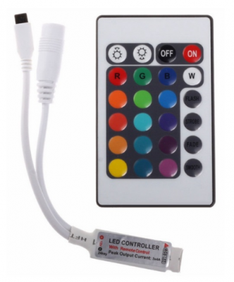

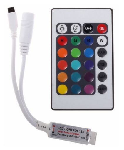

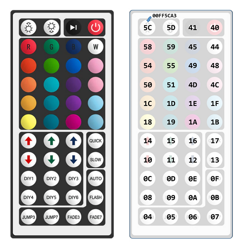

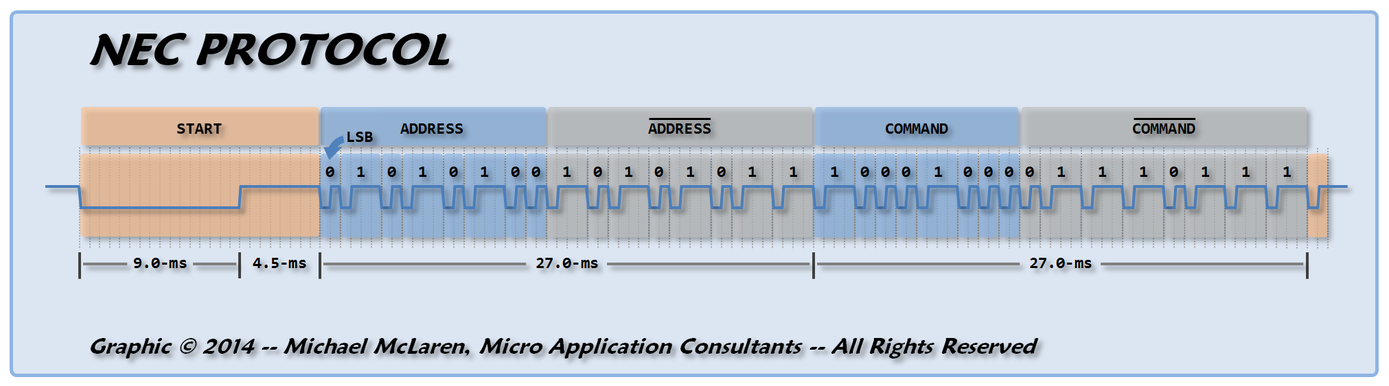

One possible low-cost solution, if I may? I've used some 24-key and 44-key IR Remotes in PIC projects in the past. The IR Receiver IC comes with the keypad and only needs a single pin and pull-up on the host. The NEC IR protocol is relatively easy to decode and you can print custom keypad overlays.

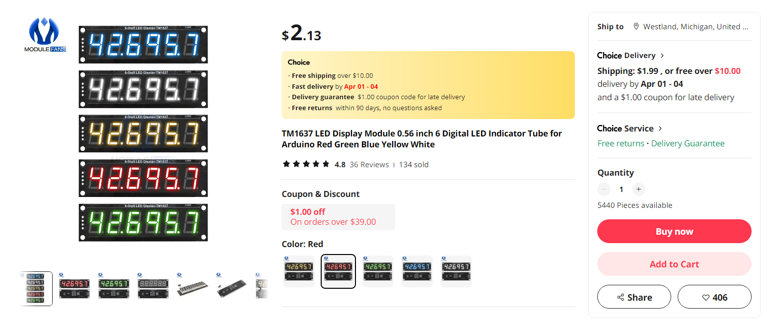

Another interesting serial I/O (keypad & display) chip;
TM1637, DIP-20, 2-pin interface (CLK & DIO), 6-digit 7-segment display, and 16-key keypad. Chips and 4-digit and 6-digit display 'modules' are available on AliExpress and elsewhere.
