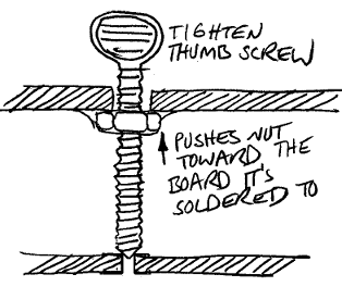

this might be more than a tad awkward if it ever becomes necessary to un-plug the module from its motherboard/whatever. If you haven't already, I suggest you give this issue some thought while you're still in the planning stage.
One option I considered for a similar assembly was to include a simple, homebrew extractor, consisting simply of a captive nut and a bolt at each of the four corners (probably inboard, within the perimeter formed by the connectors). The arrangement would be such that the module and the mobo could be separated by turning each of the four bolt heads a little at a time, prying the assembly apart equally from all four corners. If that seems unclear I can provide more detail.
Jeff and I talked about this a few years ago, resulting in this image:
PostPosted: Fri Feb 09, 2024 9:08 pm
Wow -- I had utterly forgotten! :oops:
Looking at that diagram, there are some details I would consider changing. The nuts do need to be restrained from turning, but soldering each one to the board seems suboptimal due to the weak-ish joint that results and especially because of the rather large chunk of board area that's consumed by the nut and the surrounding solder joint. That entire area is prevented from having traces on its surface, so from a routing perspective I'd prefer a scheme that has no excluded area other than the bolt hole.
So, instead of nuts soldered to the board, I would consider using a short length of bicycle spoke or similar material which perhaps by brazing would have nut #1 and nut #2 attached at its ends. This is sufficient to restrain the nuts from turning, and we use another such assembly to link nut #3 to nut #4. Or, similarly, each of the two nut-and-spoke-and-nut assemblies could be replaced by a piece of 1/4" by 1/4" metal bar, drilled and tapped at each end. (Or make the bar out of nylon, or even have it 3D-printed.)
Optionally, you could even attach the halves and create just one rigid assembly that includes all four of the threaded holes. Done properly, this'd mean every bolt is assured of being perpendicular to the surface, which means it doesn't necessarily need to be sharpened to a point nor have a guide hole to receive that point. Also optional is the use of thumb screws, as opposed to a more ordinary screw/bolt.

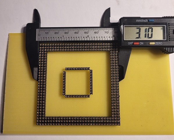

Here's an initial layout estimate using a spare vector board. The square in the middle is just a placeholder for the BGA, about 24mm x 24mm. This arrangement has 31x4 pins on the outside perimeter, then 29x4 pins and 27x4 pins for a total of 348 pins. Plenty!
I'm thinking now, that the 3x VR's and JTAG interface will have to go outside of the I/O pins, which will enlarge the 6 layer board to no larger (hopefully) than 3.5" x 3.5" (89mm x 89mm)

I suspect you counted the corners twice - I get only 336... I hope that's enough :D
PostPosted: Mon Feb 12, 2024 11:29 pm
You are correct sir! Good eye, thank you for spotting that Neil.
