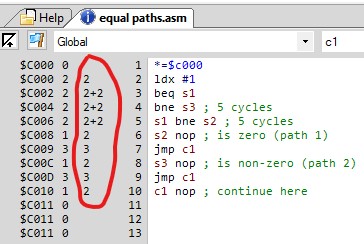

That sounds easy. Here's one approach:
*=$c000
ldx #1
beq s1
bne s3 ; 5 cycles
s1 bne s2 ; 5 cycles
s2 nop ; is zero (path 1)
jmp c1
s3 nop ; is non-zero (path 2)
jmp c1
c1 nop ; continue here
Basically, I follow each branch with its opposite condition, so only one of the pair is ever taken. If the first beq is taken, that's 3 cycles, followed by 2 cycles from the bne not taken. If the beq is not taken, that's 2 cycles followed by the bne which is then taken. So it's 3+2 or 2+3, either way that's 5. Then at the end of the branch, both paths need to take a jmp to return to a common code path. In one case that will seem redundant, but actually any 3 cycle instruction could be put there.
As far as each code path, you will have to manage that yourself, putting nop's in one of them. Also watch for page boundary crossings, which could complicate things.

Anyhow, other than that, you will have to count yourself. There is an assembler that does this for you. C64 Studio: https://github.com/GeorgRottensteiner/C64Studio
Is is geared towards several 8-bit home computers but can be used for any 6502 single board computer as well.
When you Build your file, a listing shows the cycle times for each line.
