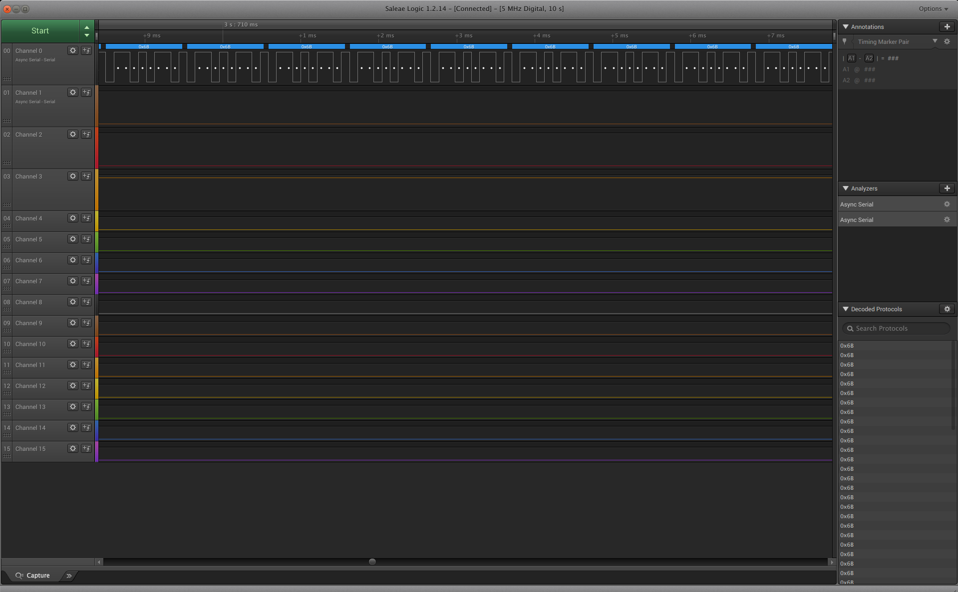

I thought it probably was 9600, still no luck though, this is the output to the serial monitor. :
00000000 00 9E 96 2D 73 A5 93 27 C9 24 4B 39 7A 39 F2 93 ...-s..'.$K9z9..
00000010 A5 48 23 91 4D 49 19 7E CA FA C9 C9 E6 33 A6 99 .H#.MI.~.....3..
00000020 66 E6 F3 33 65 66 9A 33 79 EB D6 CA CA F9 73 84 f..3ef.3y.....s.
00000030 72 72 B2 A4 93 23 46 83 7E 4A 7E 7E EE 69 92 E4 rr...#F.~J~~.i..
00000040 E4 92 D2 C8 53 49 93 49 48 1B 1A F9 93 12 C9 92 ....SI.IH.......
00000050 91 4D 24 91 46 33 B2 24 92 92 73 E4 49 93 93 E4 .M$.F3.$..s.I...
00000060 A4 93 27 4B 33 5A A9 72 F2 D3 72 72 B2 A4 93 23 ..'K3Z.r..rr...#
00000070 46 E5 D6 F2 F9 73 4C 72 72 B2 A4 93 23 46 83 7E F....sLrr...#F.~
00000080 4A 7E 7E F2 79 D2 32 49 93 4D 53 49 93 49 48 1B J~~.y.2I.MSI.IH.
00000090 1A F9 93 12 C9 92 91 4D 24 91 46 D3 72 E4 73 E4 .......M$.F.r.s.
000000a0 49 93 93 E4 A4 93 27 4B 99 5A 6A D8 F2 D3 72 72 I.....'K.Zj...rr
000000b0 B2 A4 93 23 46 79 EB E2 F9 73 A6 72 72 B2 A4 93 ...#Fy...s.rr...
000000c0 23 46 83 7E 4A 7E 7E EA 79 52 92 52 E4 91 93 D3 #F.~J~~.yR.R....
000000d0 F2 F3 64 24 92 26 23 4F 25 7E 66 D9 12 49 92 73 ..d$.&#O%~f..I.s
000000e0 E4 49 93 93 E4 A4 93 27 4B 33 5A A9 72 F2 D3 72 .I.....'K3Z.r..r
000000f0 72 B2 A4 93 23 46 E5 D6 AE F9 73 4C 72 72 B2 A4 r...#F....sLrr..
00000100 93 23 46 83 7E 4A 7E 7E AE D9 D2 92 52 F2 D3 C9 .#F.~J~~....R...
00000110 92 46 91 23 45 39 2E 69 12 C9 92 D3 72 E4 93 E4 .F.#E9.i....r...
00000120 A4 93 27 4B 33 5A A9 72 F2 D3 72 72 B2 A4 93 23 ..'K3Z.r..rr...#
00000130 46 BF 7A 19 72 F2 73 D2 49 E4 E4 92 D2 C8 B3 A4 F.z.r.s.I.......
00000140 93 26 4B 19 2E A9 B2 24 A4 9E 3D 96 F3 F3 F3 F3 .&K....$..=.....
00000150 F3 F3 F3 F3 F3 F3 53 CD F3 73 4B 92 4F 93 33 D2 ......S..sK.O.3.
00000160 C9 92 4D 33 B2 24 92 92 93 D2 92 24 A4 93 91 91 ..M3.$.....$....
00000170 4D 13 C9 E4 B3 25 65 26 66 E6 D3 C9 92 91 48 53 M....%e&f.....HS
00000180 49 93 92 48 23 43 79 EB DE 52 7E 7E 7E 7E 7E 7E I..H#Cy..R~~~~~~
00000190 7E 7E 7E 7E 4A 7E 7E EE 69 92 E4 E4 92 D2 C8 73 ~~~~J~~.i......s
000001a0 E4 49 93 33 52 E4 92 92 F3 49 93 92 E4 93 24 B2 .I.3R....I....$.
000001b0 A4 93 93 24 79 EB D6 CA CA E9 C9 59 E6 03 00 ...$y......Y...
This is what the logic capture looks like:
PostPosted: Tue Feb 06, 2024 4:08 pm
Looks to me like your analyser is interpreting an inverted logic. I think the first L-H transition is the start bit. Somewhere in the chain of hardware and software and probing it looks like there needs to be an inversion.
I think it's the case that RS232 does use the lower voltage - a negative voltage - for logic 1, and the higher voltage for logic 0.
Perhaps see here: https://www.sparkfun.com/tutorials/215

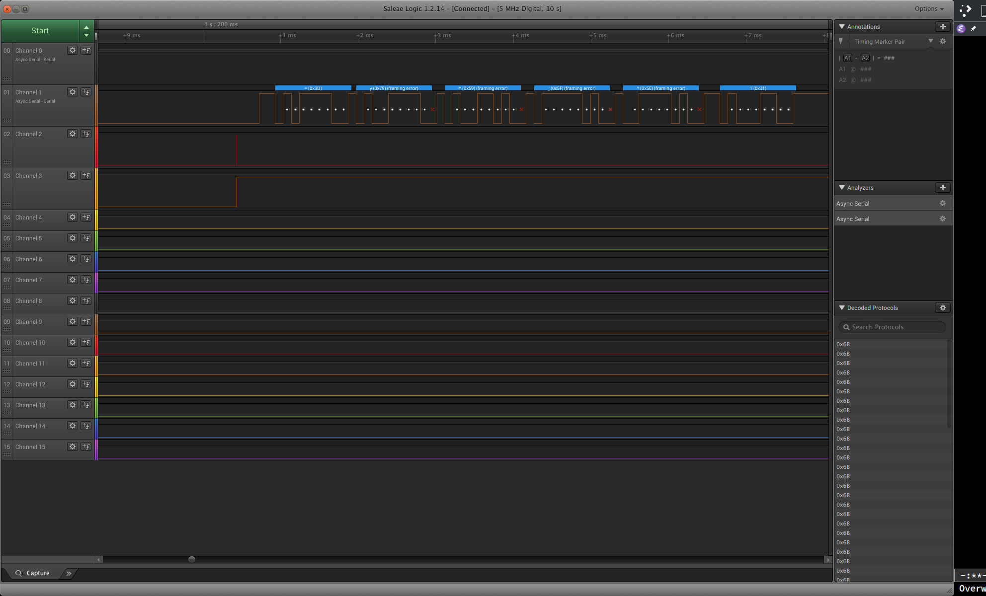

]I tried sending a bunch of ascii 'k's to the board using the serial monitor, my logic analyser interpreted those correctly.
[attachment=0]Logic_Analyser-Digiac_RX-k.png[/attachment
I've ordered a pci express serial card that I can put in an old pc that i have lying around, maybe that will yield different results.
PostPosted: Tue Feb 06, 2024 5:16 pm
Hmm. Could you clarify perhaps - you've posted two traces. Are they both voltages sent by the Digiac, or both sent by your FTDI adapter, or one of each?
(Also, you pasted a hex dump, but I don't know what it represents: which system sent those bytes? Did the system send the hex dump as we see it, with the printable characters, or did it send the bytes represented within, such as 00, 9E, 96?)
PostPosted: Tue Feb 06, 2024 5:36 pm
Joined: Mon Feb 05, 2024 7:06 am
Posts: 9
Sorry, the first trace the one on channel 1 of the logic analyser is the txd line coming from the digiac. The second trace, the one on channel 0 is data I sent from the serial monitor on my computer ascii 'k' 0x6b .
the hexdump is the actual data transmitted by the digiac on a cold boot, my serial monitor is capable of displaying the data in hexadecimal.
PostPosted: Tue Feb 06, 2024 8:06 pm
Ah, thanks. Surprised the digiac sends out a hex dump on cold start. I just might see if I can try to run an emulation.
For the two traces, then, the one where you're looking at the PC sending shows that the logic analyser agrees with the PC on 8-N-1 TTL levels. But I think the other trace shows that the logic analyser doesn't like the RS232 inverted levels with two stop bits. So I think you need to set your PC to send two stop bits, and you need to sort out the inversion somehow.

I agree, I will try it again when the serial card for my pc arrives, maybe the ftdi chip is inverting the signal.
PostPosted: Wed Feb 07, 2024 6:41 am
Posts: 988
Hang on, are you looking at a UART signal, or an RS232 signal? The polarities are opposite, and the voltages much greater on the RS232. your logic analyser is almost certainly expecting UART levels and polarity.
