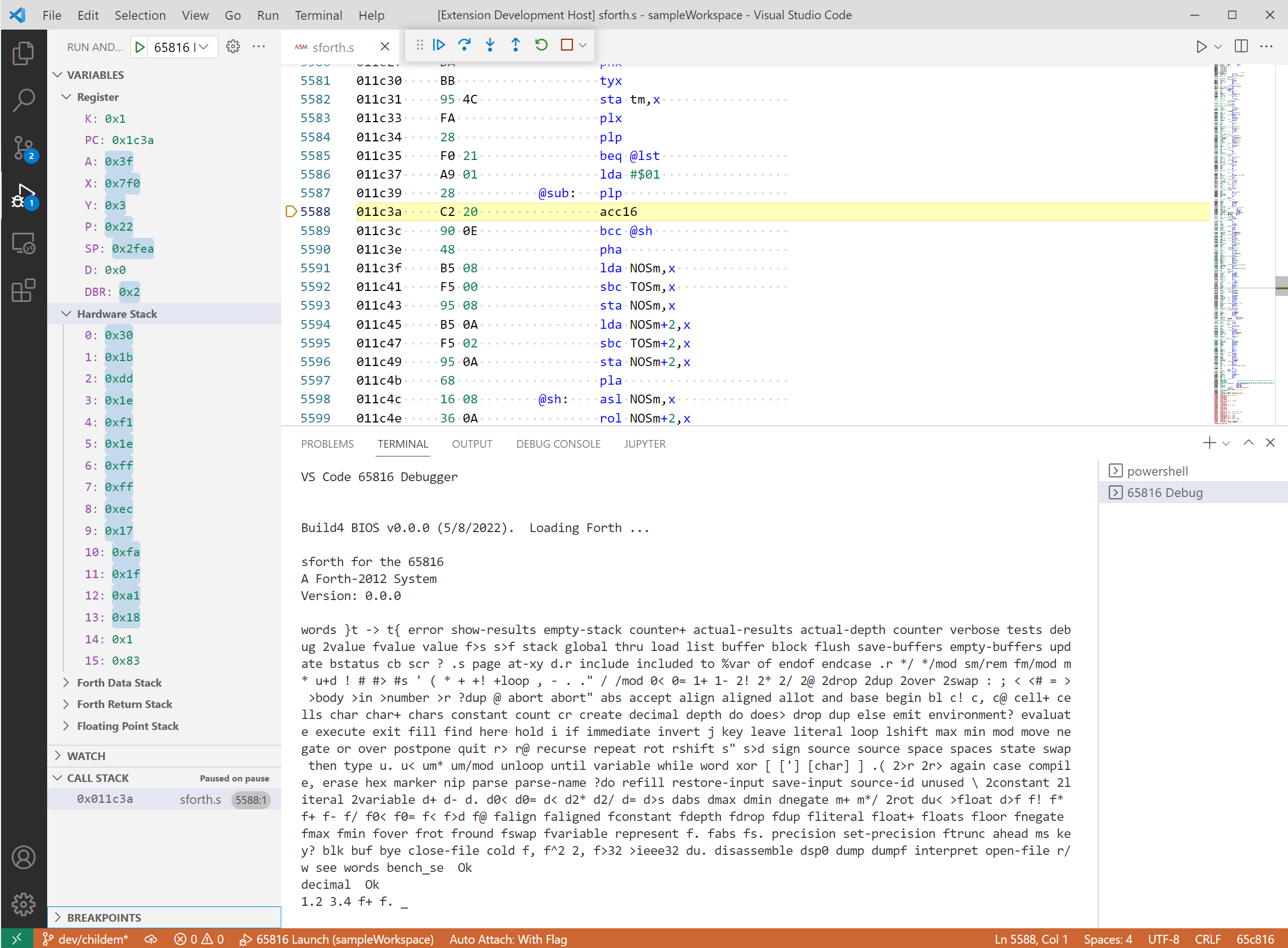

I decided to use a terminal window for my Typescript-based emulator as it's more suitable to my Forth operating system. Here it's doing some floating point math:
Developing a simulator is a large investment of effort, as you know. And, until it's 100% debugged, it has potential to actually hinder your progress (although of course at other times it will help).
This bit me in porting my Python-based 65816 emulator to Typescript. I was trying to improve my code during the port and thought that
    private isSet(x: number): boolean {
        return (this.p & x) === 0;
in Typescript was a better typed way of expressing
    def isSET(self, x):
        return self.p & x
in Python. It's not. It took me a bit of testing to track this bug down. Unfortunately, it would be too much effort to port the extensive unit tests I have for the Python emulator to Typescript. I'll just have to live with the uncertainty for now as the debugging experience in the Typescript version is much better than in the Python version.

I've updated my GitHub with my version of a VS Code 65816 simulator. It has the following features:
    * Runs a program from reset vector, optionally stopping on entry
    * Supports multi-file programs
    * Can set launch arguments for program
    * Follow along with execution directly in assembly source files
    * Control program execution with continue/pause, single step, step-into, step-over, step-out and run-to-cursor
    * Four types of breakpoints (conditional breakpoints not yet supported):
      * Source: set directly in assembly source files; stops execution when that line is reached
      * Function: set on function name or memory address; stops execution when that function is entered or memory address is reached during program execution
      * Data: set on X, Y, K, B and D register; stops execution when a write access to these registers is made
      * Instruction mnemonic or opcode (opcode allows a break even if there is no supporting source code)
    * Registers and hardware stack displayed in Variables pane and can be modified when program is paused
    * Watch pane functional for program symbols and memory addresses (not expressions) and the values of these can be changed when the program is paused
    * Variable/watch changes highlighted after each step and on execution pause
    * Drill down on variables/watches that represent a memory range (variable ranges can be opened in a separate hex editor window allowing modification of the memory range)
    * Symbol address and value displayed when hovering over a symbol in source code
    * Call stack displayed when stepping through program. Clicking on an entry opens the source code in an editor at that line. On continue, call stack collapses stack to current instruction.
    * Integrated terminal window for input/output with default read/write addresses at $f004 and $f001 respectively.
    * Source files listed in debug pane Loaded Scripts Explorer
The simulator runs as a VS Code extension and uses CC65 assembler source and listing files, along with the map and symbol files from the linker. I've included a "hello world" example if you'd like to try it out without bothering with CC65.
