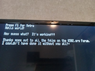

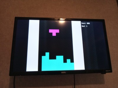

leepivonka, thank you thank you thank you! Hot dog, it works! See attached pictures :) Wow, I *really* had a fundamental misunderstanding there. Thank you for seeing that, so awesome to see it doing complex functions now! If I saw you in person I'd hug you! :D
This is what I inserted:
LDA #$03
PHA
PLB
And so the next (and last) thing I want to get rolling right now is the keyboard. And it's not working, probably because the interrupts are doing something very similar. The keyboard works for my fallback monitor, but not in my new demo code, probably for the same reasons: a register is not set correctly. Will be continuing to work on that. Once the keyboard is functioning then I can start to rest, or perhaps just push harder :)
Thank you again leepivonka!
Chad

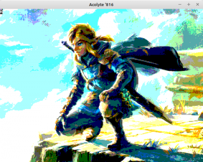

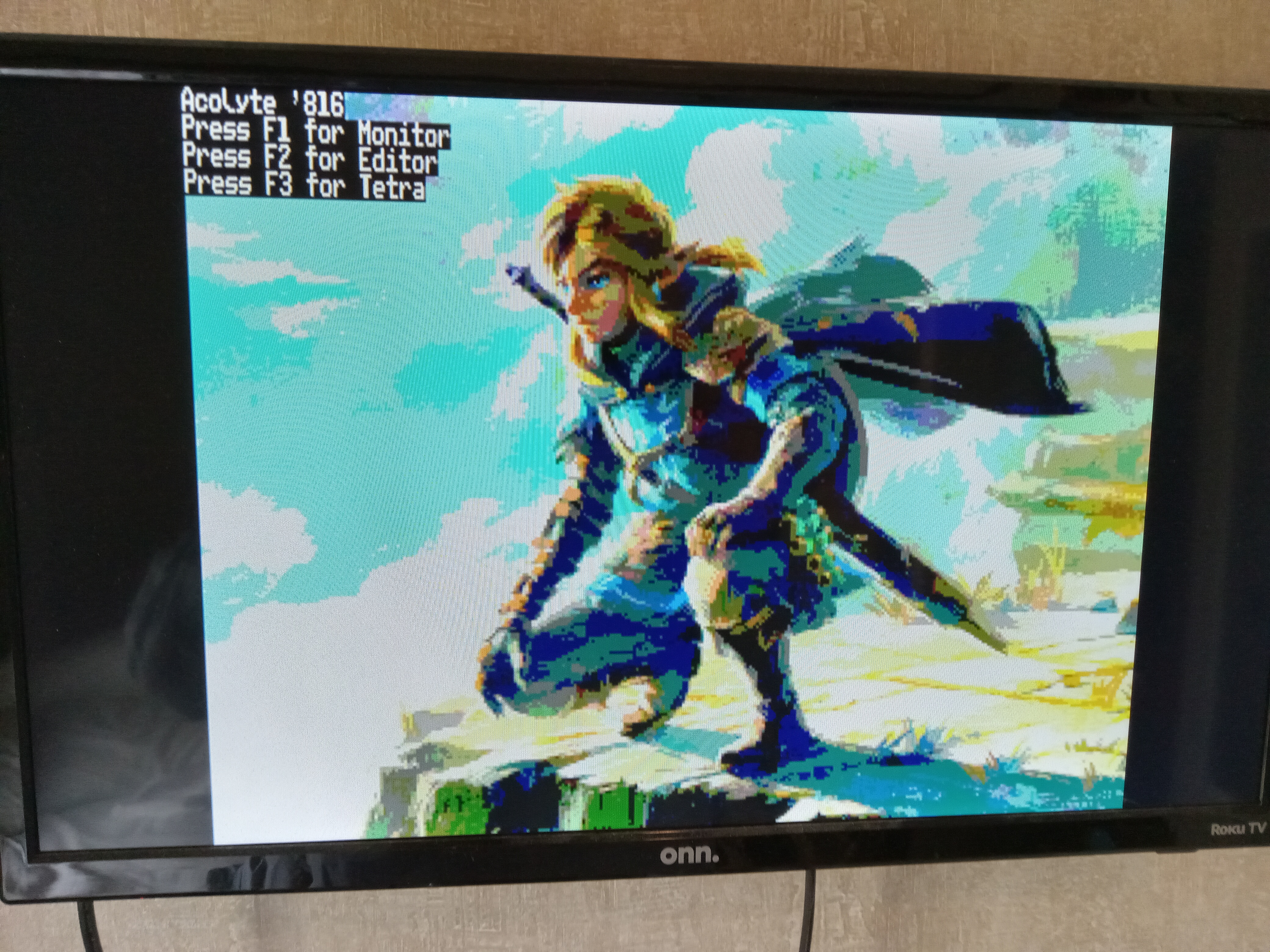

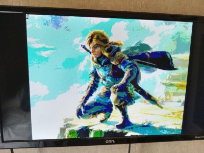

Whelp, that was fast! Keyboard is now working (mostly) as expected, yay! I just changed the addresses in my ISR from absolute to absolute-long, and copied my fallback monitor VIA code into the demo code. BAM, that did it!
So many more hardware things to get working. The keyboard isn't great for Tetra right now, but that's all software. After that is the vertical scrolling and then getting my latest demo code with the editor to work.
After all that I want to try to get the PIC to speed up it's reading from the SD card. It currently takes about 1.5 minutes to load 128KB from the SD card. That's a LONG time. Some things I'm considering is speeding up the PIC from 4 MHz to 8 MHz, and perhaps running PIC assembly code directly rather than through a C compiler. I'm super scared to even *touch* the darned thing since I've been fighting with it for a week now. I'm happy it's working but golly what a ride!
Y'all have been seeing a whole bunch of Link today :) I guess it's that or the Gouldian Finch, should probably try that too soon. Just wanted to show off those colors! I'm really contemplating doing the little color change George suggested, that sounds like it would be really neat.
Again, thank you all for your help and support. I really couldn't have done this without y'all. This is YOUR victory too! :D
Will update more, later.
Chad

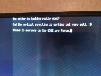

More updates! Included are some pictures and my PIC code, my Demo code, and my Verilog code.
This morning I worked on vertical scrolling. Golly I had some misunderstandings there too it seems! I was able to fit vertical scrolling for *text* in the CPLD, but I couldn't do it pixel by pixel as of now. Though, that's good enough for now I suppose.
Then I wanted all of my latest demo code to work, but I ran into trouble. Did you know that the '816 has "reserved" spaces in $FFE0-$FFE3 and $FFF0-$FFF3 which are completely unused? What a perfect spot to stick some random variables to squeeze my bootloader code in even more. WRONG! Those little buggers cost me some hours. As soon as I got the code out of there, everything was fine again. Now you know!
Last thing, George and I were talking last night and he mentioned some places where I could optimize my SD card code on the PIC. I did that and doubled the PIC's internal clock speed, and it now loads 128KB in about 30 seconds! That's a third of the time from before! Thank you again George, super awesome upgrades.
What I would really like to do next is somehow fix my bodges more properly. One of the pins on a SMD chip broke off, and it has been *very* difficult resoldering the darned thing three times now. I think my plan is to pull the chip off the board, solder it down entirely, and then just scrap some traces and maybe run a few bodges on non-lifted pins. I'd also like to add a blinky 'loading LED', something that blinks while I'm waiting for it to load. The way I have it set up, the CPLD can only display a black screen while the PIC is spoon-feeding the '816, so having something say "hey, it's ok, I'm working on it" would be nice. I have a spare pin on the PIC for this, but trying to add it somewhere on this board would be physically difficult.
Alright, now I gotta do real-world work again. But at least now I can demo this board to our Math and Engineering Club. Thank you again everyone! :)
Chad
