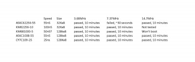

I decided to take another look at AS6C62256. I have a barebone 6502 SBC in pc board which should be more reproducible in case of errors. I do have to make small modification to accommodate 32Kx8 RAM. AS6C62256 is rated 55nS, so it should work with 7.37MHz W65C02, but it doesn't! It will fail memory diagnostic intermittently after 100 or so passes (about 30-seconds run), but it will pass diagnostic at 3.68MHz even after 10-minute run . It turns out it is fast enough to run 14.7MHz and will also pass diagnostic after 10-minute run. I have KM62256-10 that passed the same diagnostic at 3.68MHz and 7.37MHz. It is not fast enough to run 14.7MHz.
I've tried several different 128Kx8 RAM and they all passed. Table summarizes the various tests. The outlier is AS6C62256 failed at 7.37MHz but mysteriously passed at 3.68MHz and 14.7MHz. This is quite a mystery!
Curiously, in my Ruby '816 system I'm using the AS6C4008-55, so 55nS. I was hoping it would be stable at 8Mhz while I soldered up some SMT chips on carriers, but to my surprise it was solid right up to 16Mhz. (and down to 1Mhz too). I've tried 4 different ones of the same type and all have worked perfectly.
There may well be something odd about them, but they're good for me.
PostPosted: Fri Jan 19, 2024 11:57 pm
Posts: 1080
This is quite a mystery![/attachment]
OK, I can explain it.
The board was designed for 32-pin 128Kx8 or 64Kx8 RAM, so pin 30 is chip_select_high which is jumper-able to either PHI2 clock for 6502 or ~RESET for Z80 configuration. For 28-pin 32Kx8 AS6C62256 and KM62256, that's a power pin. When modifying the socket to accommodate 62256, I brought power to it through the jumper block which is over 1" of 7mil trace and not bypassed with 0.1uF cap. That is the problem. Once I jumpered with shorter wire and bypass the RAM, it (AS6C62256) passed 20 minutes of memory diagnostic.
The fact remains that AS6C62256 needs more stable power that is properly bypassed. The other 32Kx8 RAM, KM62256, was able to run correctly with previously poorly bypassed power.

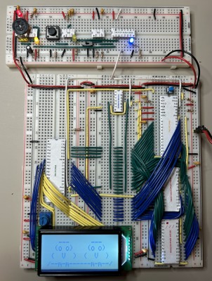

after a bunch of exploration, more power grid, more caps, not to mention a toll of magic smoke :cry: i've discovered a secret about this unreliable memory!
see if you can spot the difference between the two pictures...
:oops:
:oops:
:oops:
:oops:
:oops:
what do you know, the RAM works more reliably if VCC is actually connected to +5V rather than thin air! I can only imagine how it was working at all before, perhaps stealing power from the addr/data pins?! (fwiw, also works happily with a 1MHz crystal)

Good, I'm glad you have it resolved. AS6C62256 is not to blame, but I do believe it has more stringent power regulation needs.
It is amazing how a CMOS part can work without its power hooked up. I have a Z180 design with completely missing power pin due to a library error. I build several boards, tested and delivered; never even realized Z180's power pin is not hooked up. I talked to the user years later, he never had problems; CP/M ran just fine, he took it to several shows; worked great!!
PostPosted: Sat Jan 20, 2024 6:25 am
Posts: 703
This is to be expected with CMOS parts because of the default diode from all inputs to the substrate. It's one you don't think of, but if the input can supply enough power (think a 4mA output connected to an 'unpowered' input on a chip that needs a handful of microamps) then the part will cheerfully operate. The Vcc will be ~0.6v low, but CMOS often doesn't care about that, though a 3v3 system might be fussier than a 5v system, and of course once on chip is powered, they all are...
It's often the case that a serial input (idling high) will power an entire processor even though it thinks it's turned off; at the very least it will interfere with power-on-reset on the chip. Particularly when you're designing the system to use only a few microamps most of the time, a serial connection for e.g. debugging can ruin your whole day.
