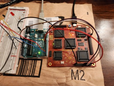

Hi Everyone,
So I finally had some time today to dig back into this. As a reminder, I am trying to get Daryl's Text Video Display to run on an Atmega328p (i.e. Arduino Uno). I replaced all of the rjmp instructions with jmp as Daryl suggested, and of course changed the io header from m88PAdef.inc to m328Pdef.inc.
I am now getting the "Banner" and was even able to modify the banner to read 328p instead of 88. So I know things are working on the Arduino side. I then connected the Arduino to the VIA Port B of my W65C02SXB board as explained in the wiring diagram. I first call VInitDisp to initialize the display and try to output some characters using VOutput. I can clear the screen but am unable to output any characters to the screen. The cursor sits there and blinks, but no characters are displayed. I am using the exact 6502 code from Daryl's website, just with my VIA memory location starting at 7FC0.
I have the reset line on the SXB connected to the reset line on the Arduino. When I reset the SXB, it resets the Arduino and Daryl's banner display's. When I try to run my 6502 code to send text to the Arduino, I get nothing. The clock on my board is just under 2MHZ (WDC released some boards with the incorrect clock). I saw in a previous post from Daryl that the system has a 4MHZ limit.
I really like the way the text looks. Very sharp and truly 40 by 25 characters. I just can't get the interface to work. I think this would be a great solution for adding video out to any 6502/65816 system.
I know the 6551 has some bugs. Does the 6522 have any issues? The via shift register is being used to communicate with the Arduino.
Could an additional delay be needed somewhere in the code?
I'm scratching my head on this one. Any advice???

Daryl,
Currently, I only get 0 on bit 7 when reading PORTB. After the banner appears, after calling VInitDisp, and after calling VOutput. I always get 0 on bit 7.
As for the W65C02SXB side, I am using the user VIA. This is VIA1 on the board. I am using 3 pins on the VIA. PORTB pin 7, and PORTB CB1 and CB2. I am fairly certain I have these connections correct. The attached photo shows the setup.
On the Arduino (Atmega328P), I am using digital pins 13 (PORTB pin 5), 11 (PORTB pin 3), and 9 (PORTB pin1). Pin 13 is connected to CB1, pin 11 is connected to CB2, and pin 9 is connected to the VIA PortB pin 7.
Is it possible to test in isolation on each side. For the Arduino, how could I set up something like a chrout (character out) function in the AVR code so I could for example load a register, call the function, and have it appear on the screen. This might come in handy for troubleshooting.
On the 6502/6522 side, I have never used the shift register on the 6522 before. Is there some simple test I could run in isolation to demonstrate that the 6522 setup is correct.
Finally, the setup seems very similar to SPI. I have a good SPI setup on my board. Does the AVR code already support using SPI? I have connected arduino's as an SPI slave to my SXB many times. I know I can get this to work.
Thanks again for your help. Hope we can get this figured out.

To test just the Arduino, can you put an LED with resistor to ground on the Port B pin 1 to see if it is set high?
Per the AVR code, PB1 gets set high upon initialization and will toggle after each shift in is completed.
Next, set up an SPI port to feed one byte to the Arduino using PB3 & PB5 (MOSI,SCLK). it looks like I have the Arduino set for Slave mode and mode 3 SPI.
Feed $0C to the Arduino and verify the screen clears and the PB1 output changes to 0.
To test the W65C02SXB, it will be a little harder. You can place a jumper on Port B bit 7 and move it from Vcc to gnd and read the port to ensure the input is following the value on the pin. Testing the serial out will be a little harder. You could try connecting it to an SPI slave set for mode 3 and send various values and read the SPI data register to ensure that is functioning.
Daryl

Daryl,
I connected PORTB pin 1 (Arduino DP9) to an LED. When the banner comes up on reset the LED lights and once the banner is completely loaded and the cursor starts to blink, the led turns off. I will try using SPI next and get back to you (probably need a chip select for SPI as well).
Thanks again.

Daryl,
Fantastic news. SPI works perfectly. Thank you so much for all of your help. This is awesome. I'm going to clean up some things and then post in detail exactly what we did so the next person can get this figured out a little easier.

I'm glad you have a working solution. However, if you are not using the handshake pin, there is a chance that you can send characters faster than the display is able to receive them, especially during scrolling. With using the SPI port, does the handshake line change state after each character is processed? I found the place in the code where the handshake pin is brought low as the last step before the main loop starts in the Arduino. Once the first character is received, the state will toggle high and then alternate after receipt of the following ones.
I cannot make sense of my 6502 VInitDisp code setting the V_idle variable to 0. It should be set to $80 as the VOutput routine first toggles its state before doing the comparison with the handshake pin. I don't have any hardware or time to rebuild this now, but if you do see the handshake line changing state, you might consider testing the VOutput code with the V_Idle variable initialized to $80.
Either way, I'm happy that you have a working display and can now move on to the next phase of your project!

Daryl,
So it looks like I got out ahead of my skis on this. You are correct, SPI works great until the screen scrolling routine on the AVR kicks in, then it's too fast. I tried setting the v_idle to $80, and this didn't work.
On the AVR, the first call to VOutput works, however, it seems that the AVR gets stuck in the VOutput1 loop, and the ack pin gets stuck on 1. It appears that the acknowledgement is not toggling. I noticed in the AVR code in the Main routine that there is a comment about the older Atmega8 needing some additional code. I wonder if the 328p might need something different.
Anyway, It seems that the handshake is definitely where the issue is. I'll keep digging and let you know. So close!

I assembled the stock code (modifying the interrupt table from rjmp to jmp) using a 328P definition and it looks like the code assembles properly, especially the code after main3 where the handshake gets updated after each character is received. it should work.
I don't use arduino's, is there something with the hardware setup or firmware that stays resident in the 328? (bootloader or something else?)
Can you write a quick test program to ensure the PB1 pin can be pulsed high and low and back to high? We could also modify the code to use another output pin for the handshake.
Daryl

Daryl,
PB1 does toggle after each character. I verified this by connecting it to an LED. I can check this now and create a wait in conjunction with the spi transfer. This fixes the problem with SPI being too fast during scrolling. So current status, everything works fine using SPI. The handshake works as expected and as far as I can tell everything on the AVR side works. I will continue to look into using the shift register on the VIA. For now, I'm happy to have SPI with the handshake working.
Thanks again for you help.
For anyone interested in this exchange, make sure you have a common ground between the master and the AVR. I think this was the cause of some of the initial trouble.
